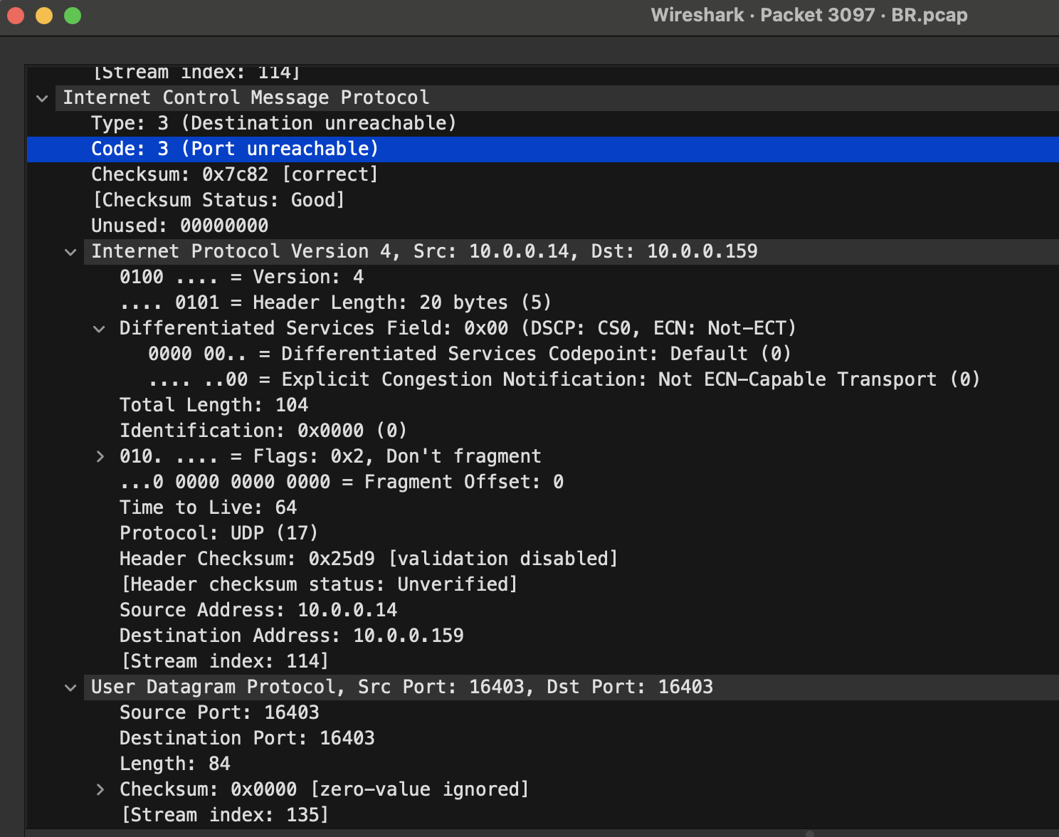

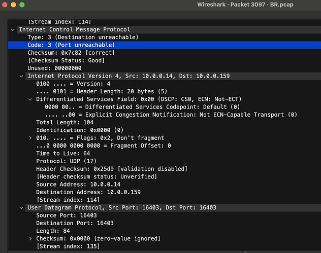

When none of that worked, it had me run a packet capture and analyze it in Wireshark, I found a bunch of “Destination Unreachable (Port Unavailable)” messages between my camera’s IP and my HomePod and iPhone. It’s analysis was:
" That Wireshark frame shows **ICMP Type 3 / Code 3 (Destination unreachable: Port unreachable)**coming from the camera’s IP back to your Home hub/device, and the embedded UDP header shows the hub trying to send to the camera on a high UDP port (e.g., 63790).
Translation: the Home hub is starting the SRTP stream, but the camera isn’t actually listening on the port it told HomeKit to use. That’s not a router “block”; that’s the camera refusing the port (no socket bound). So the stream negotiation is failing before any firewall would matter."
It’s only suggestions after that were to factory reset the cameras and re-do the pairing in both Apps, toggle Steam & Recording in Home to reset the ports being used, and change the camera’s codec which I can’t find a way to do.
Does ChatGPT’s analysis sound plausible?
