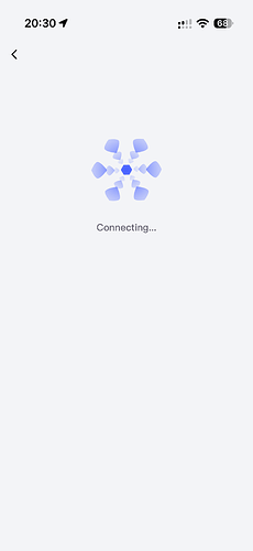

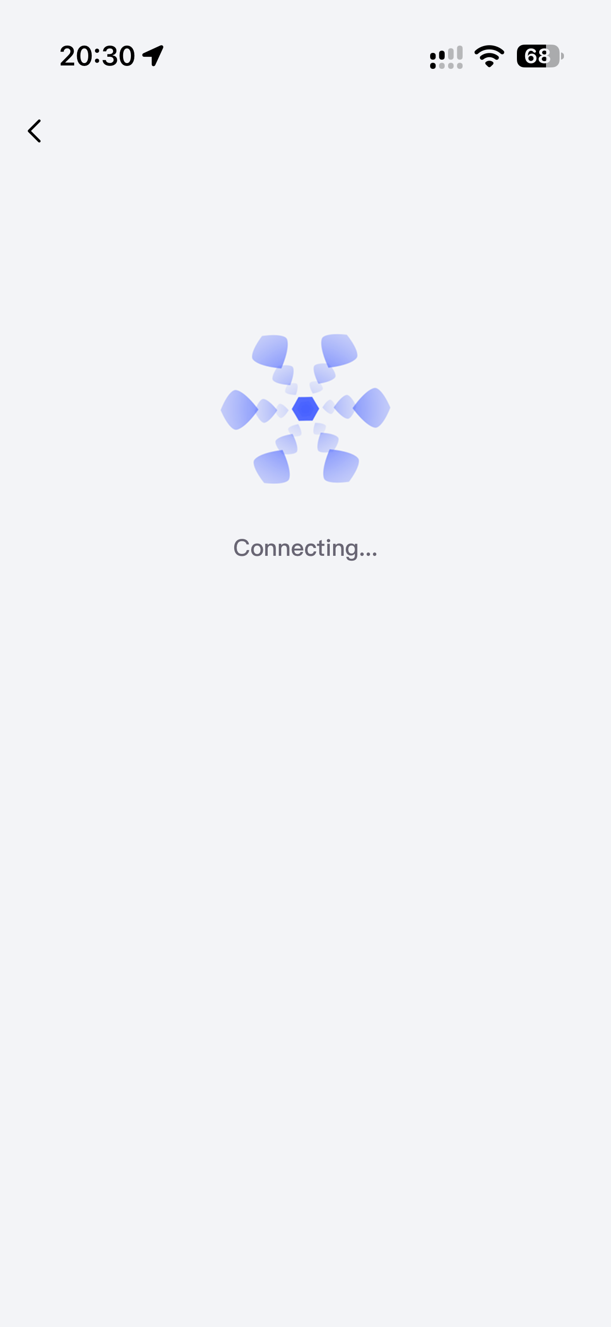

However, the final two, even though I’ve connected them to the same Ethernet cables as the two working ones, will not get past the endless “connecting” cycle on the Aqara app despite showing up in the app. It’s also visibly connected on my Deco app.

For context this is what I’m seeing.

Final bit with the main issue that I’m facing which is that last connecting screen that it doesn’t seem to move on from.
To close the loop, I managed to get it working but definitely through an unorthodox way. I connected both the G5 Camera and my iPhone to my router directly (using a USB-C to Ethernet cable) and somehow managed to get the two devices to talk to each other that way. I have a feeling the issue was in my iPhone’s connection to the wifi network (despite it working for the other cameras without issue).
