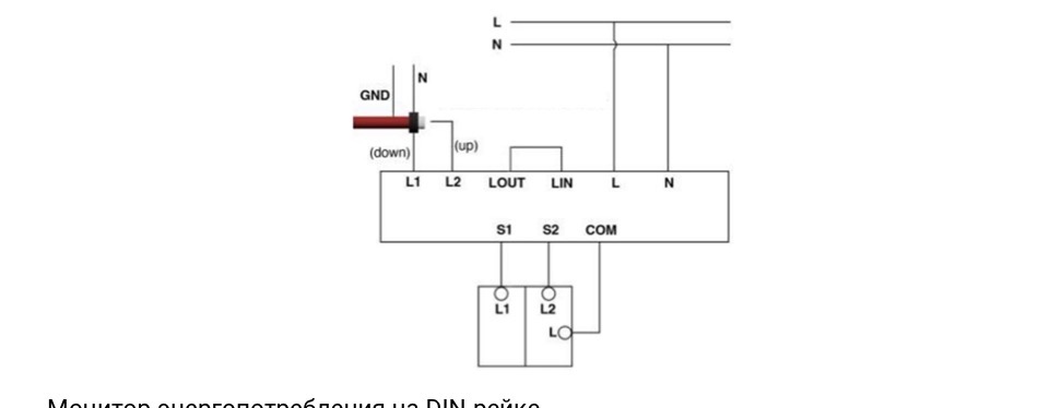

Took me a while to do this but I now have automated my garage roller door such that I can control via my phone OR through SIRI. Leveraged the M2 hub with a Aqara Smart Relay and Aqara matter window sensor. Works like a treat but took some searching to get the wiring right on the roller door. Anyone else tried this ?
Interlock
How did you get it to open/close the garage? Or, does it do this?
It Opens and closes. I connected the Aqara relay into the roller door controller box ….
Can create more details with photos and descriptions if required.

I have already done this from scratch about 10 months ago. Have integrated with HomeKit via Aqara hub and deployed scenes in HomeKit allowing SIRI to open and close the doors.
Also added in an Aqara sensor so I can check if the door state is Open OR Closed and generate alerts and reminders.
All works great. We have a guy who comes to mow our lawns and we can now go out for the day and when he calls open the garage remotely so he can get the mower.
