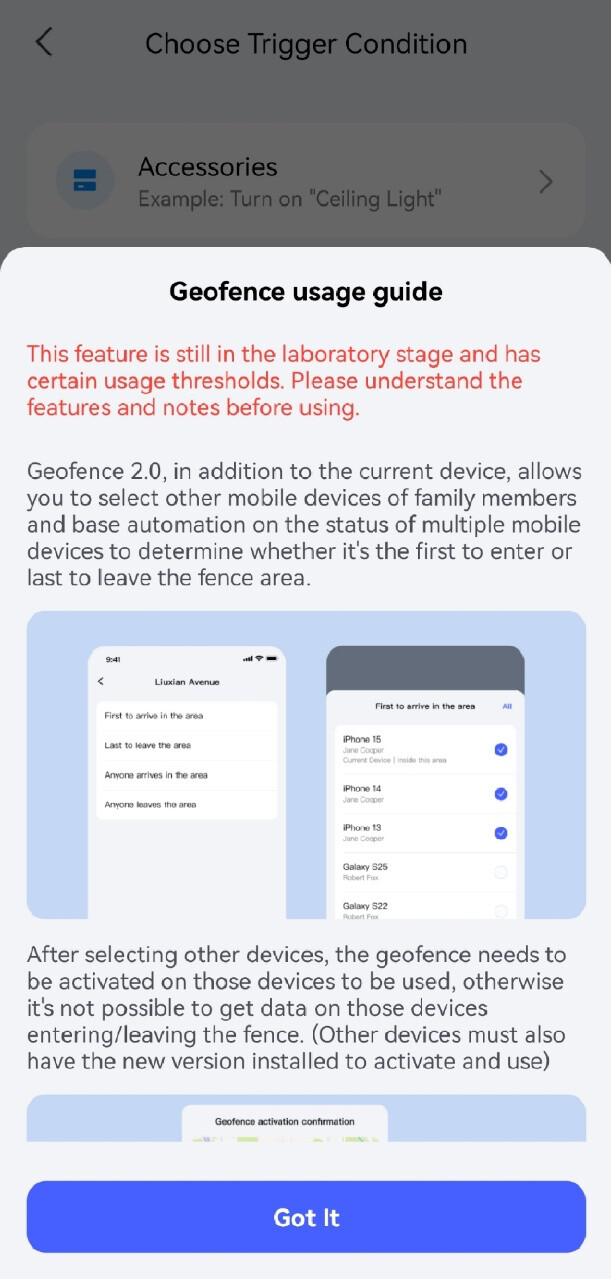

Hello, this feature is currently undergoing intensive testing. There is hope that (my assumption) this feature will be released with an updated version that will include automation 2.0.
When will this be ready?
This feature has been released with version 6.0. Update your app, enable Smart 2.0, and use the Geofence 2.0 functionality to create corresponding automations. Note that this feature is reportedly still in the laboratory phase.
