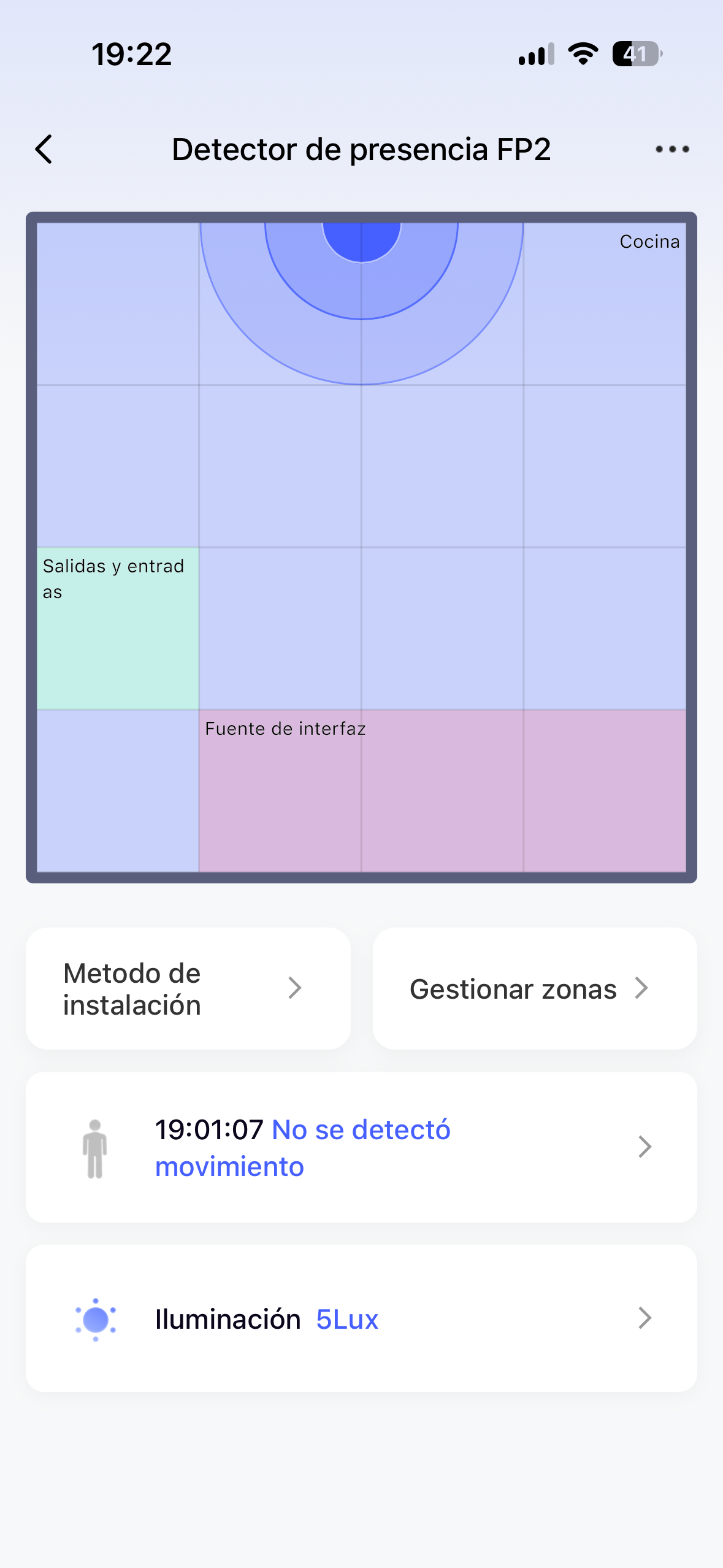

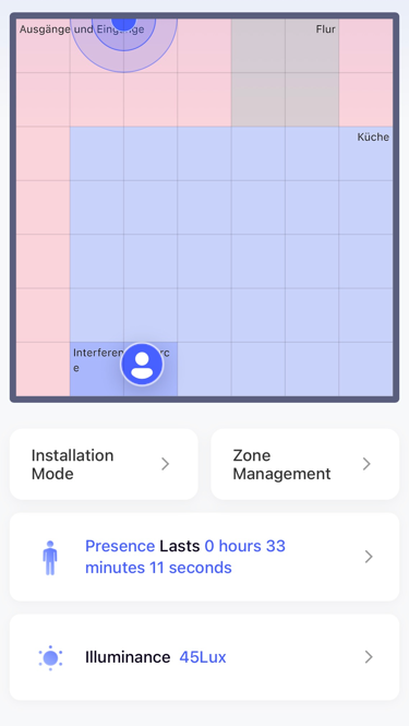

I’m currently having an issue with my Aqara Presence Sensor FP2 since the latest firmware update 1.3.6_0003.0099. It repeatedly detects a false presence, which keeps my kitchen lights turned on even when no one is in the area.
To make it worse, when I check the app (as you can see in the attached screenshot), the “ghost” presence is located directly inside an area configured as an Interference Zone. The sensor should be completely ignoring activity in those specific grids, but it’s triggering anyway.

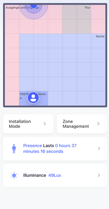

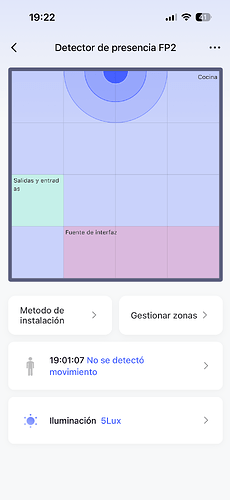

Well I had same issue till yesterday and aqara support told me to add walls on sides of the zone and use AI for better detection as I was seeing not one but two three ghosts in my kitchen and mine is small kitchen.last night I remade the holo zone with walls and added a few more things into the zona space were I knew that I have the door or some furniture this way the sensor will detect better and so far works perfectly.here is my zona made for the kitchen
Thanks for sharing that with me, that’s a really good tip! I’ll set mine up the same way.
Great for me as of now works perfectly and I didn’t notice ghosts so far.but do it the same way and try it for a few days and see how it goes.i am using it with the led strip t1

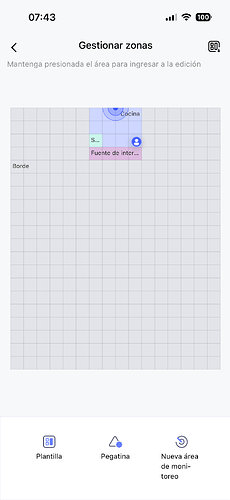

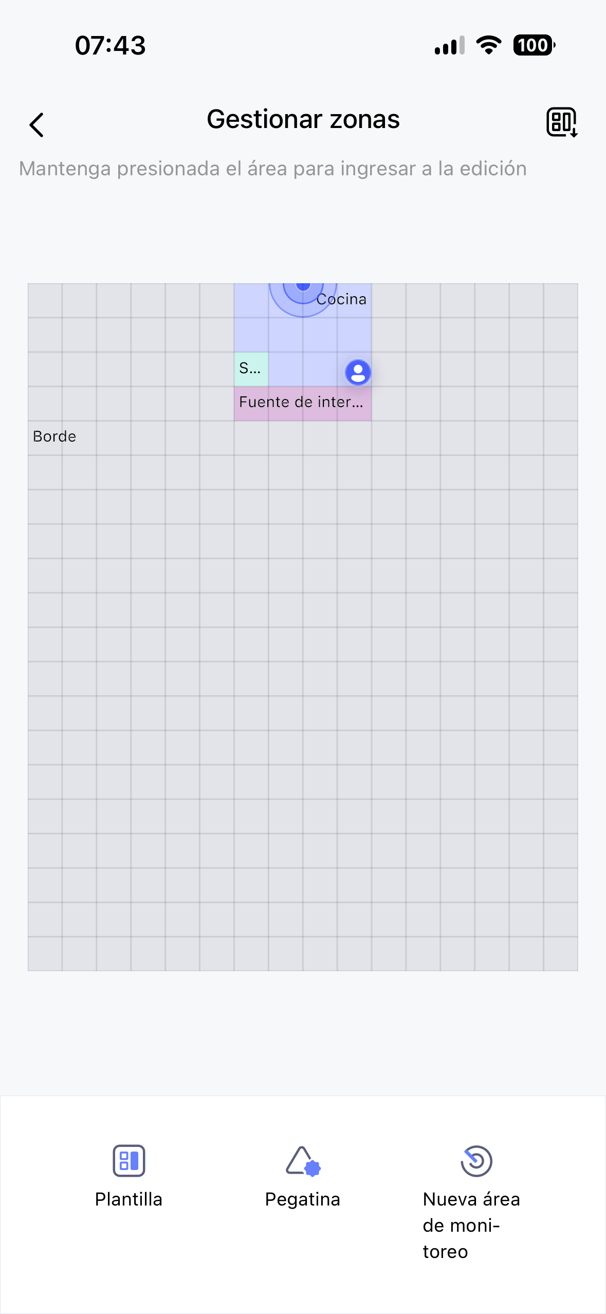

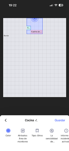

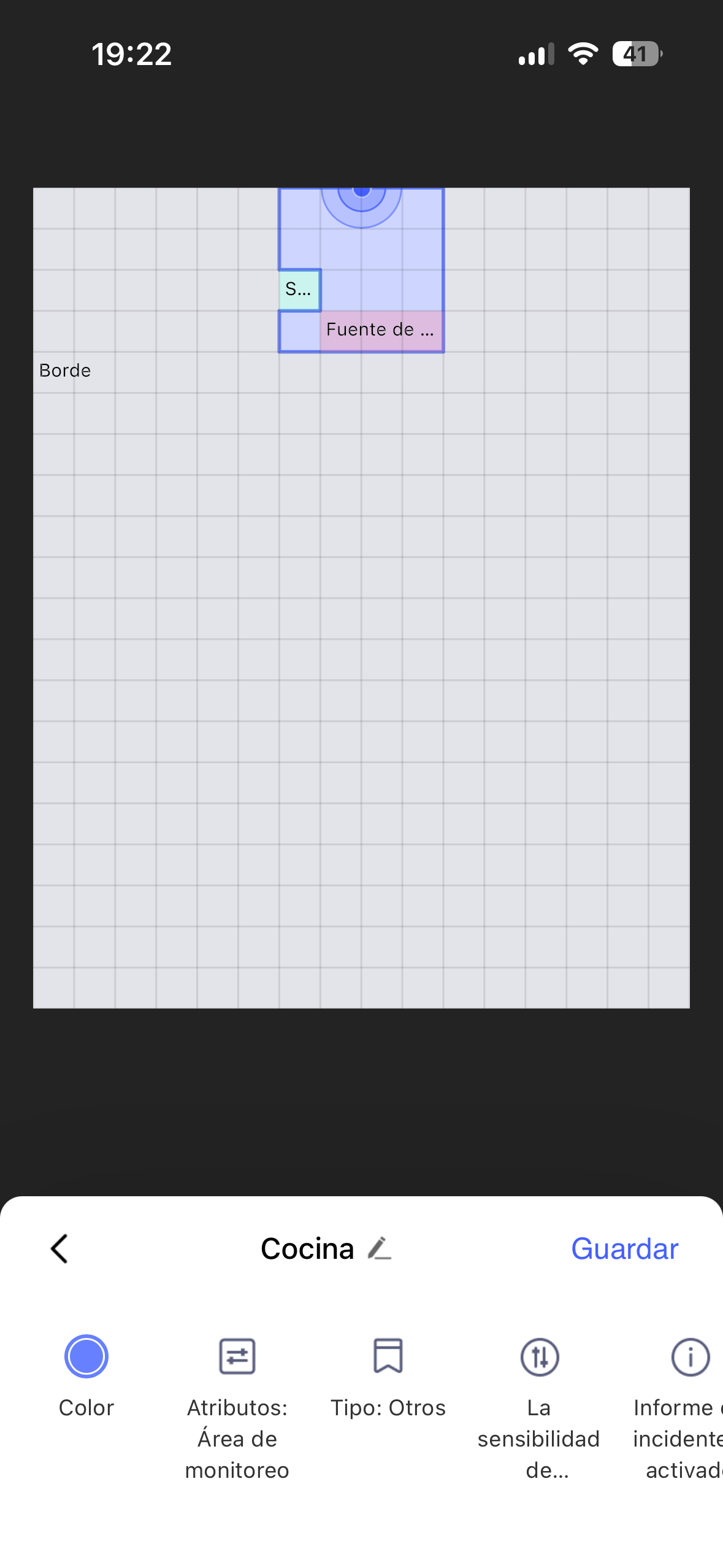

how do you add these walls ?, i have this configuration:
You already have the walls the grey sides are the walls

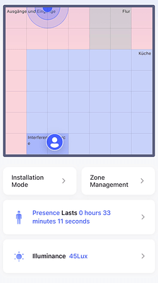

I haven’t touched the map in a long time, so I’m still figuring it out again. To edit the walls, simply long-press the gray area. Overall, changing the interference zones to walls has definitely made things better.
