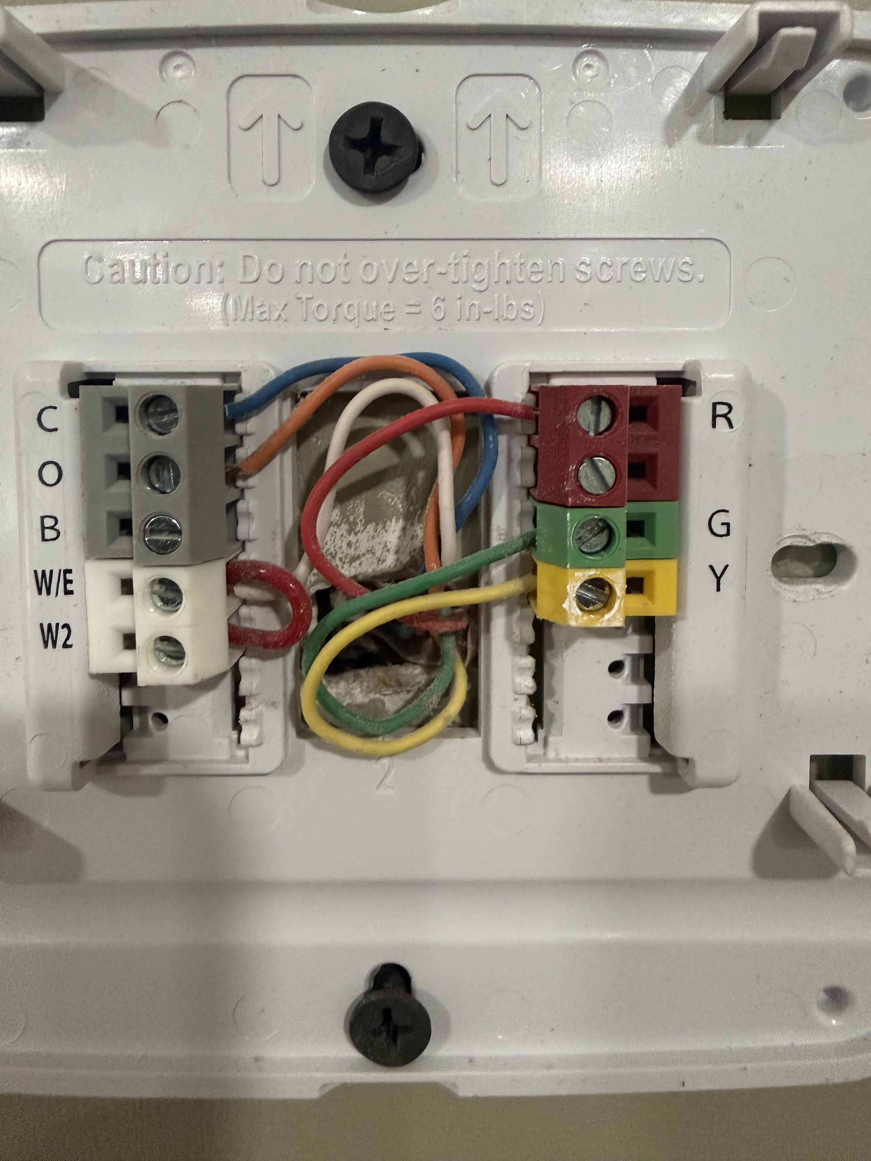

Have tried to hook up the w200 and not having any luck. The HVAC fan blows, but there’s no cold air coming out of the vents. The screenshot is how I had the w200 wired.

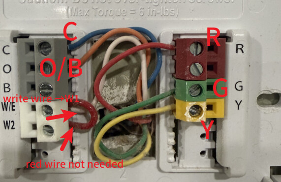

As shown in the figure, connect the white wire to terminal W1 on the W200; the red U-shaped jumper wire is not required.
