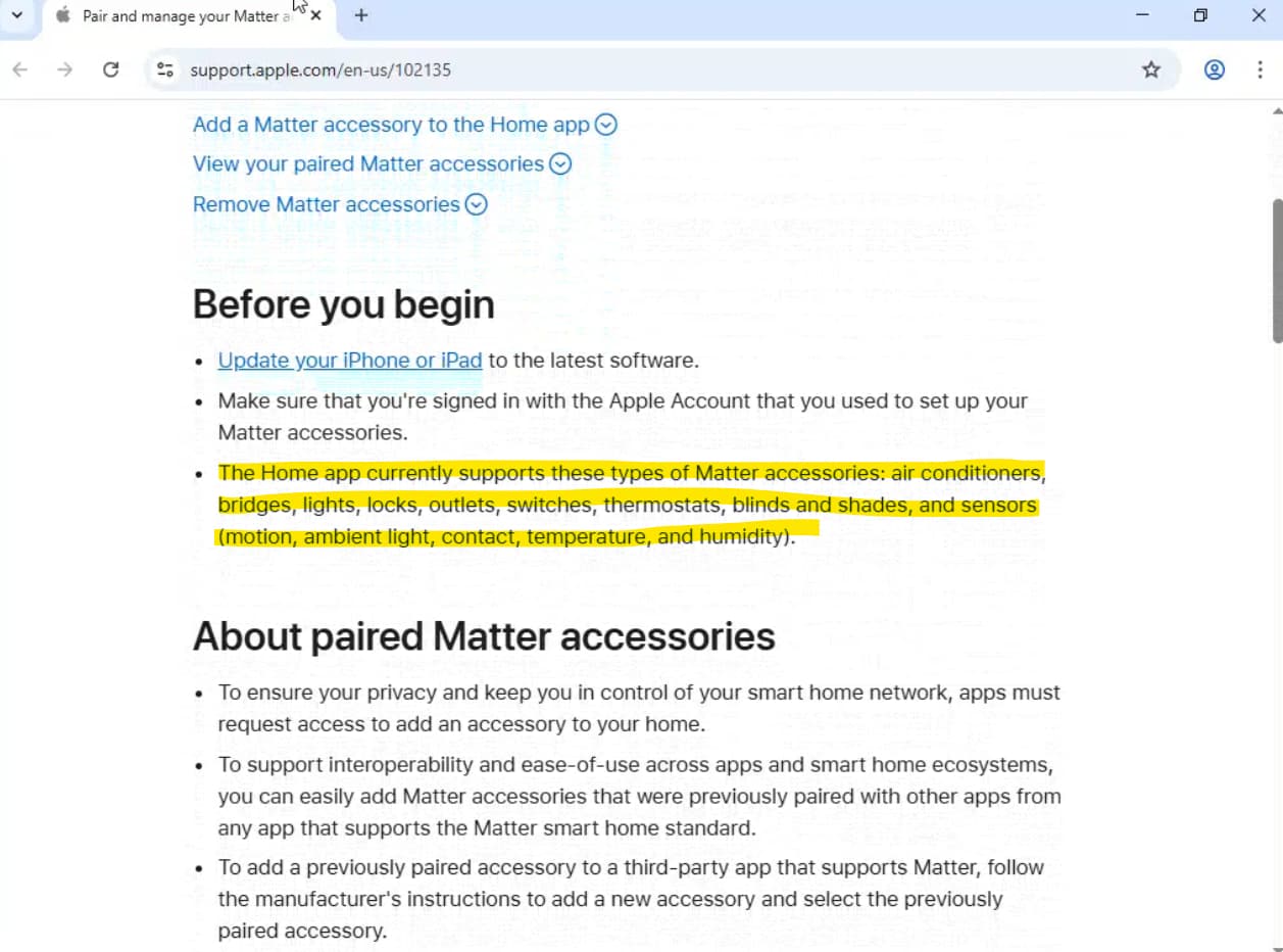

I’m not entirely sure whether Apple Home supports fans (Matter device type 43 / 0x002B). They aren’t listed on Apple’s support page.
Source: Pair and manage your Matter accessories - Apple Support

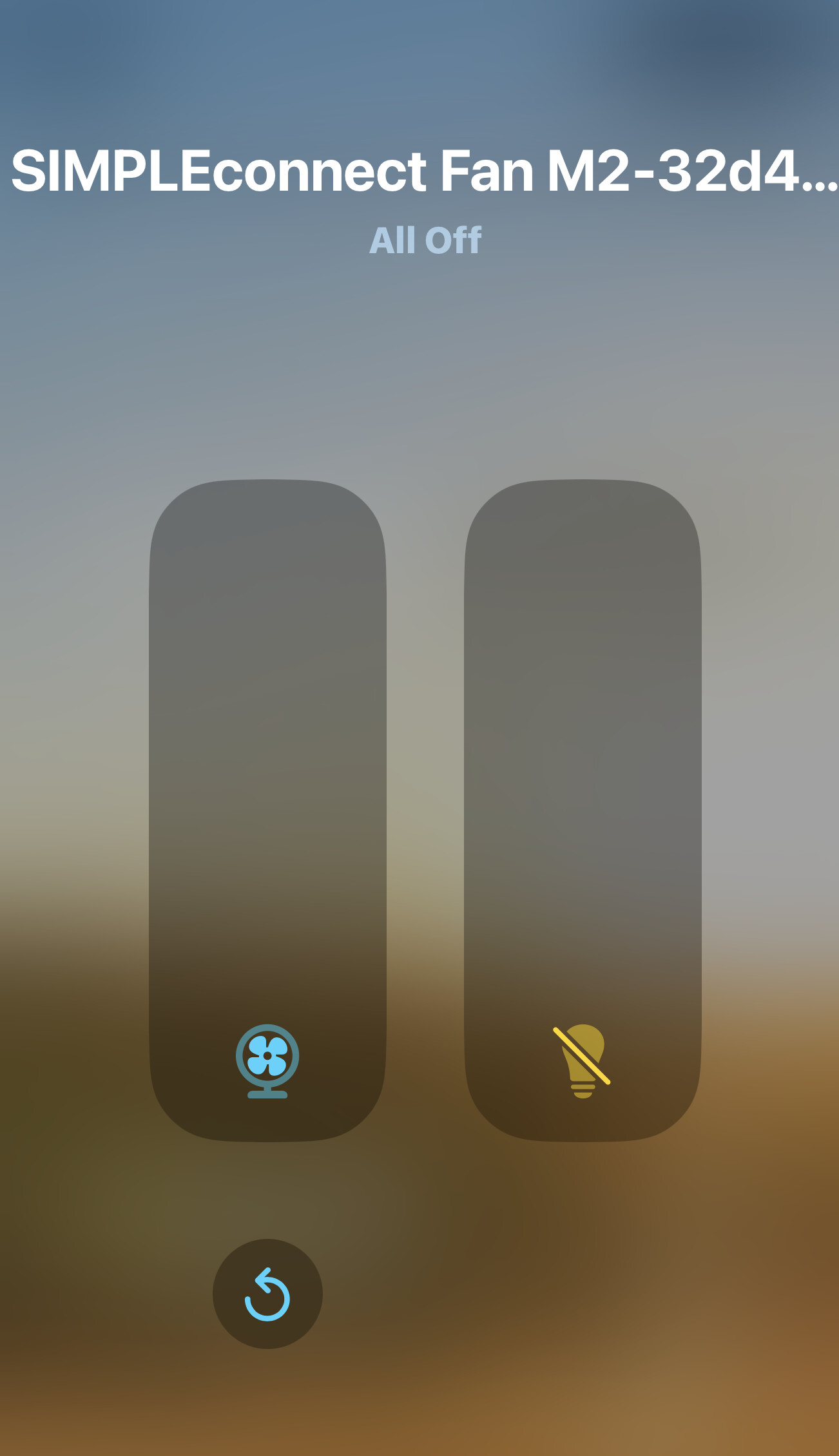

In our master bedroom we have a Hunter Aerodyne that works great in Apple natively.
Yes, it will work via the HomeKit protocol, but probably not via Matter. The Govee device you linked to supports Matter, but not HomeKit.
