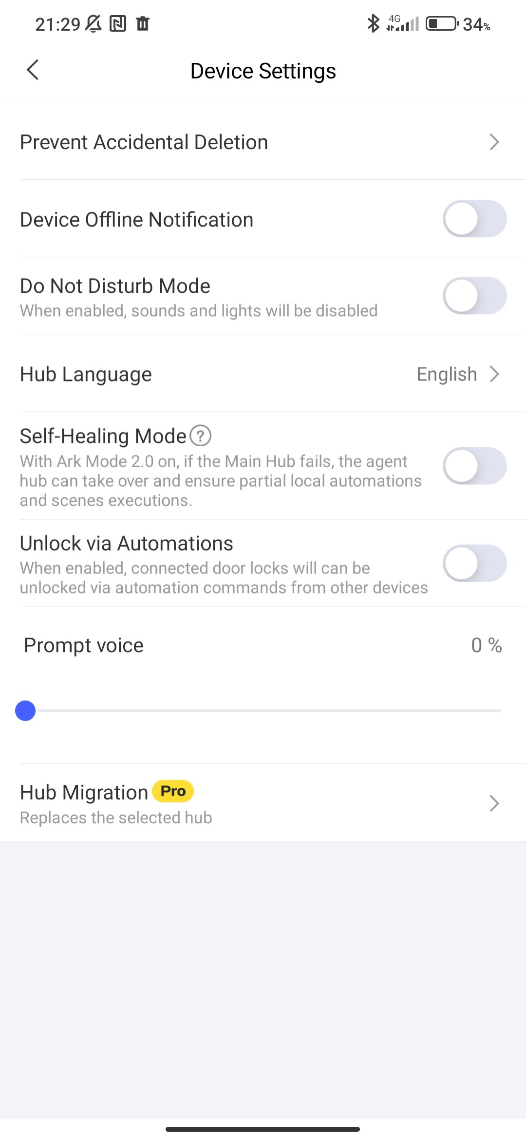

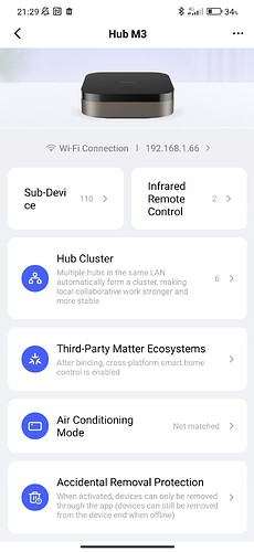

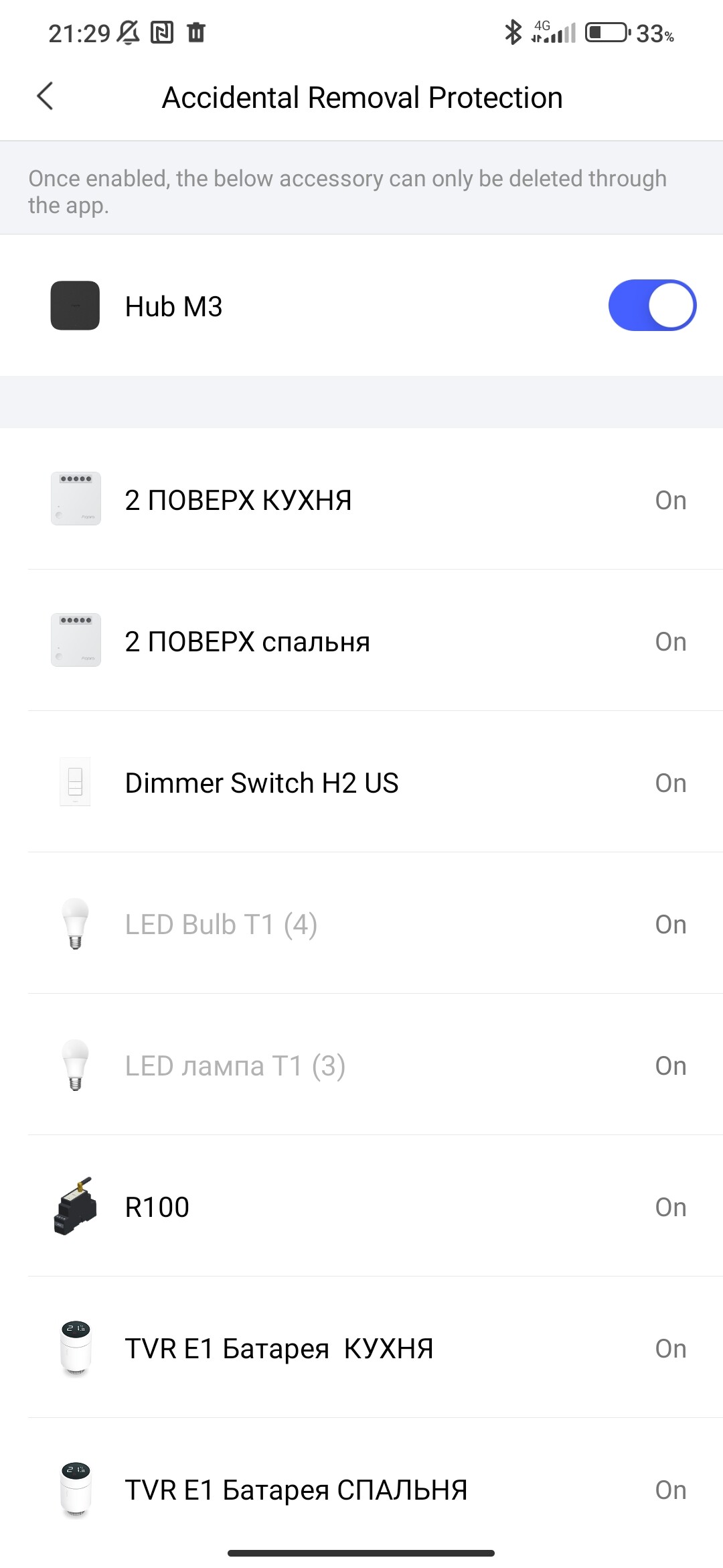

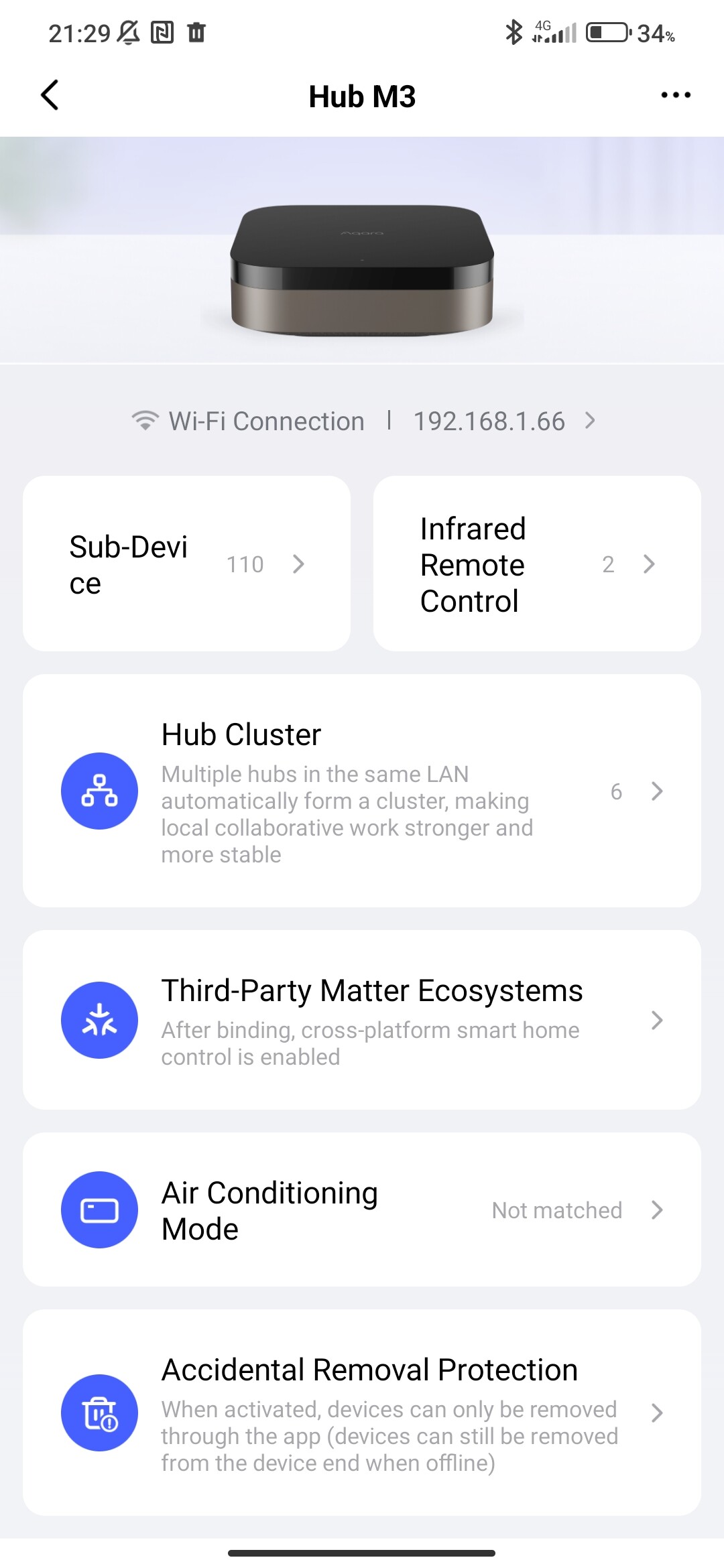

Alternatively, to prevent your bulbs from being disconnected, enable “prohibition of removing devices” in the Aqara home app.
This way, at least one of your problems will be solved.

Thank you for a brief response. I turned on the protection on both of my M3 hubs and yes, it at least prevented the accessory to be unconsciously removed.
