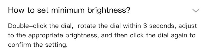

For adjusting minimum brightness, the H2 dimmer does allow setting this directly on the device: double-click the dial, rotate within 3 seconds to your desired minimum level, then click the dial again to confirm. This might explain why the rotary switch lets you go lower—you might have already set a lower minimum there.

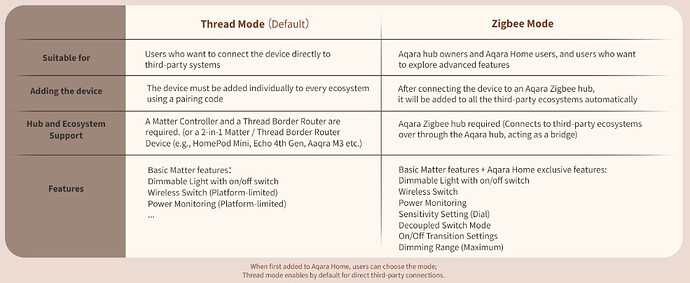

  • Are you running the device in Thread or Zigbee mode? (Thread is usually the default for direct third-party connections).
  • If you are using Zigbee, how is it integrated into HA? Are you using Zigbee2MQTT, ZHA, or are you connecting via an Aqara Matter Bridge (like the Hub M3)?
As shown in the comparison table below (from the Aqara product page), there is a significant difference in the available feature set. In Thread Mode, many advanced settings—specifically the Dimming Range / Minimum Brightness—are often limited or not fully exposed to third-party platforms like HA.

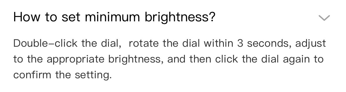

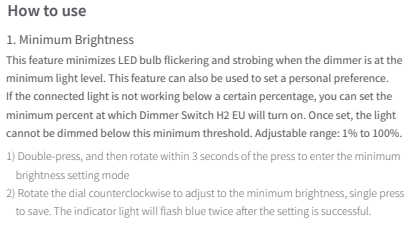

Also, have you already tried the hardware-level calibration for the minimum brightness? According to the manual (see image below), you can set this directly on the device by double-pressing the dial and rotating it to your preferred minimum level within 3 seconds. This might help the hardware better understand the limits of your specific LEDs, which could potentially resolve the discrepancy you’re seeing in the app.
Hi, did you tried this already to set the minimum light ?
