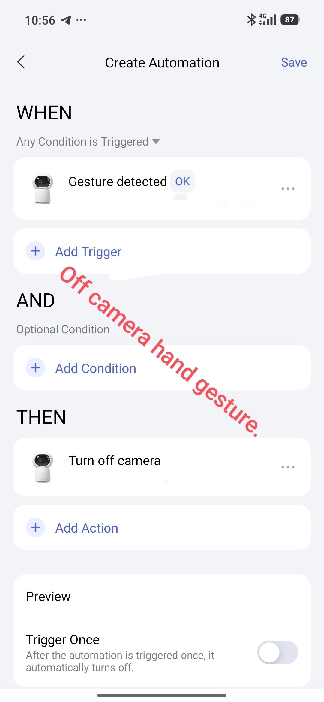

Hi, welcome to the forum. Show me the automations you’ve created, screen.
The peculiarity of geolocation lies in the high-quality cellular network.

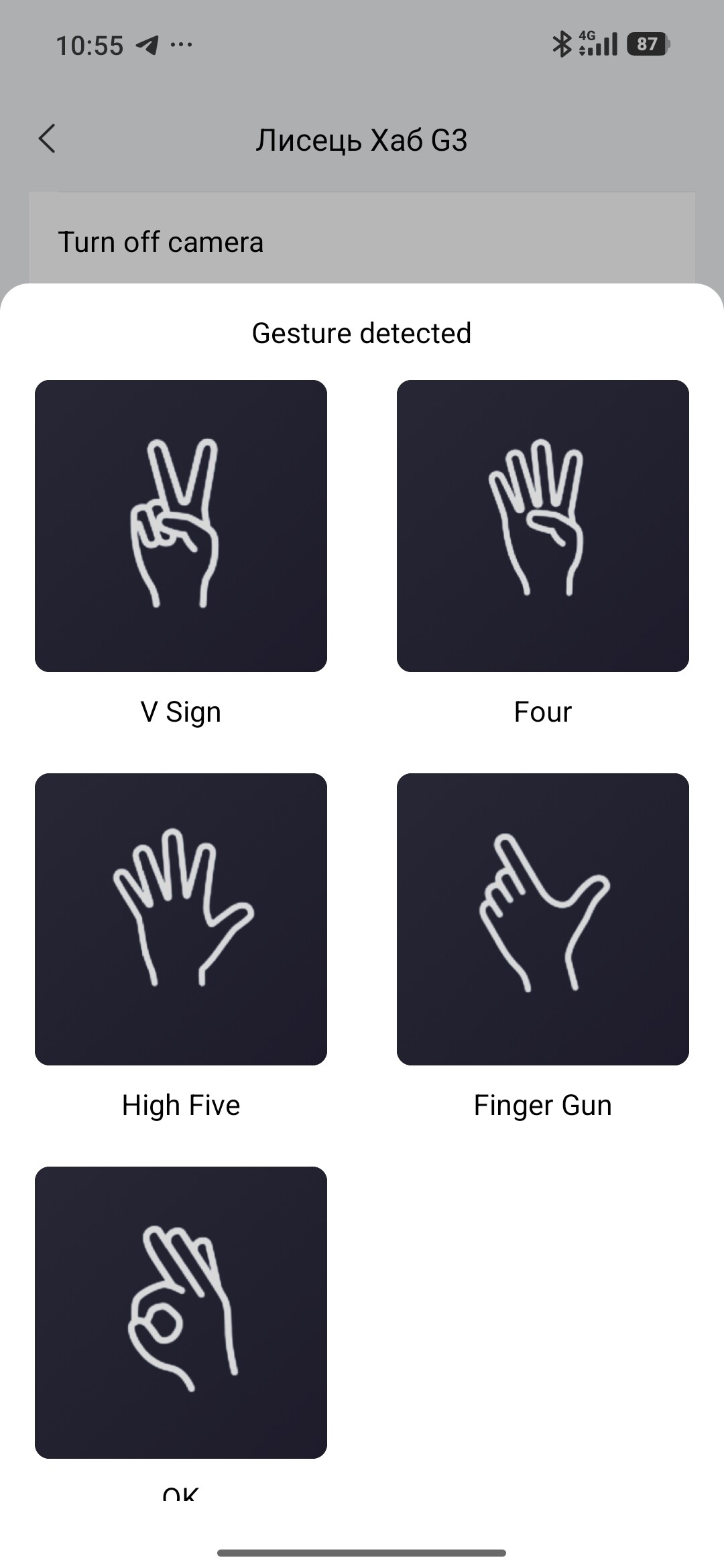

I suggest using two options. Off with a hand gesture. Fig.

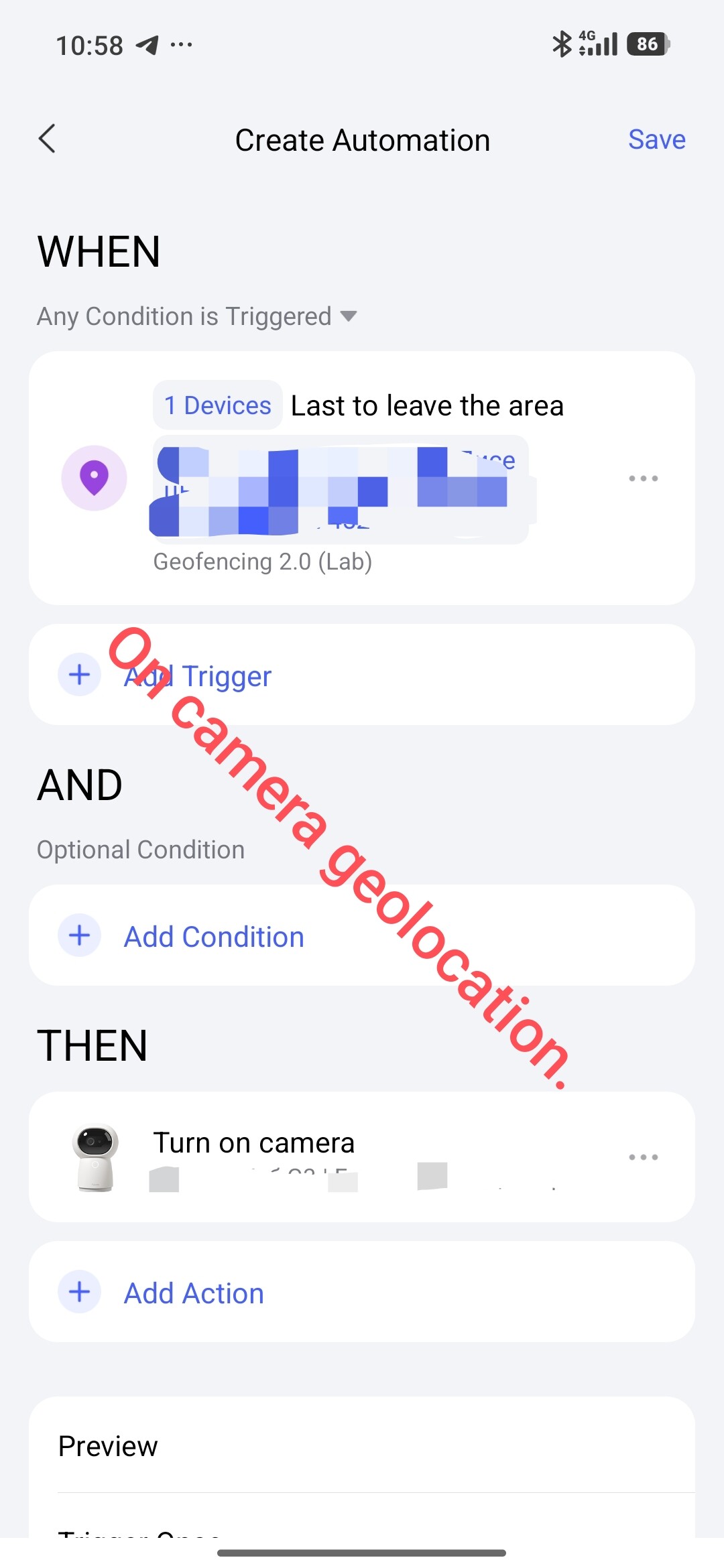

On using geolocation, left the area.
Fig. 2
I use it like this because of poor mobile network coverage.
My issue is that I can’t find gesture as trigger condition, but I am going to try using “I’m home” as a voice control to disable the camera
You have to turn on “Gesture Detection” under “AI Detection” in the device settings.

By the way, it sometimes also helps to increase the geofence area using a two-finger pinch, like when zooming out.
