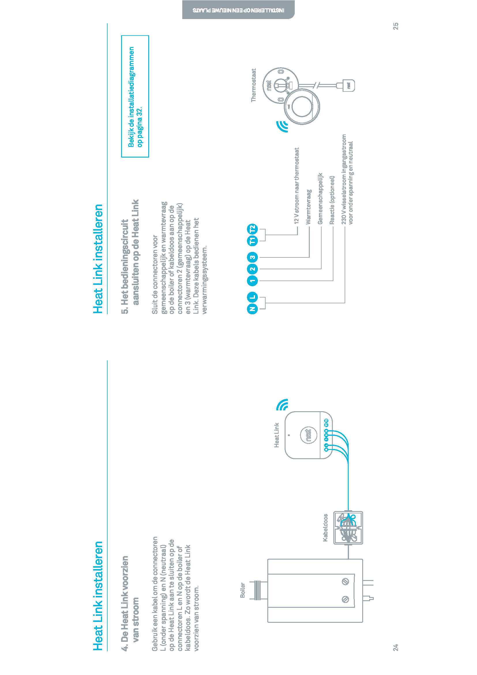

Hi thanks for the answer, i have looked in to the W500 and i saw it will not work as it has not a real on/off mode on the NTC, for me the best would be if you raise the temp. it sends an on signal if it reaches the set temparature it switches off again. The NTC is a heat sensitive resistor that only knows the difference between warm and cold not a specific setting, or is it more advanced ? then it could work if it reactes to the set temp. i will add a diagram from the nest thermostat that takes 12volts and connects wireless to the heatlink box on that box you will see 2 wires to feed the thermostat with 12v, a 220v connection and a connection to the heater that has the on off setting i desire.
