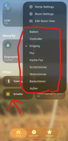

No, I wrote that the mini switch can only be found in the room view. Switches cannot be found under sensors or in the automations. Look through the rooms and search for a device that has a yellow 8 as its symbol.
It would probably look something like this:

Sorry, but most people just can’t find the switches, even though they are there. There are several posts like this on Reddit.
