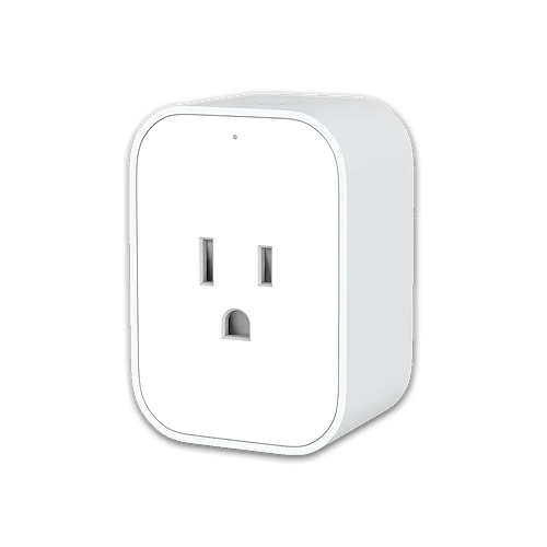

Some of my water detection sensors on the far end of my house arent reporting their status or fail to stay connected. Do I need more than one hub or is there something else i should get that would add more range to these devices. So far my Aqara stuff is just the hub and 8 sensors that are under our fridge, freezer, 2 toilets, 3 sinks and the indoor water heater. My home is 1750sqft and rectangle in shape
One hub. Add Aqara smart outlets between your hub and distant devices. Acts as a zigbee repeater.
I’m in the US, I don’t see any smart outlets from Aqara on the website. I also don’t have a neutral my house is from the 60s.
I’m 99% sure you don’t need a neutral for their smart plugs. Link to Smart Plug:
