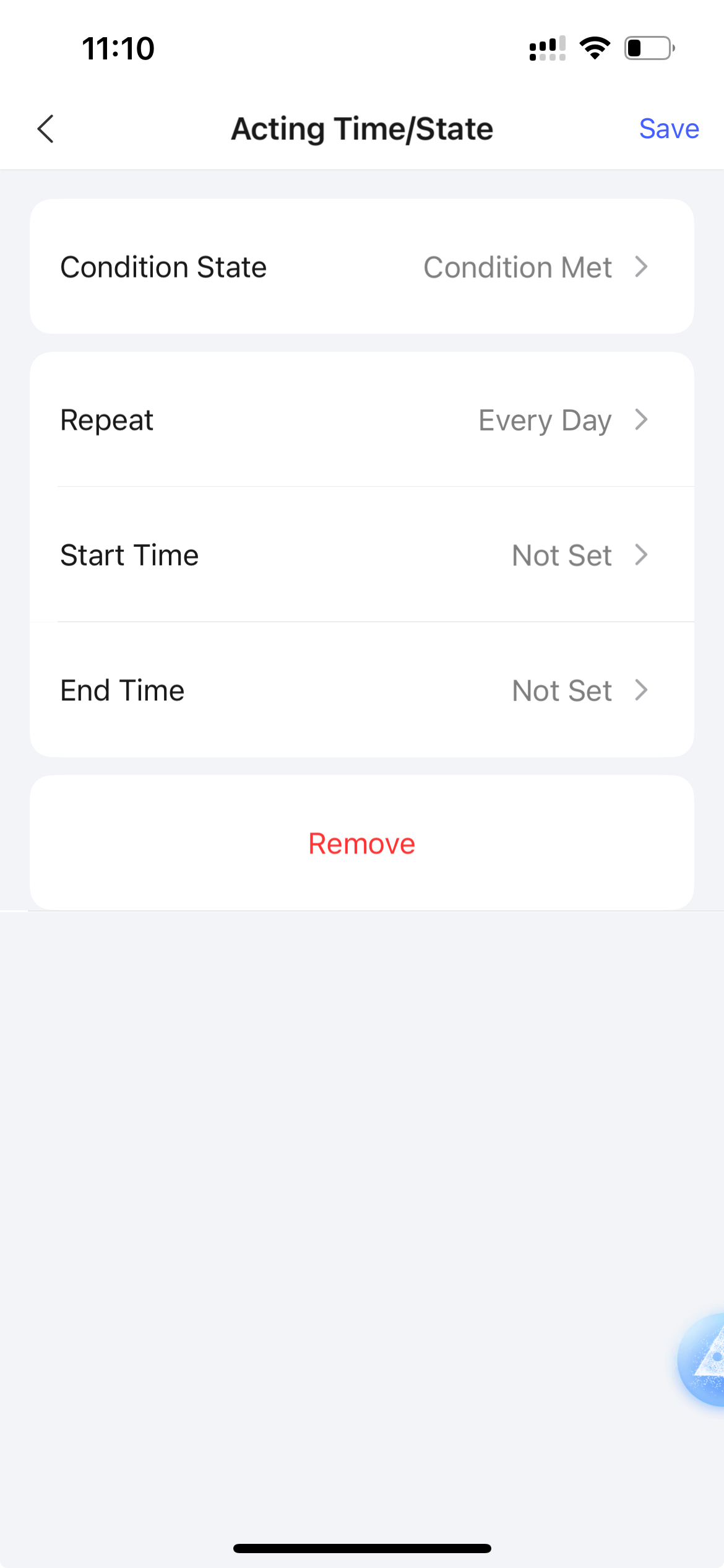

Is it only possible in Apple Homekit or would it also be possible in the Aqara app?
Yes you can do this in Aqara’s app.
Once you add the condition to IF portion of the automation, click on “Acting Time” on the right. Then you can select the window of time you want.
