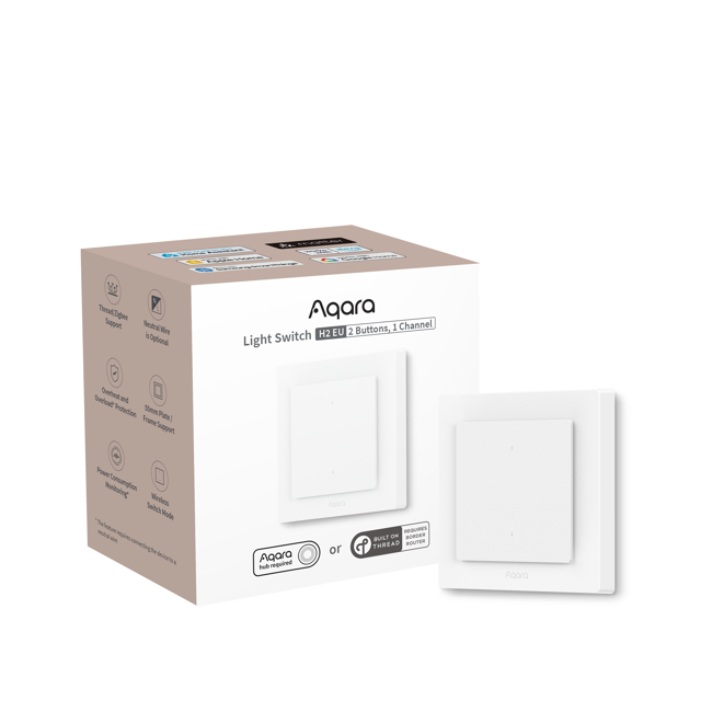

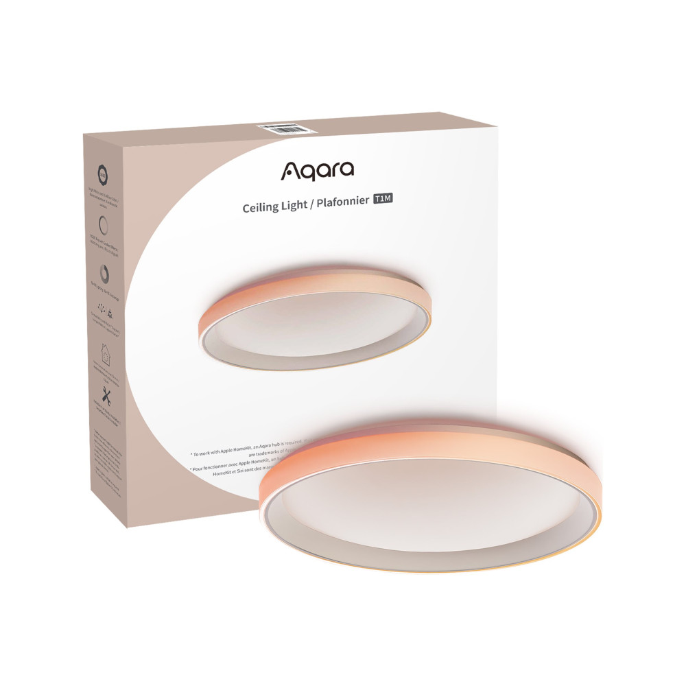

Hi everyone,
I’m trying to combine an Aqara H1 EU switch (in wireless mode) with an Aqara T1M ceiling light. The lamp needs constant power, and I want to use the H1 only as a wireless controller.
My goal is to set up the switch like this: • Single press → Toggle on/off (whole lamp) • Double press → Switch between outer ring and inner light • Long press → Dim up/down Something more?
Has anyone here done something similar? :point_right: Which scenes/automations in Aqara Home would you recommend to achieve this setup? :point_right: Any tips for smooth dimming and avoiding delay?
Thanks a lot in advance. I’d love to hear how you’ve solved this!
Hello, welcome to the forum.
Yes, I use a wireless switch to control the operation of T1m. Very convenient automation. Your request is easily solved by standard Aqara automation elements. Regarding the delay, there is none, perhaps you need to set the on-off transition time and the off-off transition time in T1. I always practice setting 0 seconds.
