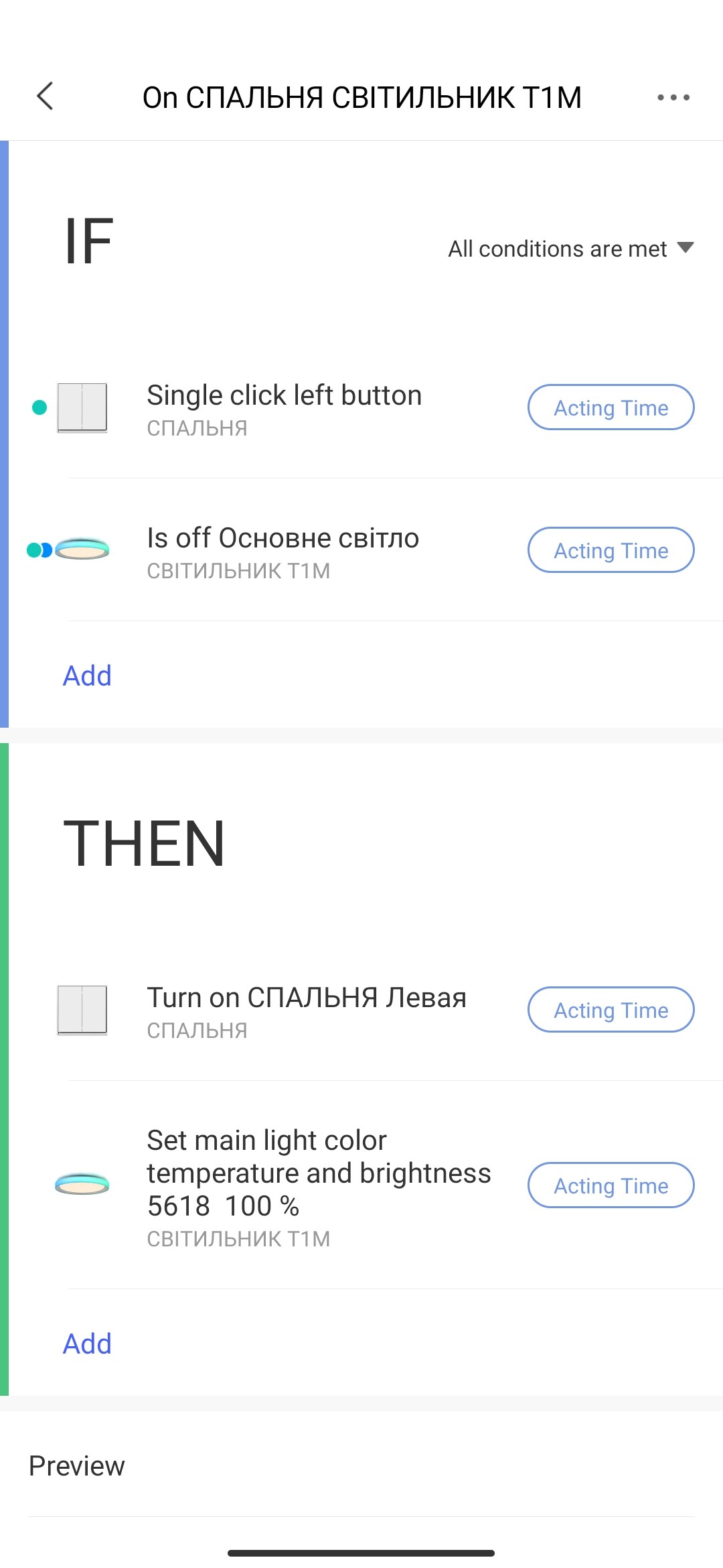

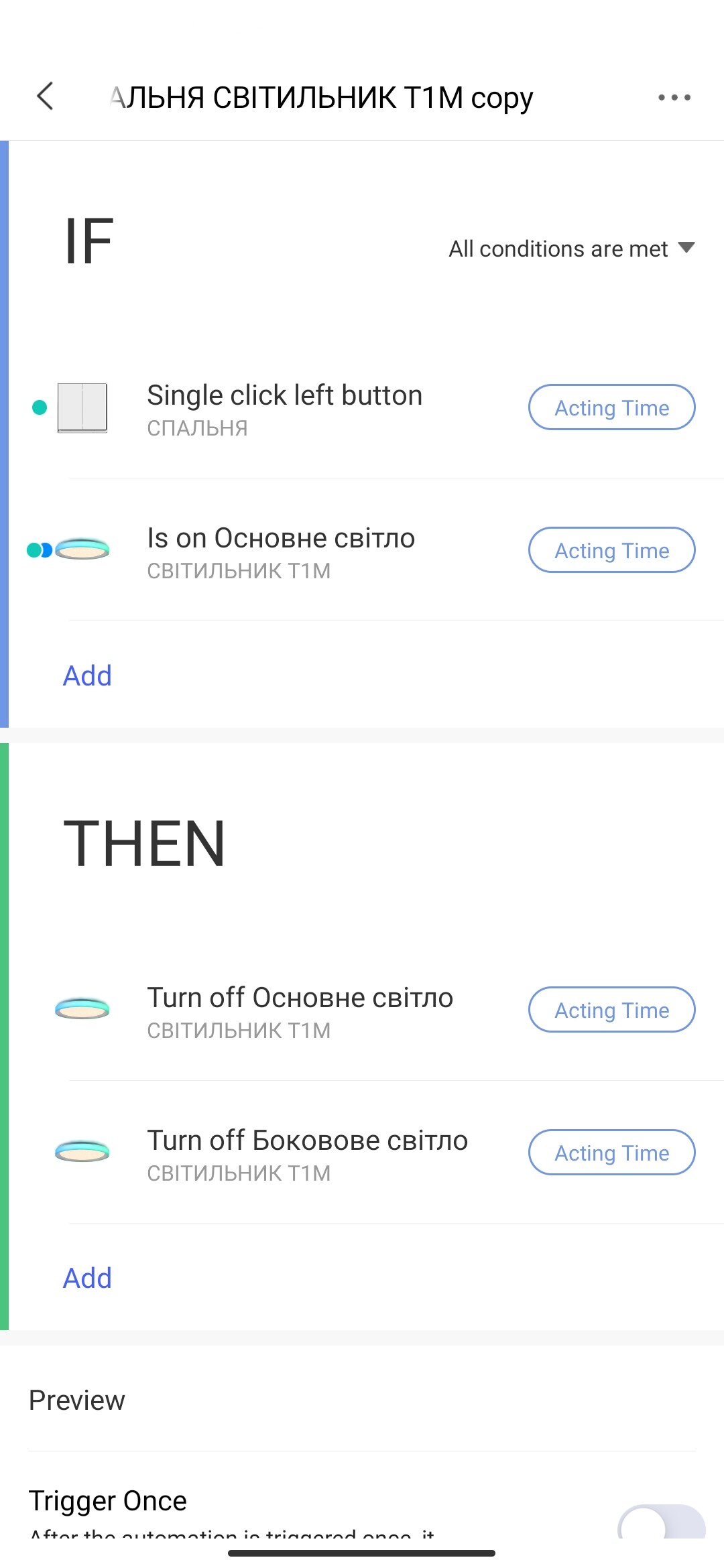

I untied the switch button, and made automations that are done for different combinations of the T1m lamp state. For a quick understanding, I give automation version 1.0
Hi, thank you for your reply on this. When you mention that you untied the switch button, is there mean that the switch only have L & N connected only? L1 Load from the T1M light is disconnected? Thanks for the guide as i am quite new on Aqara product and currently setting up my new home. :slight_smile:
Hello, in my version (wall switch without zero) the switch has two buttons L1 and L2. L1 powers T1M. I untied this button (L1) (meaning it works in logical mode) and it controls the lamp turning off. Turning on L1 from automation is done in order to turn on the lamp in case L1 turns off (accidental shutdown from the application, after restoring the industrial network, etc…).
