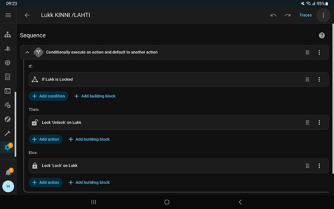

I allready made this automation in home assistant because i did not figure it out how to make it in aqara hub, but i’ll ask anyway.

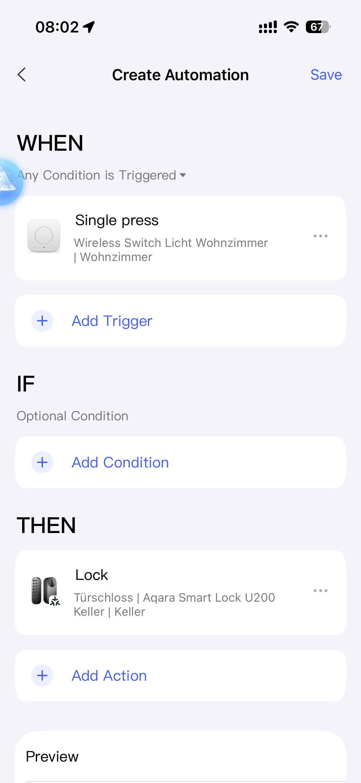

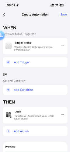

U200 lock, M100 hub and Wireless mini switch T1.
How to make it: 1 click’ unlock door, 1 click, lock door?
It is such a simple thing to do but it’s not possible to make with aqara automations.

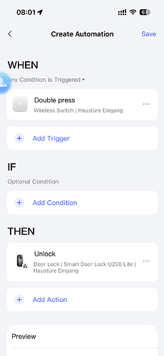

Hi @henry_neemelaid… It’s possible with U200 and u200 lite
Not double click. Single click unlock, single click lock.
And all this is not possible because i cant ask what state lock is.

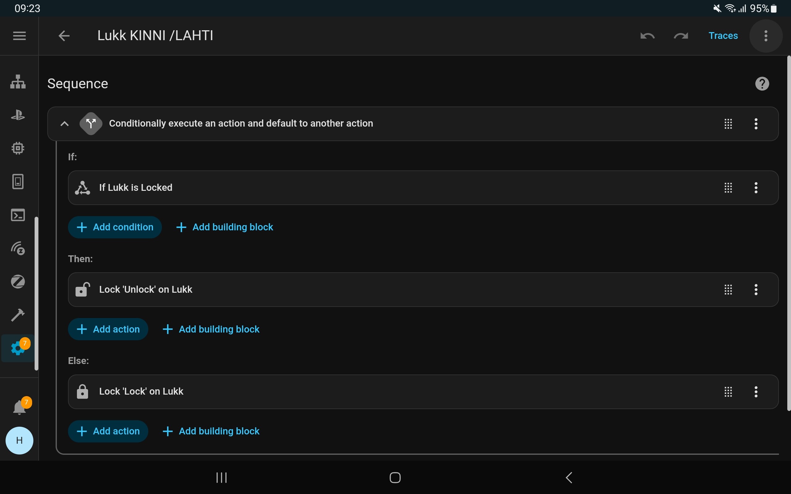

In Home Asssistant it is made so simple
Yes, it’s better in HA.
Unluckily Aqara’s if settings are limited for the U200 lock :confused:
And i don’t see any real reason for this. Why limit it?
Maybe can @KinseyCreateGoods give us the necessary informations, why the U200 is limited in its features. There’s sure a reason
