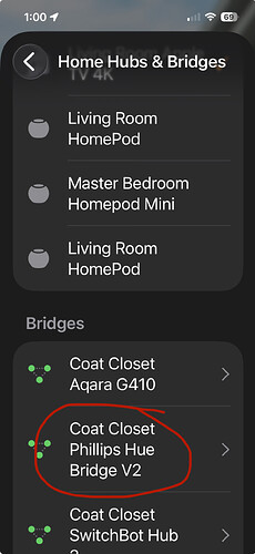

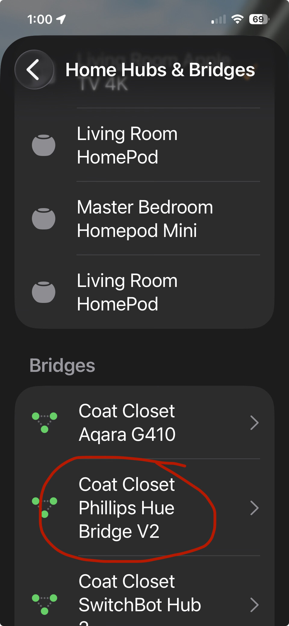

That’s odd cause through HomeKit I’m able to do a few things especially with my hue bridge…lets try something,is your hue bridge connected to HomeKit?if so try using the native hue app and try updating it.It should look something like this
