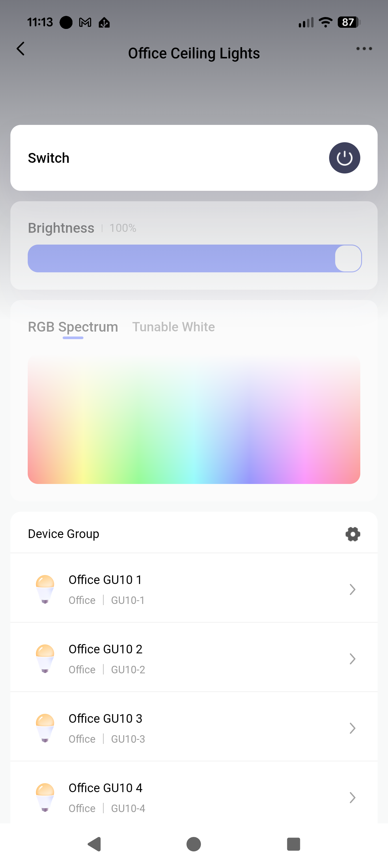

Step 1: Create Your Light Group
Start by creating a light group and giving it a descriptive name.
For example, I have six T2 GU10 downlights in my office, so my group is named Office Ceiling Lights.

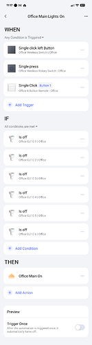

Automation 1: Turn On the Lights
Trigger: Press any of your designated light switch buttons.
Condition: The automation checks whether all lights in the group are currently Off.
Action: If true, it activates the “Turn On Group” scene.

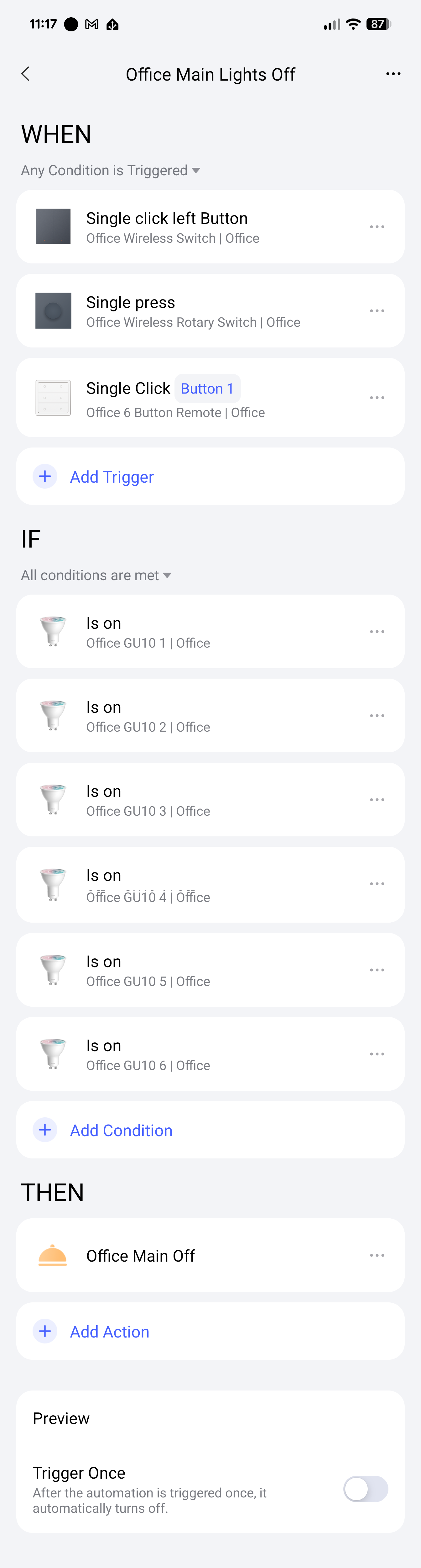

Automation 2: Turn Off the Lights
Trigger: Press any of the same light switch buttons.
Condition: The automation checks whether all lights in the group are currently On.
Action: If true, it activates the “Turn Off Group” scene.
Why This Works Better
Unlike my original version, this setup doesn’t require the automations to toggle each other or run only once. This makes it more stable and ensures your lights stay in sync—even if you control them through third-party systems like Home Assistant.
