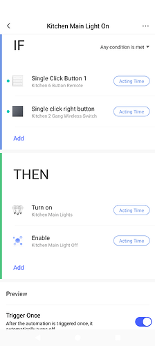

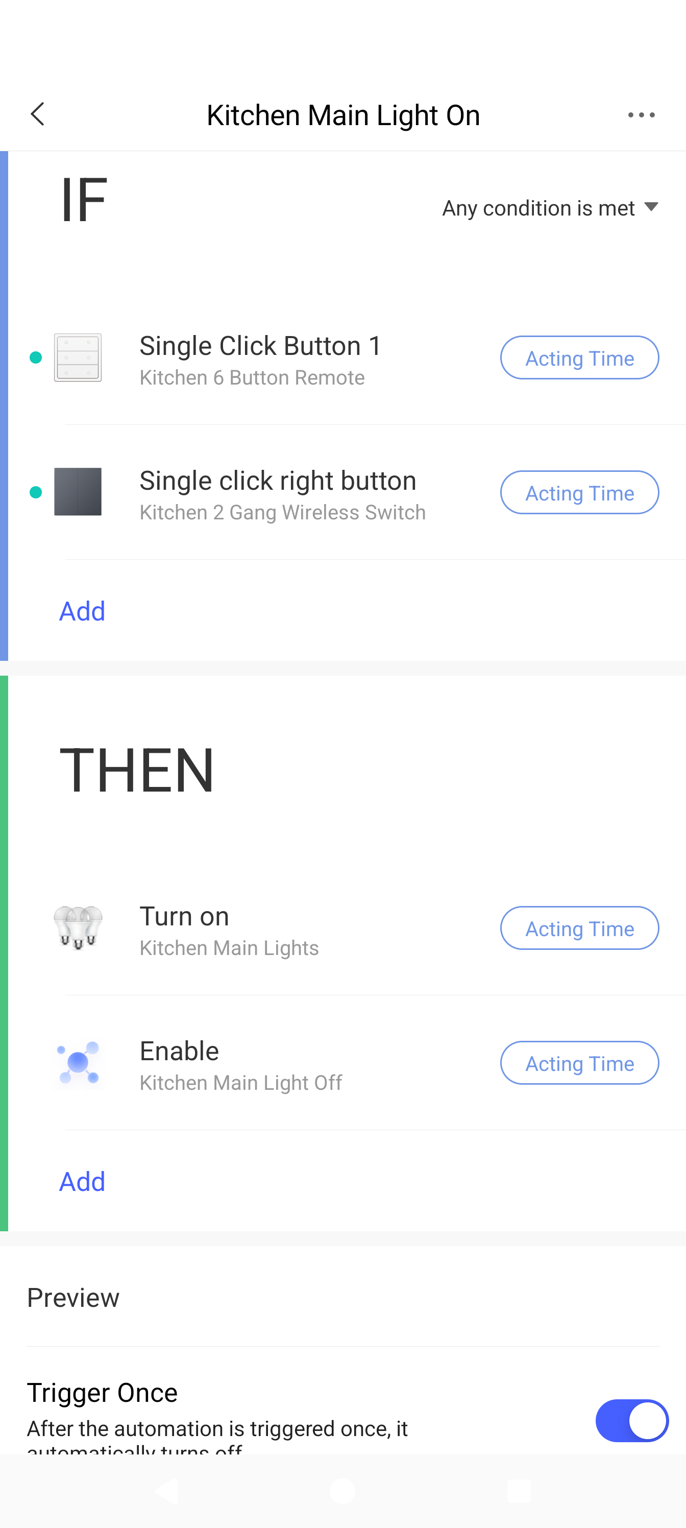

Automation 1: “Group Light On”
  • Trigger: Single button press
  • Action:
    • Turn on the group lights
    • Enable the “Group Light Off” automation
  • This automation will disable itself after triggering, due to the “Trigger Once” setting.

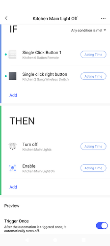

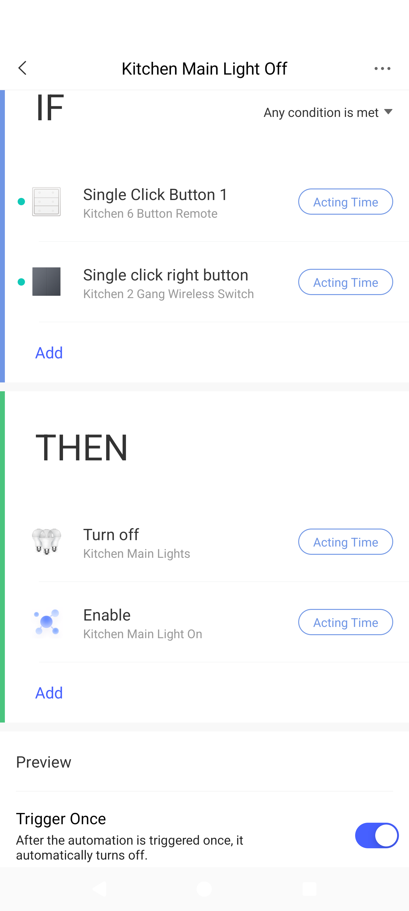

Automation 2: “Group Light Off”
  • Trigger: Same single button press
  • Action:
    • Turn off the group lights
    • Enable the “Group Light On” automation
  • This automation will also disable itself after triggering.
