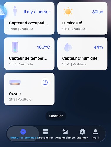

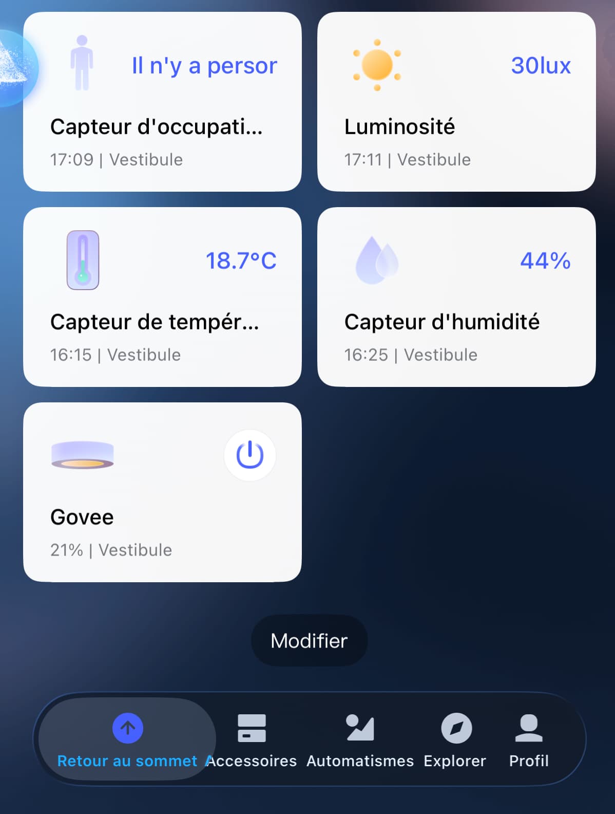

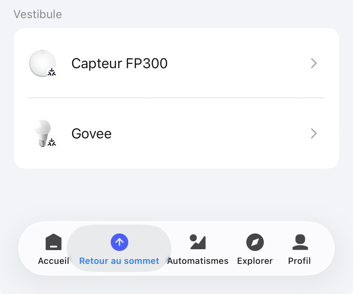

Once the device was added, I simply customized the default configuration:
  • renaming the ceiling light with a more descriptive label than the automatically generated name,
  • changing the icon so it better matches the type of installed fixture.

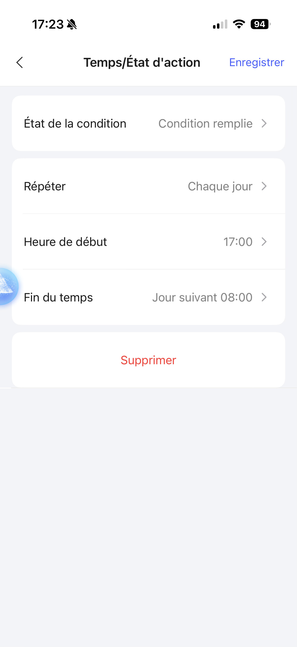

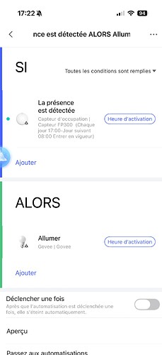

The first automation turns on the Govee ceiling light when the FP300 detects presence. I also defined an execution time window, with a start and end time: there is no need to turn on the light during the day when natural light is sufficient.
The second automation automatically turns the light off when the FP300 no longer detects anyone in the area. Thanks to the FP300’s continuous presence detection, the behavior is smooth and consistent, with no unexpected shut-offs.

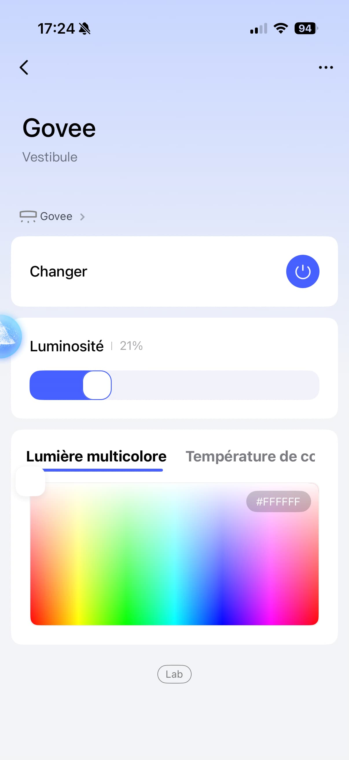

Overall, the integration is very solid. One limitation remains: the lighting themes and advanced effects available in the Govee app are not exposed via Matter. From Aqara Home, the light can be controlled in a standard way (on/off, brightness, color depending on the model), but without access to Govee-specific scenes. This limitation is due to the current state of the Matter specification.

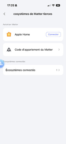

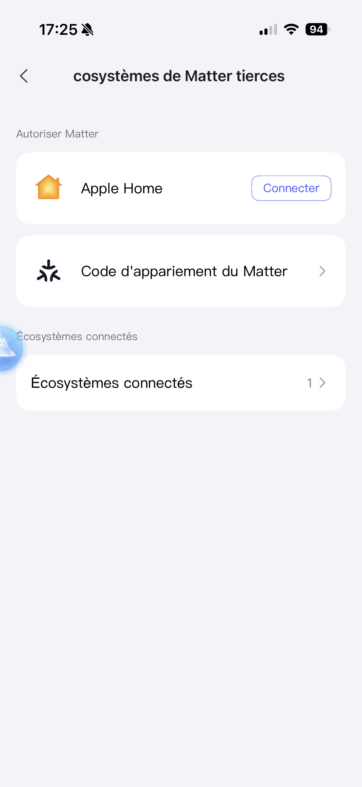

The original Matter QR code can only be used once, for the initial pairing. To add the device to another platform, you must generate a new Matter pairing code. This is easily done in Aqara Home: open the Matter device settings, go to the Matter section, and select “Matter pairing code”. The newly generated code can then be copied or scanned from another platform.
(In French, Code d’appairement du Matter)
By the way, there’s a typo here. It should be « Code d’appairement de Matter. »
In my setup, I was able to add the ceiling light to HomeKit without any issues, while keeping it fully active in Aqara Home. Multi-platform coexistence works exactly as expected.

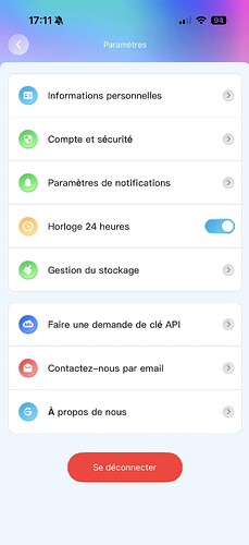

The first step is to obtain a Govee API key. This is done from the Govee app, in the user profile: open settings (the gear icon), then select “Request an API key”. The key is sent by email and should be kept safe.
