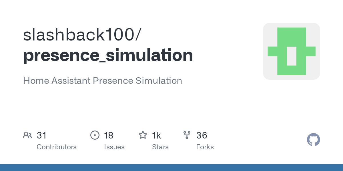

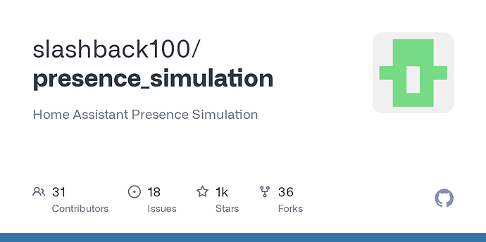

There are some pretty clever integrations available for Home Assistant, like this one:
The integration records the behavior of the assigned entities (e.g., a lamp or a TV) for X days, and while you’re on vacation, the entities do exactly what you did during those X days (with an adjustable time delay).
