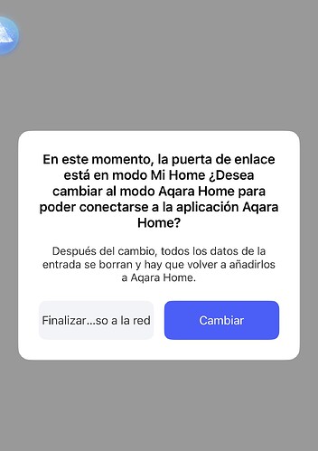

Solo consigo que Homekit lo añada a una habitación, pero el dispositivo no aparece ni en la casa de Homekit ni en la App de Aqara. Solo se muestra un mensaje que dice:
“En este momento, la puerta de enlace está en modo Mi Home ¿Desea cambiar al modo Aqara Home para poder conectarse a la aplicación Aqara Home?” Y cuando pulso “cambiar”", me da error y ya no puedo continuar.

You need to change to Aqara modus
Did you tried these steps?
From Mi to Aqara

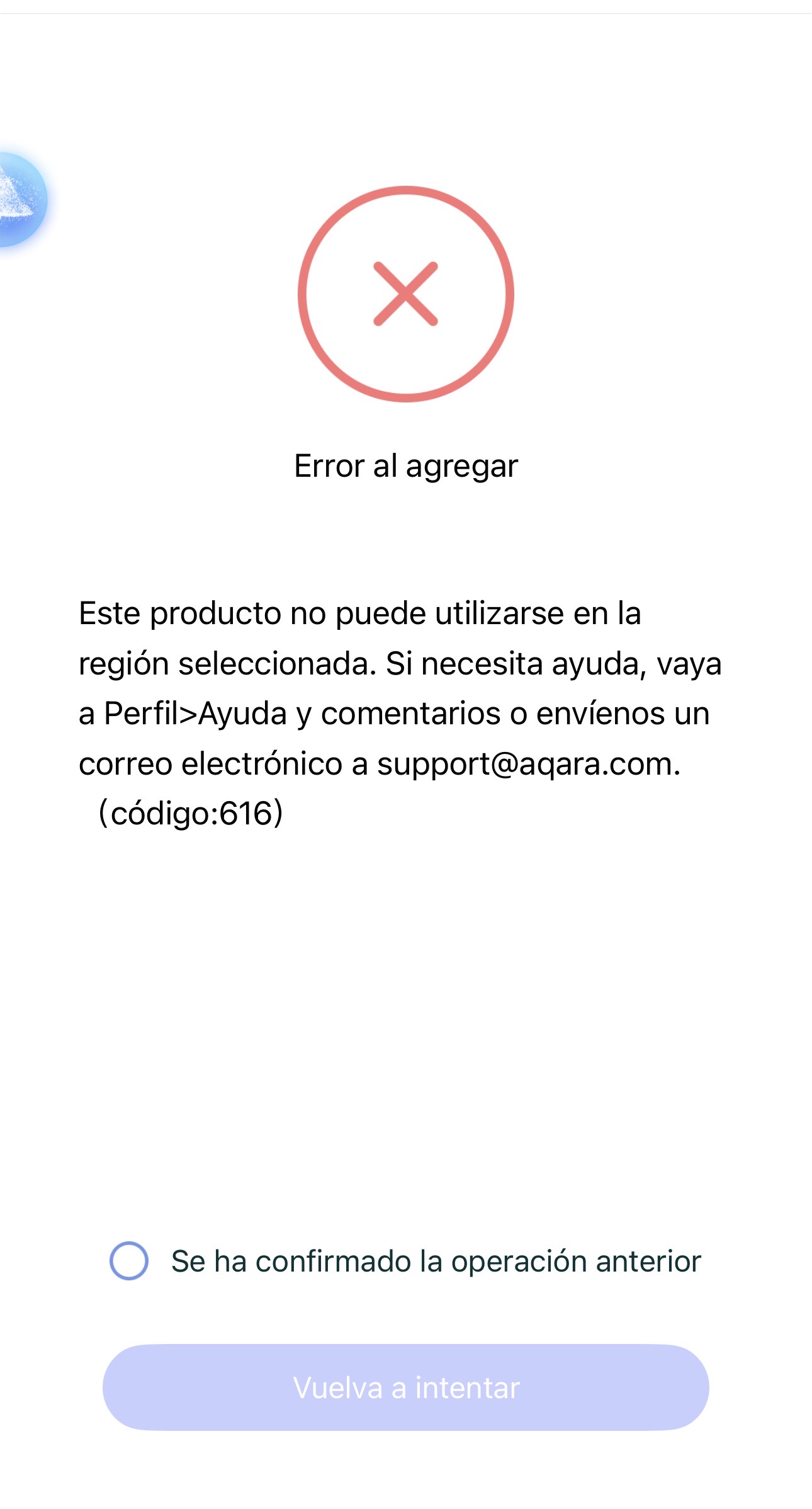

OK Thanks for the reply. I’ve changed to AIOT mode, but now the app show an error with the region connetion
What can I do, please?
Did you bought a Chinese version? Then it probably works only on mainland China server
And I can’t change the zone in the settings? If not, I don’t understand how a dealer can sale a device that don’t run to an EU buyer.
Where are you bought it?
If you bought a Chinese version it’s just available for Chinese server. Specially the hubs are limited to the market (China, Europe, USA…) they are sold for.
Some sub devices works on all servers
Ok. Finally I solved the problem. I’ve reinstalled the Aqara app and I’ve just selected China as my region and disabled location, then I can add the Hub, and the Aqara Mini button.
