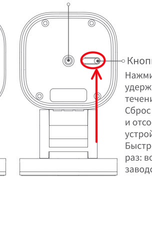

How do you reset the device to factory settings please?
Quickly pressing the reset button 10 times - reset to factory settings.
Holding the reset button for 10 seconds - resets the network connection.
