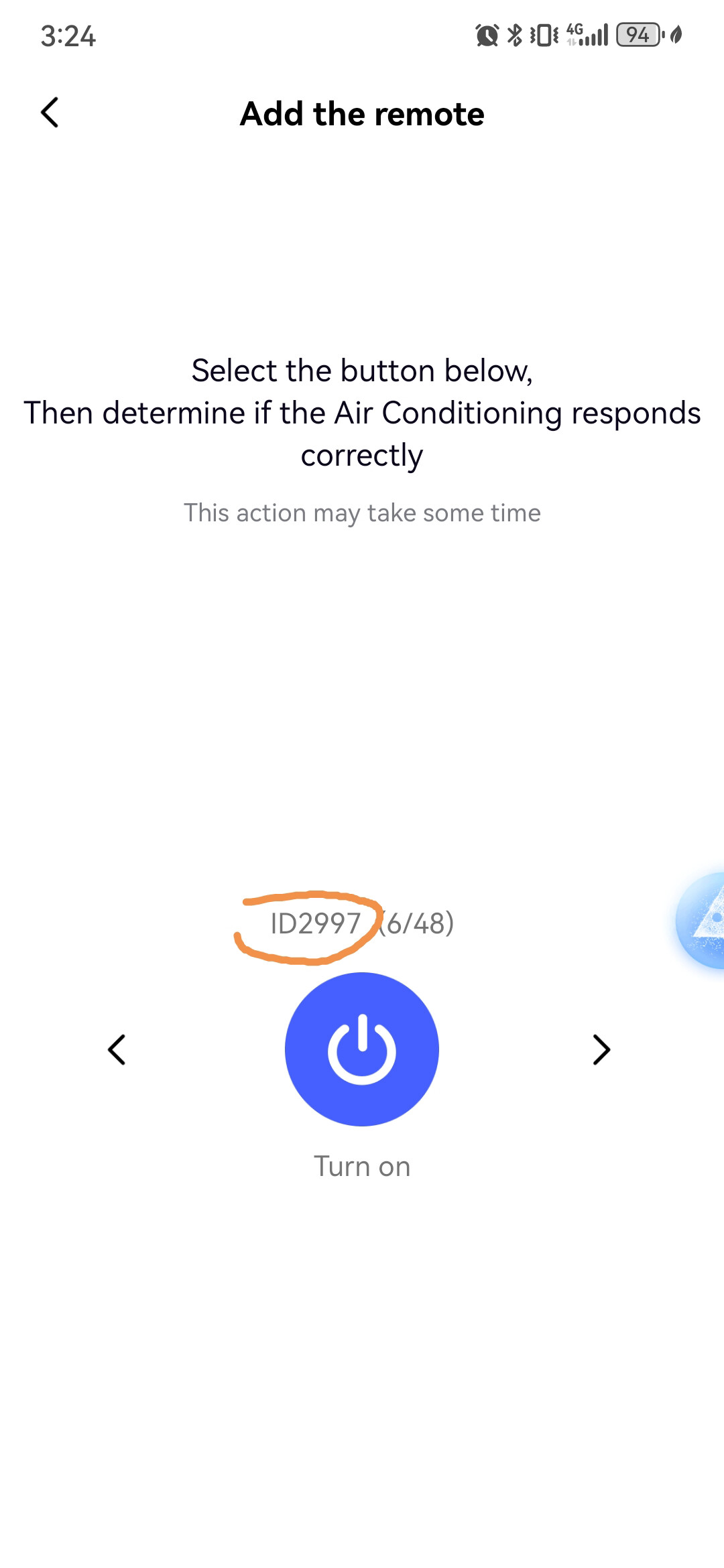

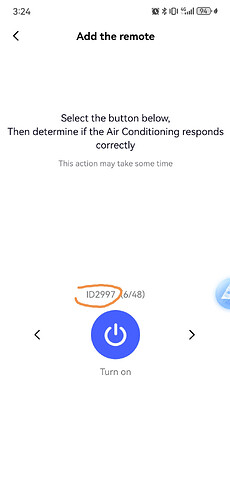

@markwwd Confirmed, the infrared code library for the Mitsubishi Electric AY35 air conditioner model uses ID2997. When matching the remote control codes, please switch and select the ID2997 model’s infrared code by navigating through the left/right arrows.
I tried that one too and it also changes the vane settings when changing the temperature.
