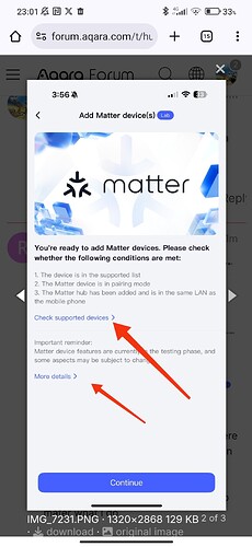

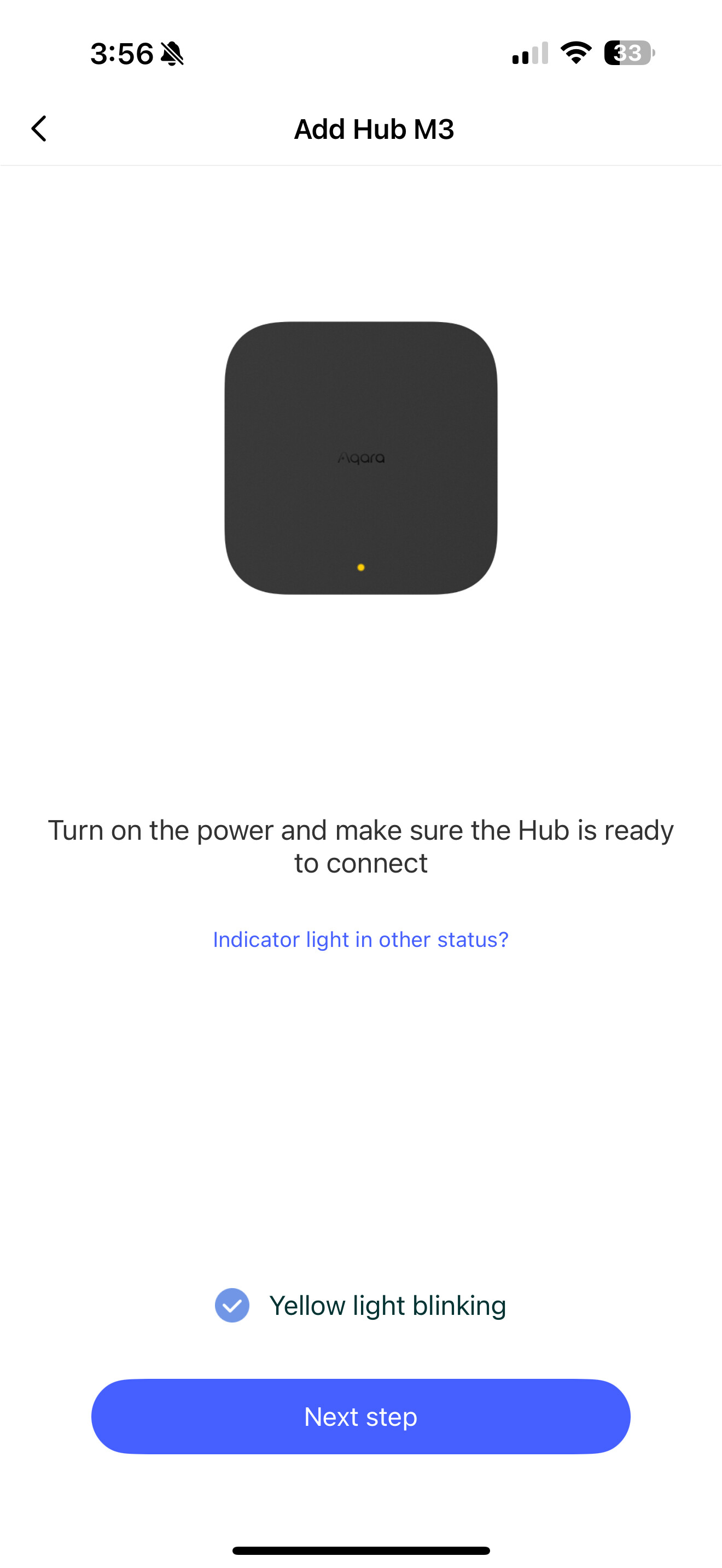

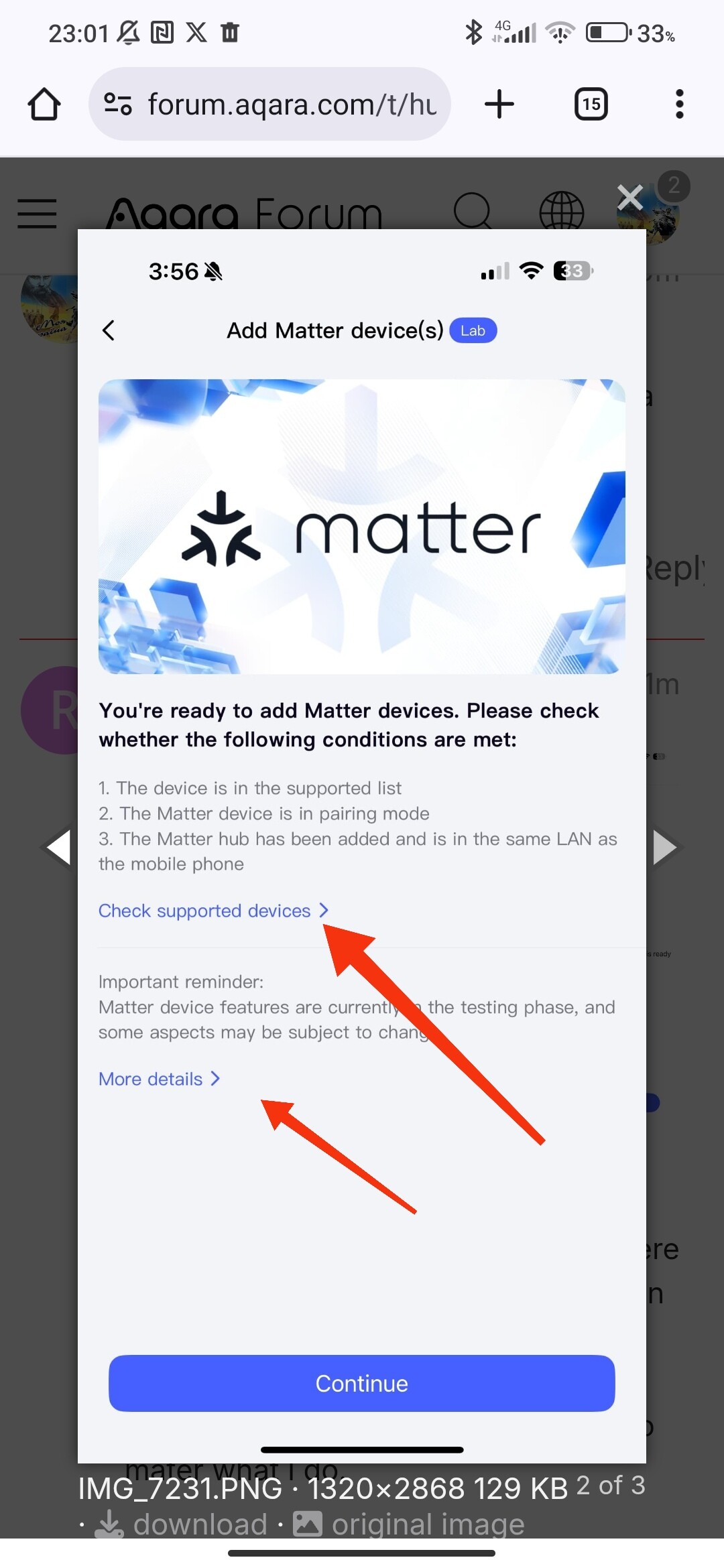

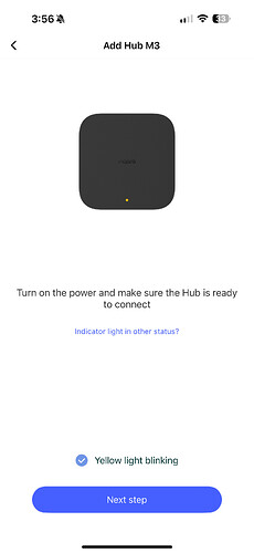

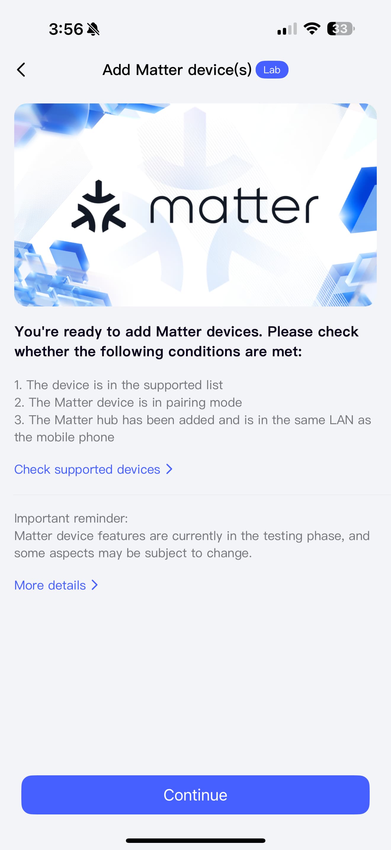

I am trying to add a new M3 Hub to my home. The light is blinking yellow and I am on the “Add Hub M3” screen and scan the Matter QR code. It says “Connecting” and I then get a screen that says “You are ready to add Matter devices”. At the bottom is a “Continue” button. When I press that it goes back to the “Add Hub M3” screen and it starts all over. It never adds to the app. I’ve done a 10 second press of the reset button, unplug and plug back in, etc. Nothing has helped. Any ideas? Thanks…
Hello, I don’t understand? The M3 gateway is connected to the house via WiFi. Please give me a screenshot.

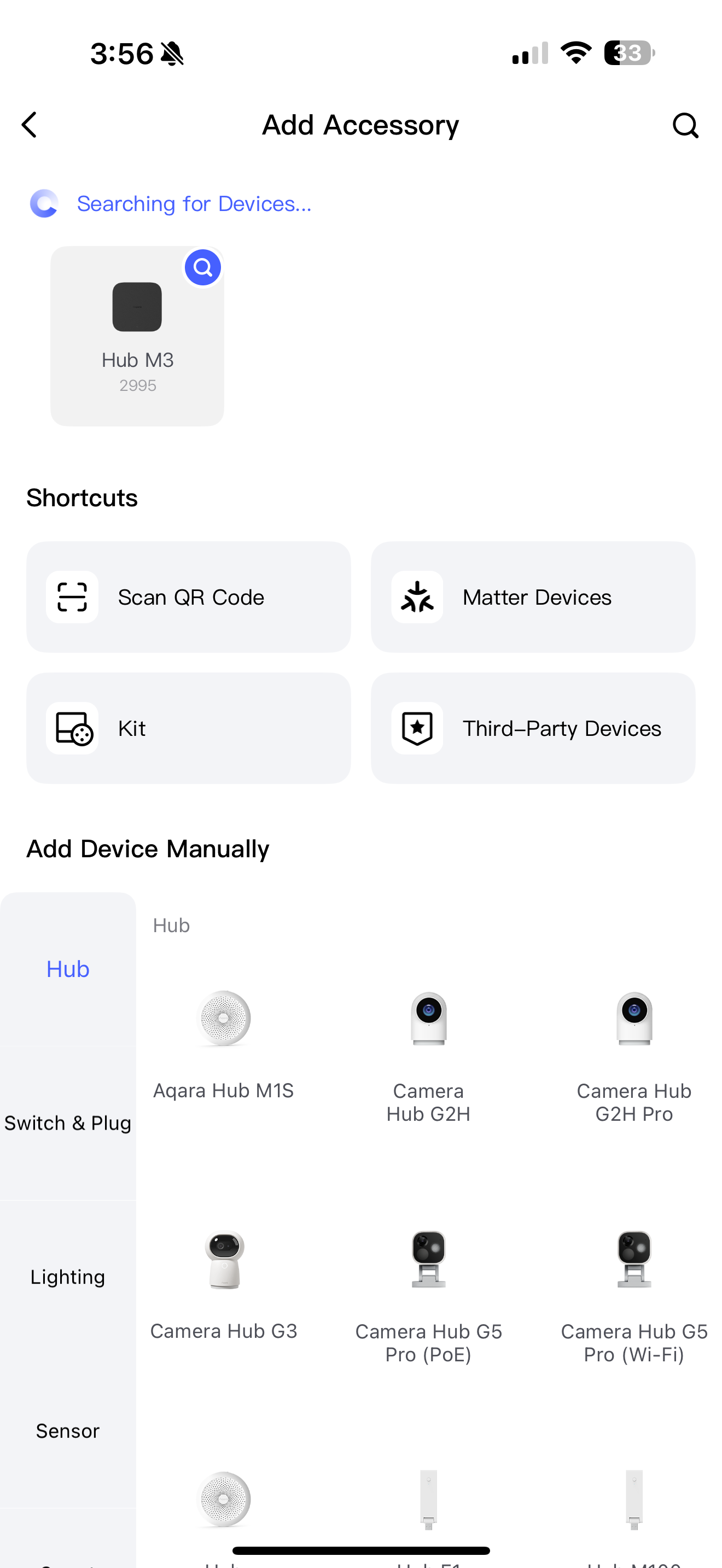

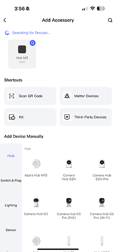

I select the M3 at the top of the first screen. It goes to the next screen where I hit “Continue”, and on the third screen I hit “Next Step” and scan the Matter code. It immediately goes back to the 2nd screen and that loop continues no mater what I do.

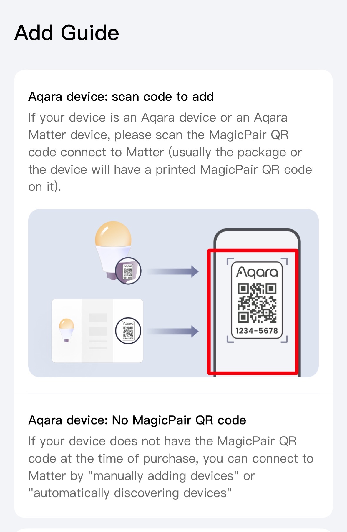

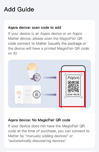

You need to scan the aqara code, not the Homekit code but the Aqara code.
Go to these tabs and switch to another connection. I can’t tell you for sure, but there should be a switch from Mateia to another channel. Maybe someone else can tell you.
Guys, there is no matter code on the hub itself, there is only an Aqara code (magic pair) and a Homekit code. The matter code can only be found in the m3 plugin in Aqara home.

Thanks @Raman.V - that did it. I DID scan that code the first time but it popped up an error message. So I moved on to the Matter code where there was no error popup but of course no connection either. Thanks so much!
