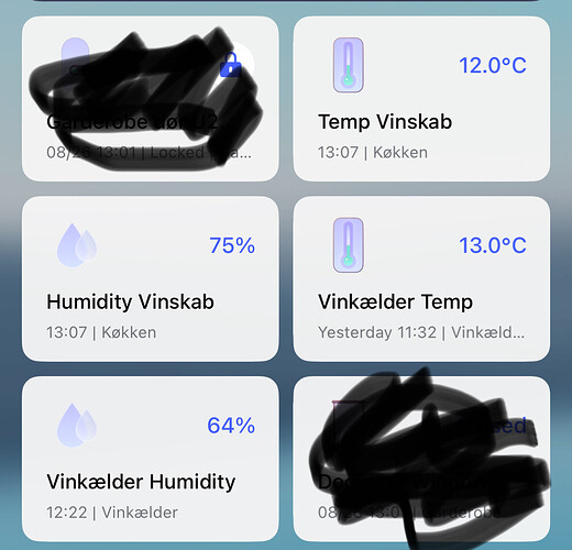

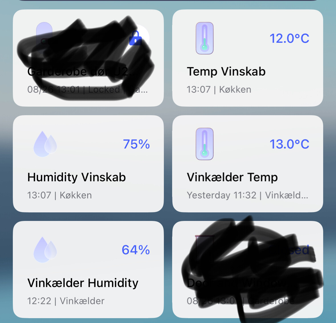

So over the last couple of days I have been setting some new Aqara products up in my new house. For a long time I have been using the T1 Temp and Humidity sensors on my wine cooling cabinets to monitor humidity and temperature which has been working perfectly…. A few days ago I then bought the new W100 and for testing put that in next to one of my T1 sensors. One would expect they would come out pretty close to each other both temp and humidity wise, but that is certainly not the case :flushed:
The T1 gives temp 12C and 75% humidity
W100 gives temp 13C and 64% humidity
In my line of business (approx 1mill USD worth of wine) the difference between the 2 units are significant. (And yes the W100 has been in the same place for +24 hrs to remove any area for faulty measurements).

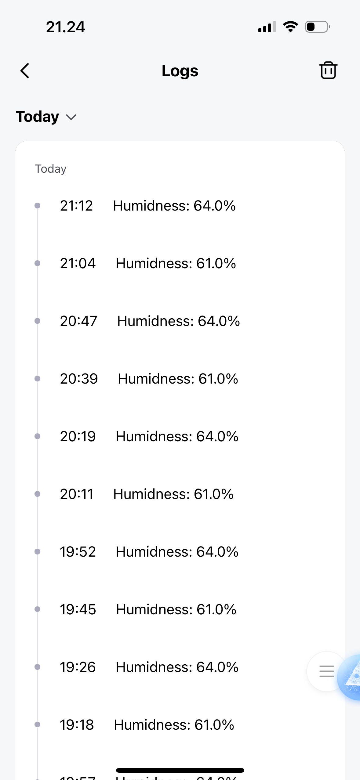

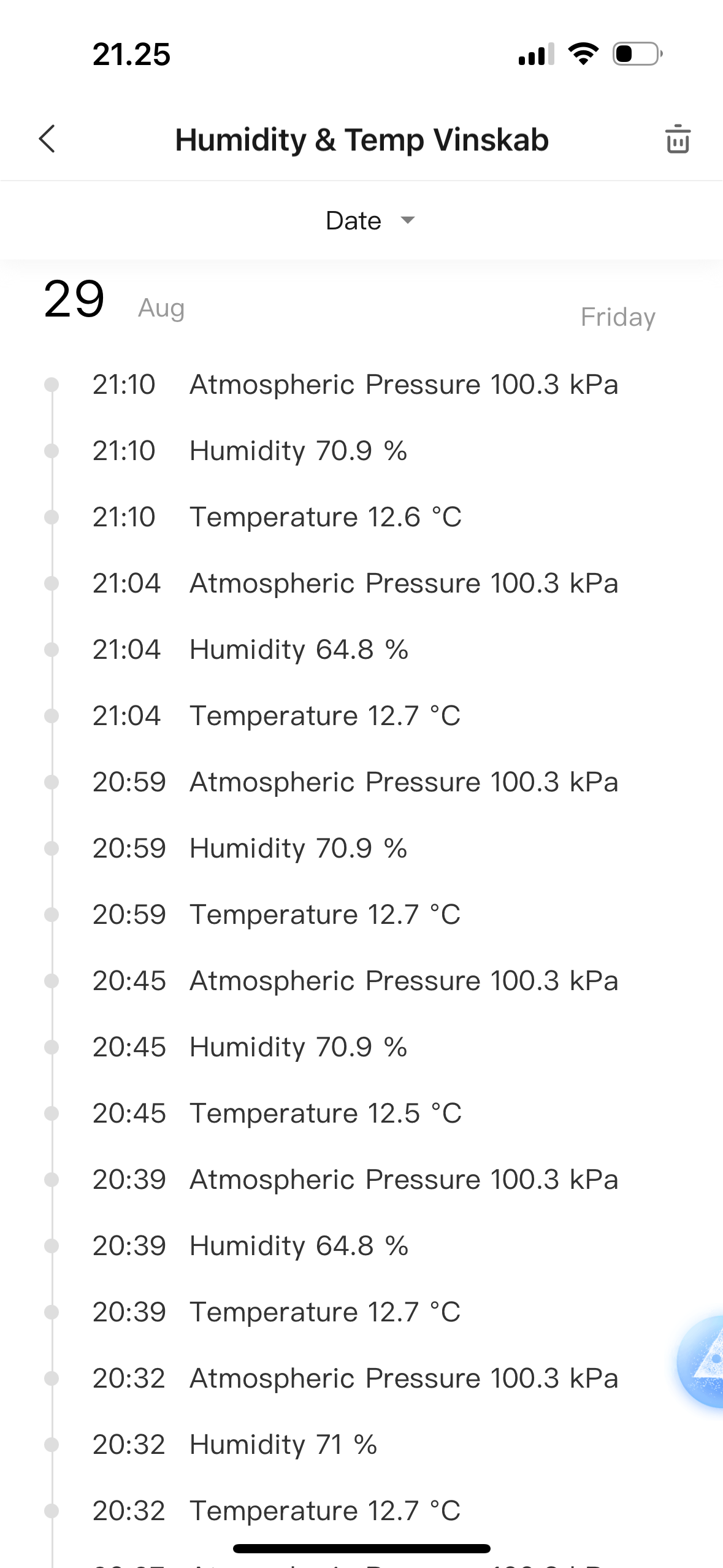

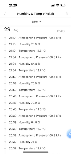

That T1 takes measurements once or he is factual wrong. It takes measurement every 5-6 min. (See attached) where as W100 does it very randomly looking at the logs… the picture with both temp, humidity and pressure is from the T1 where the humidity is from the W100 log…
Follow the instructions I gave you. The W100 has the ability to measure at a speed of 500 milliseconds.
To understand the algorithm, your T1 gives the temperature only because the humidity measured by the sensor changes and therefore sends an information signal that includes temperature data.

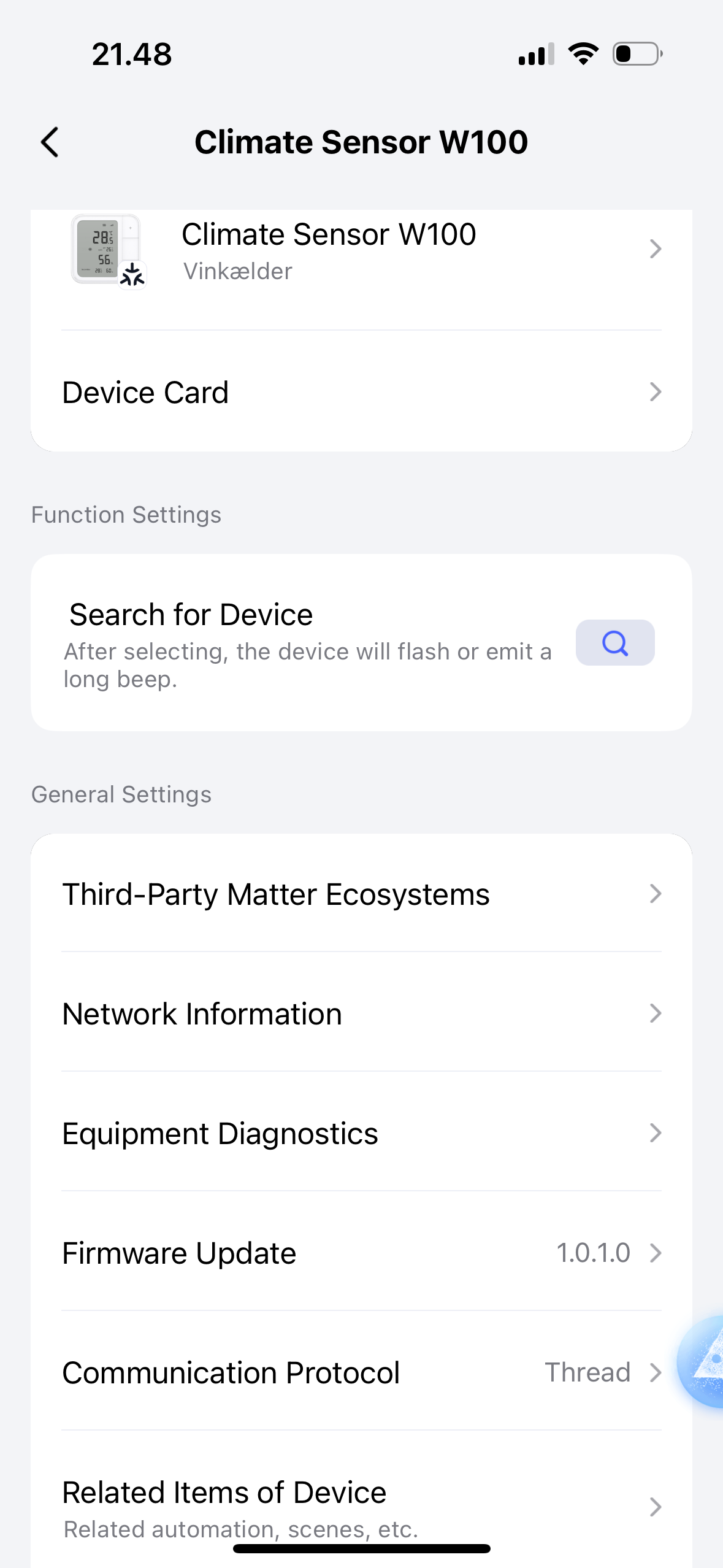

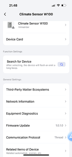

Are you running on Zigbee? Because I don’t have that setting on Thread?
Yes, Zigbee.
Guess I’ll have to reconfigure it and try Zigbee :+1:t2:
@gafich10 Just changed it to Zigbee and linked it with the other sensor and now they are significantly closer to each other :+1:t2: :pray:t2:
