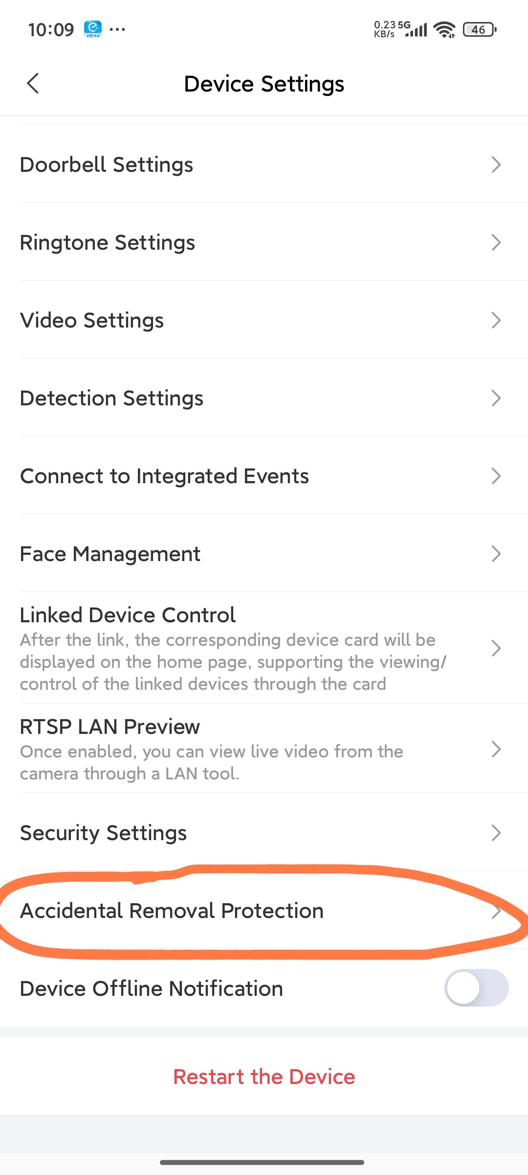

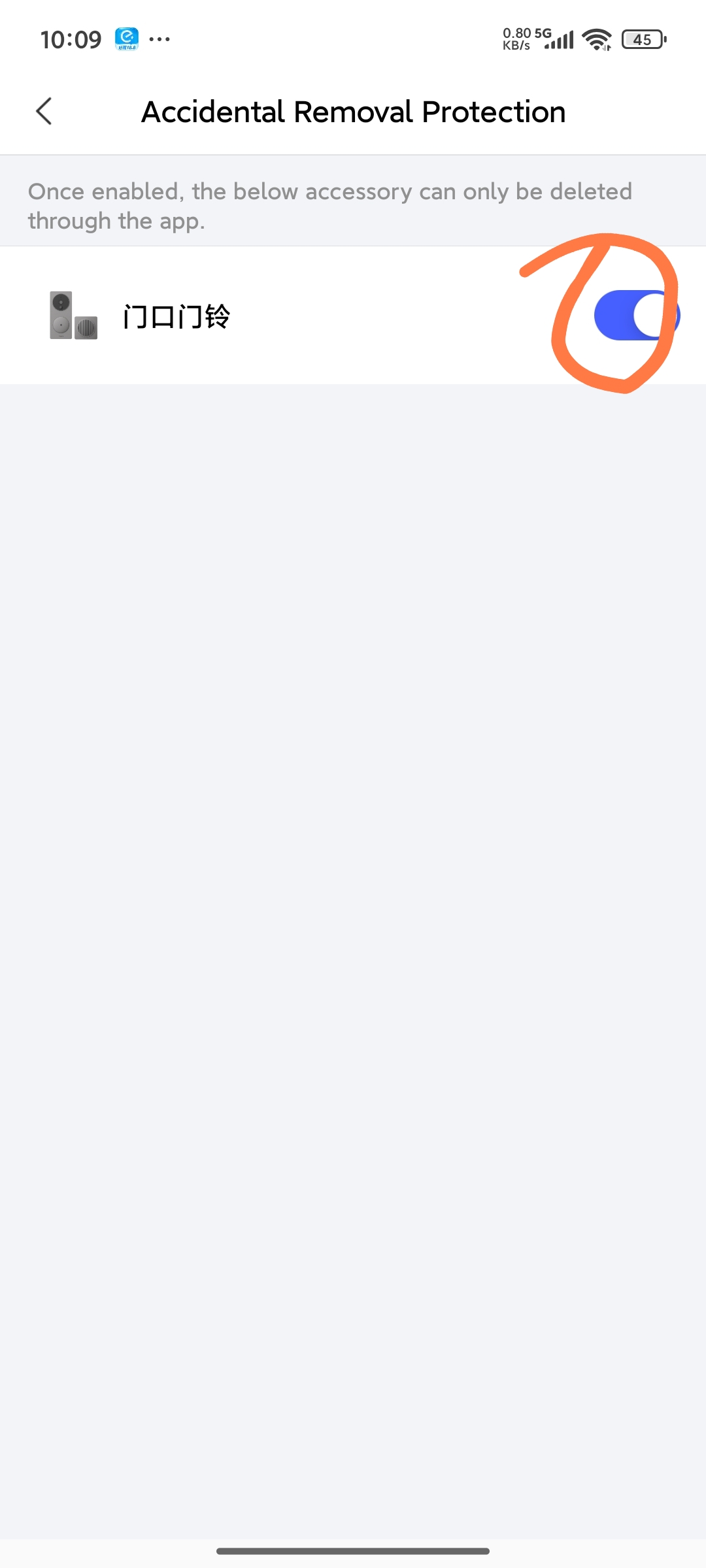

I showed two pictures below. When this feature is turned on, by pressing the indoor chime function button for 10 seconds continuously, it will play “Please delete the accessory in the app.” You need to turn off this feature to complete the device unbinding. Another way is to restore the device to factory settings by pressing the indoor chime function button 10 times, but this operation will unbind all child devices and automations that have already been set up.

I have effectively activated this security function in the past. This explain the behaviour. I finally restore to factory to operate again the G410
