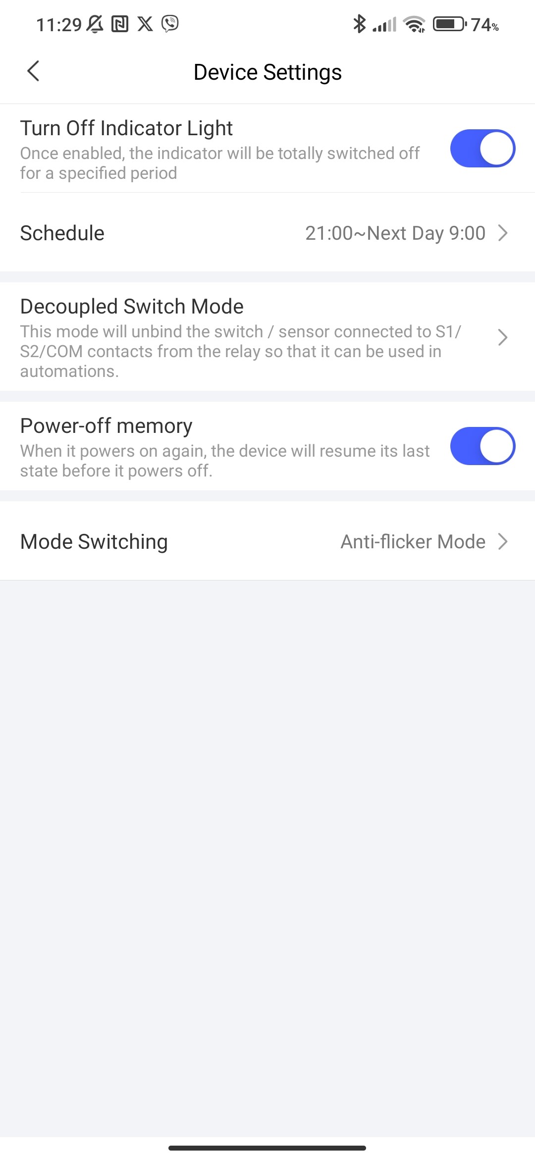

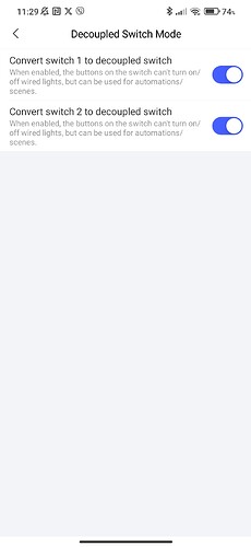

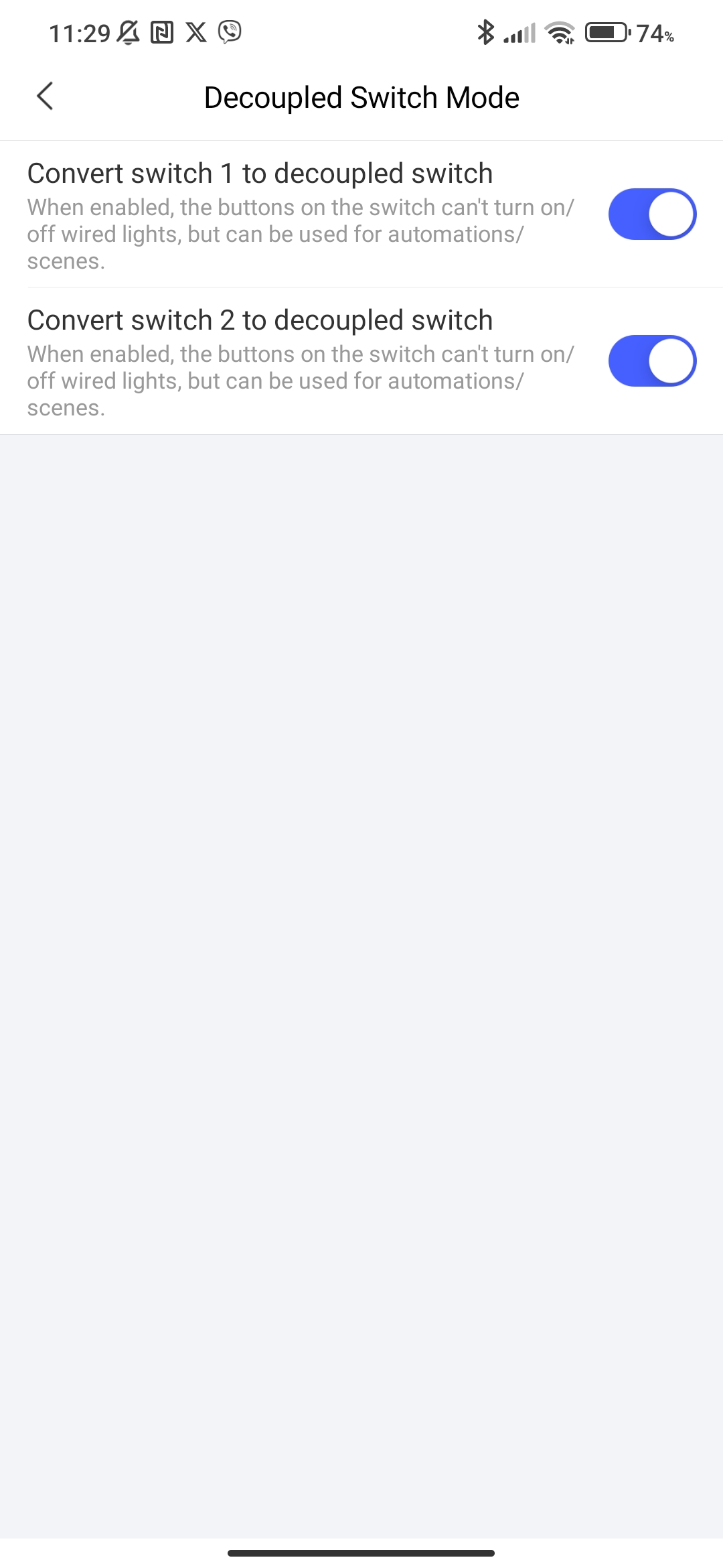

I installed a T1M light and an Aqara Smart Switch connected with neutral and set as decoupled.

When I control the light directly from the switch, it works because of the decoupling.

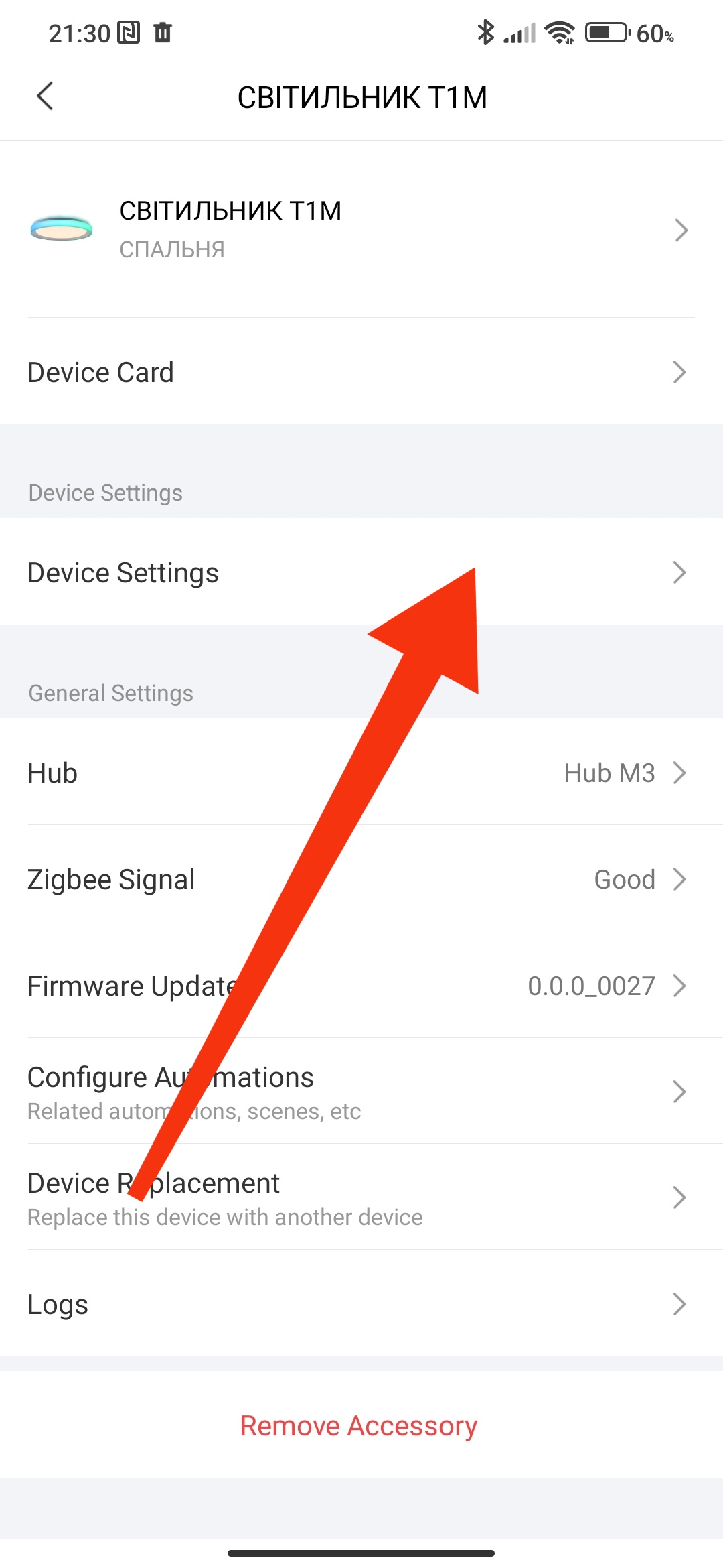

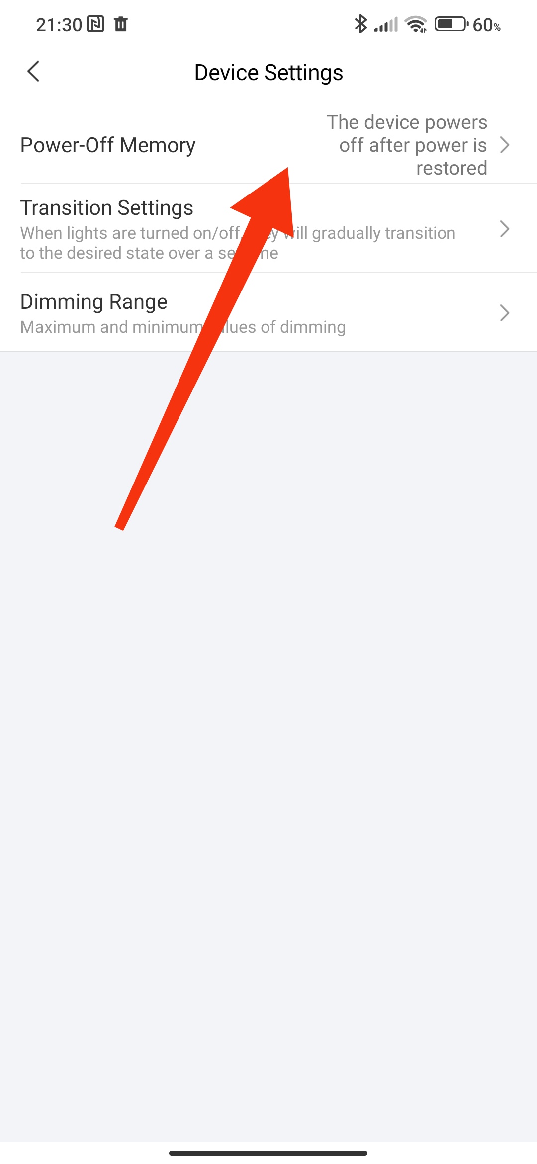

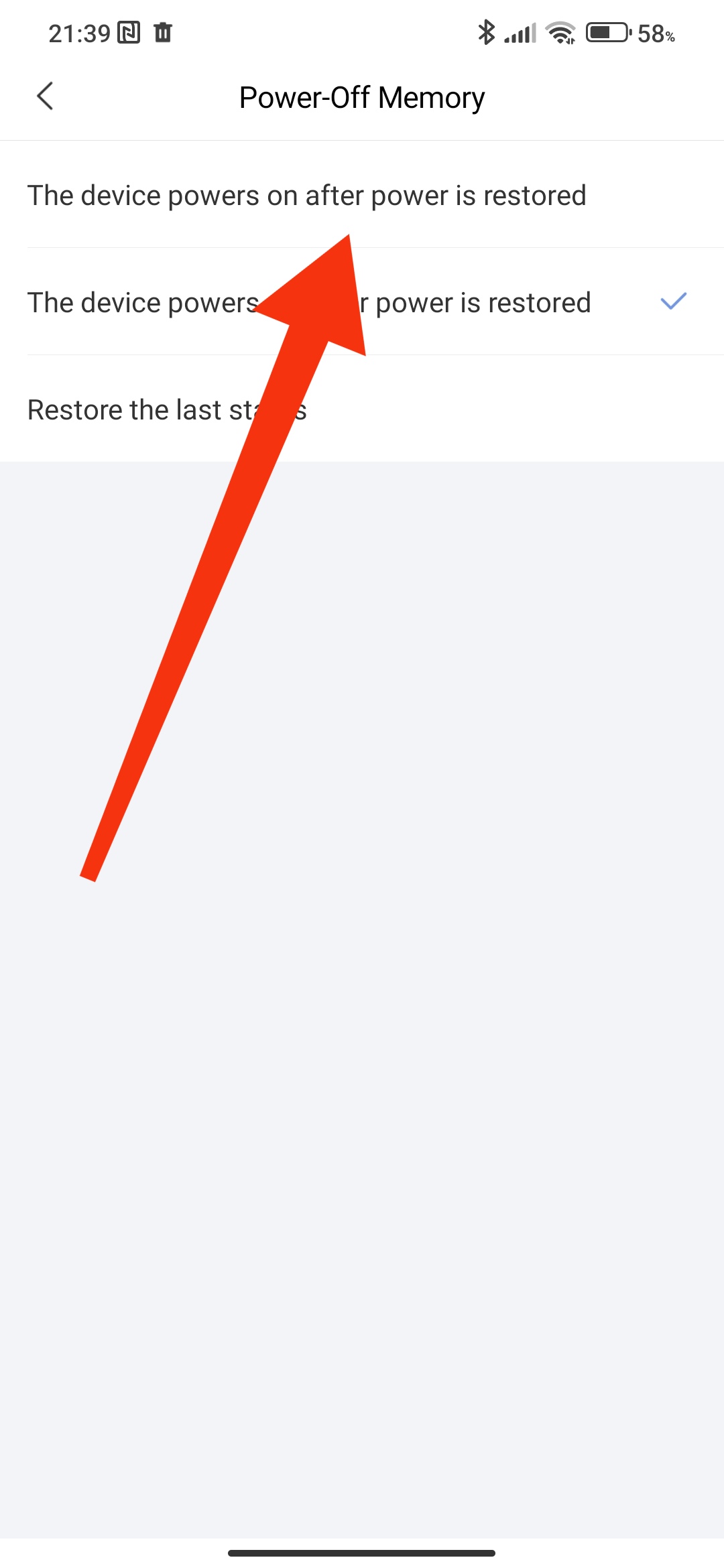

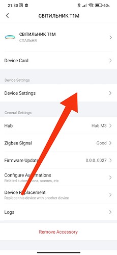

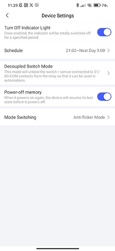

Hello, select the option “the device turns on when light appears”. You will make the smart one a “dumb lamp” that is turned on with a simple switch. Please note that after turning it on, it will light up in the position it was in before turning it off.

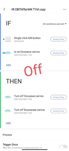

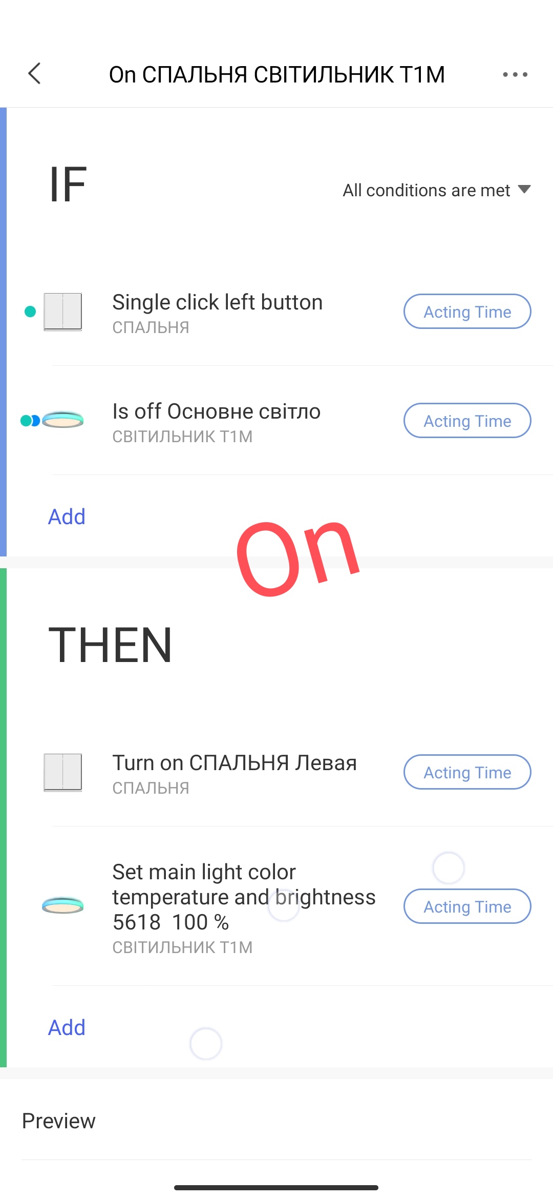

Hello, maybe you turned the smart switch (physical) into wireless mode? Check my version and write back to me.
If so, then you need to make an automation that will turn on T1 when you press the physical switch (in which the button is unbound).

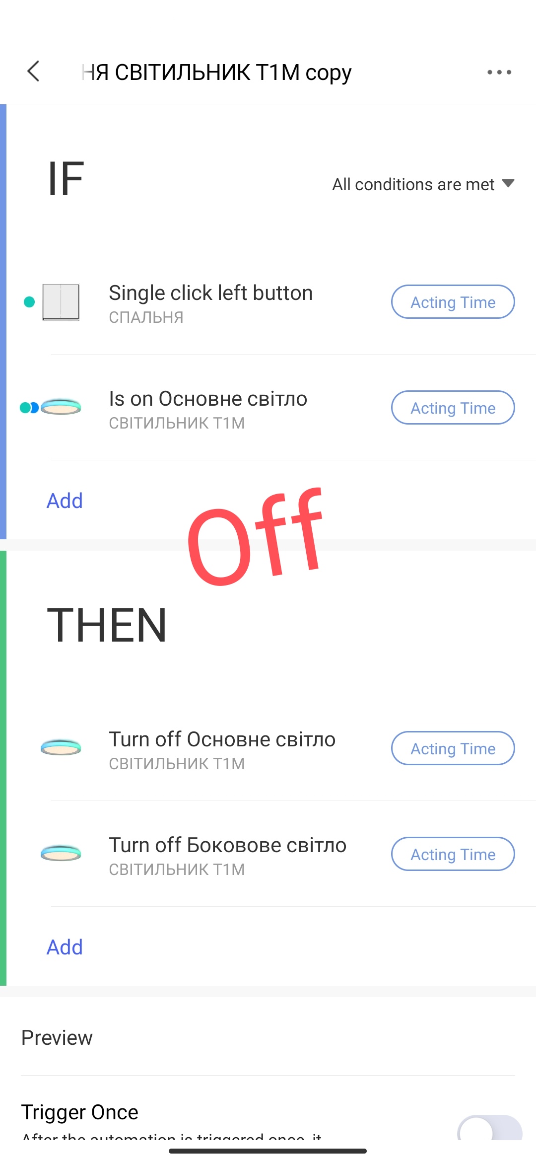

This is how I’m organized.
Note that to turn off T1 I do not turn off the wall switch (H). I only turn it on (the switch) in case I accidentally turned it off from the program.

The scheme works 100%. I have been using it for two years.

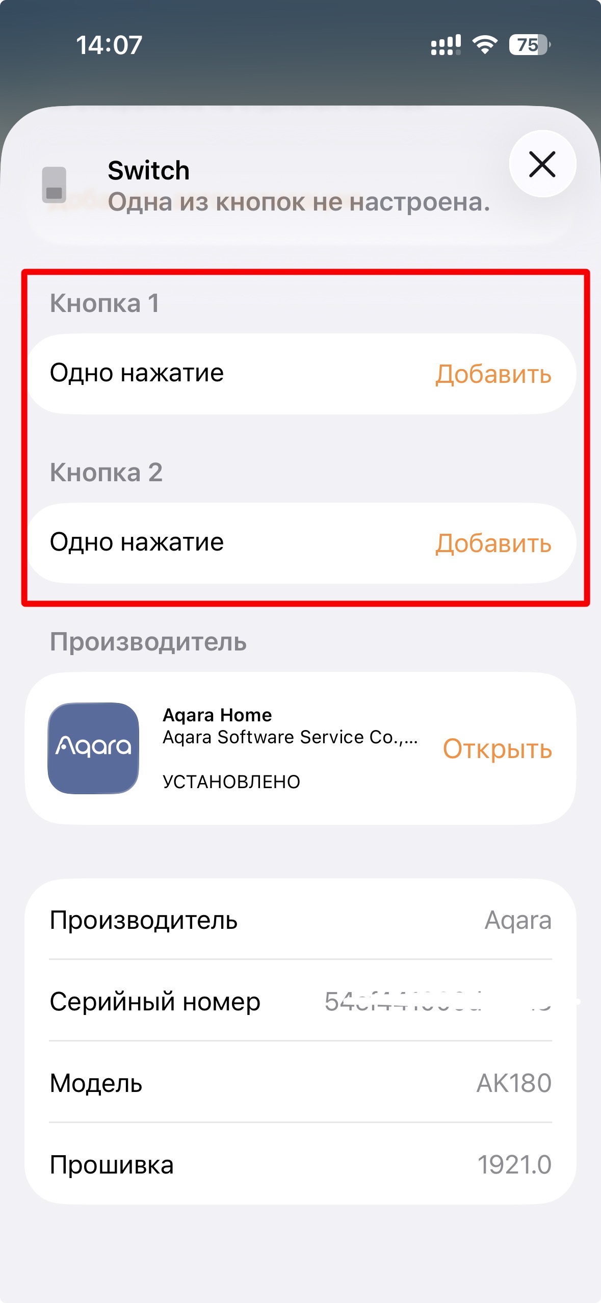

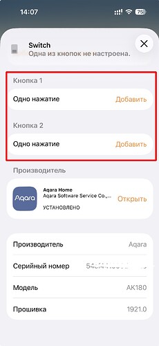

Thanks. I am using an Aqara Smart Light Switch with neutral cable.
The problem is that the Apple Home App doesn’t recognize the switch as a button, but as a switch. So it doesn’t have the option to set it up for single, double or triple press.
