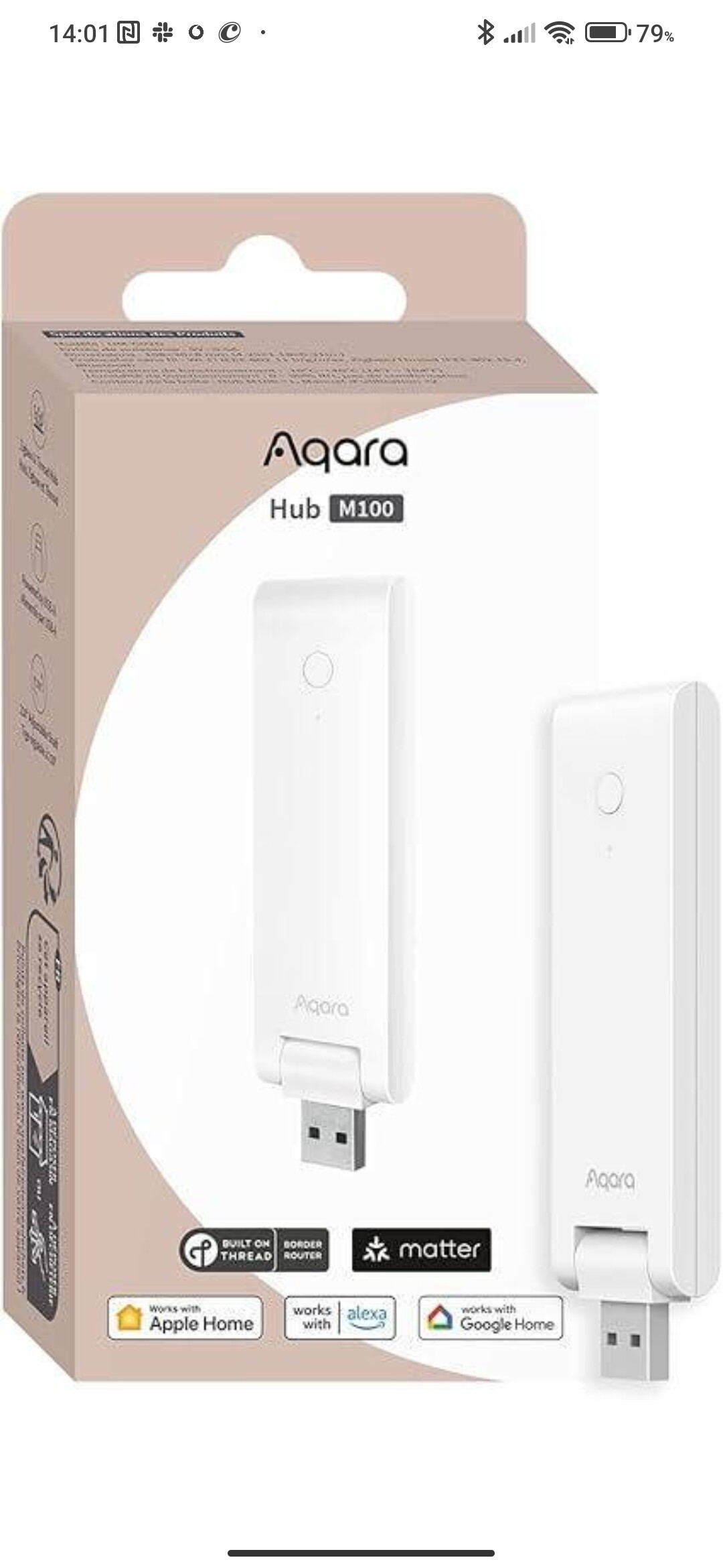

And I read that there were cases when Amazon sold gateways from the Chinese region without indicating the buyer. If possible, return your E1 and buy an M100 gateway.
Be sure to check that it is for the European region.
Such packaging.
Many thanks for the advice. I bought an M100, and now have both it, and the W600, installed successfully to the Aqara app (though I had to update the firmware).
