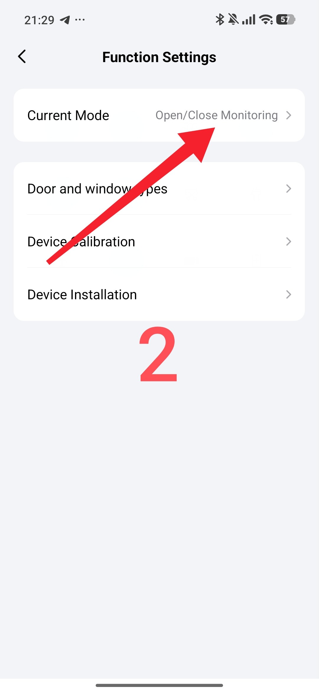

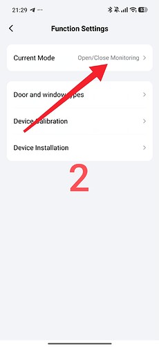

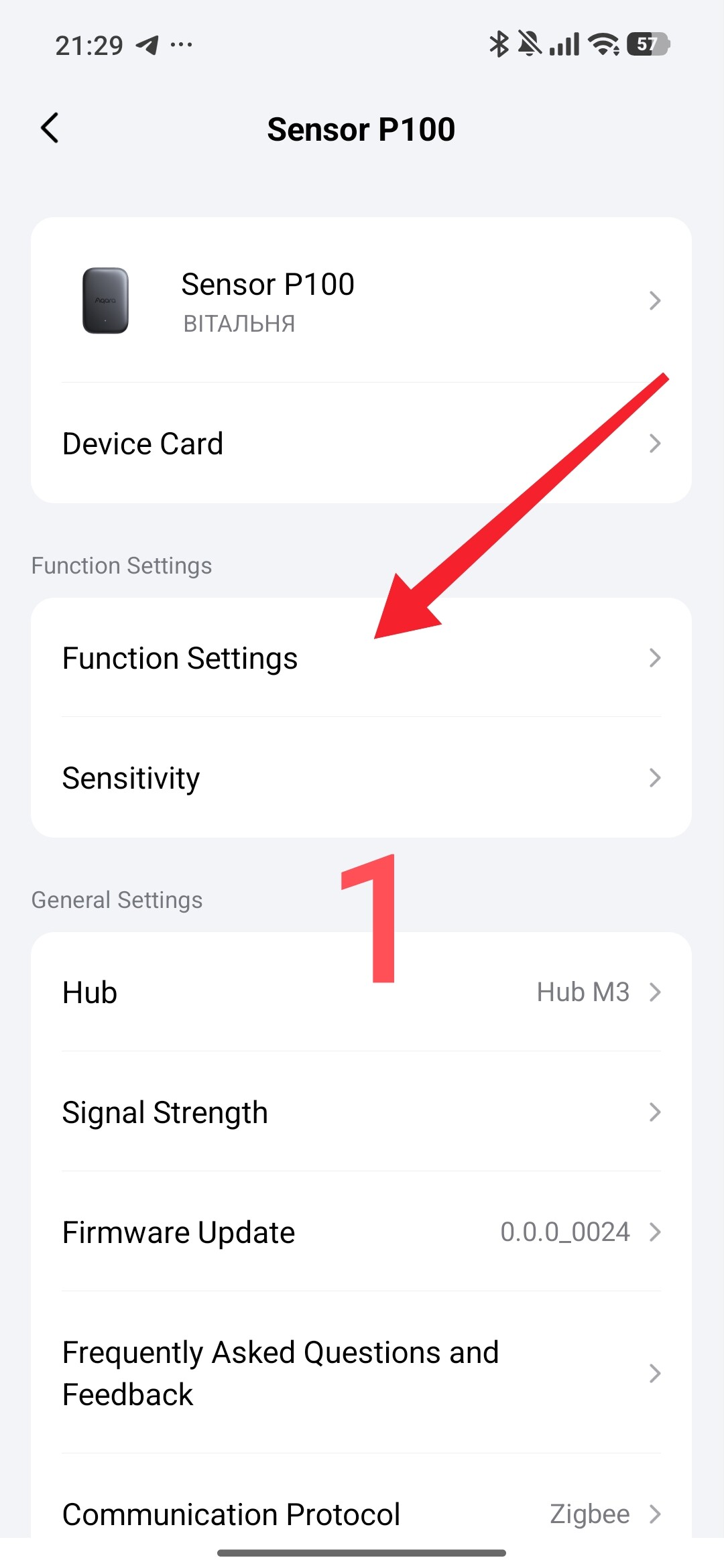

The first part.
We will prepare and configure the P100 sensor (for opening doors (windows) according to your needs.
Fig.1,2,3.

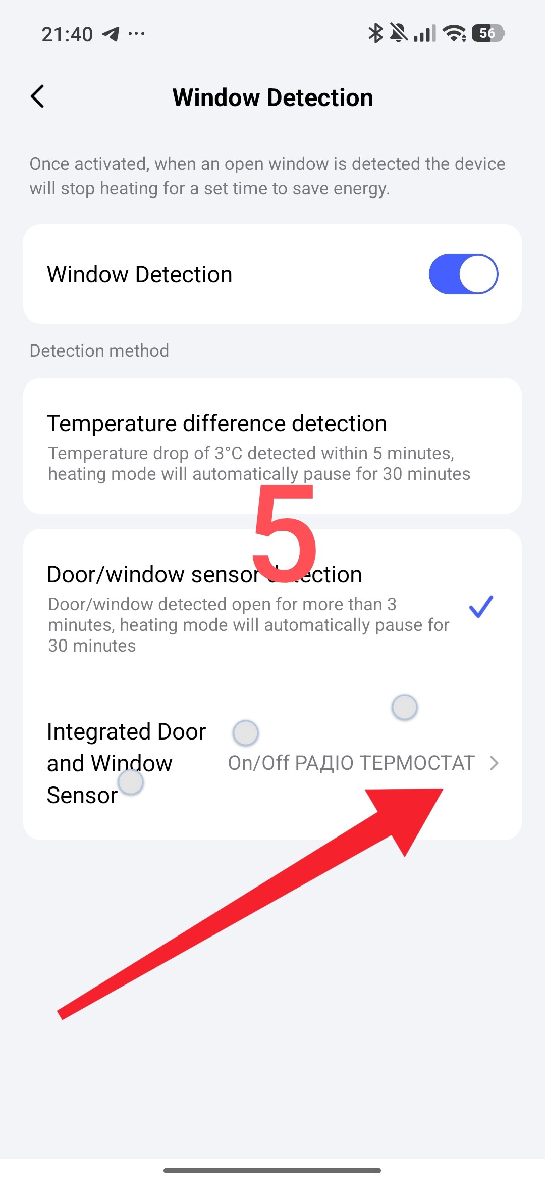

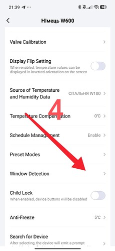

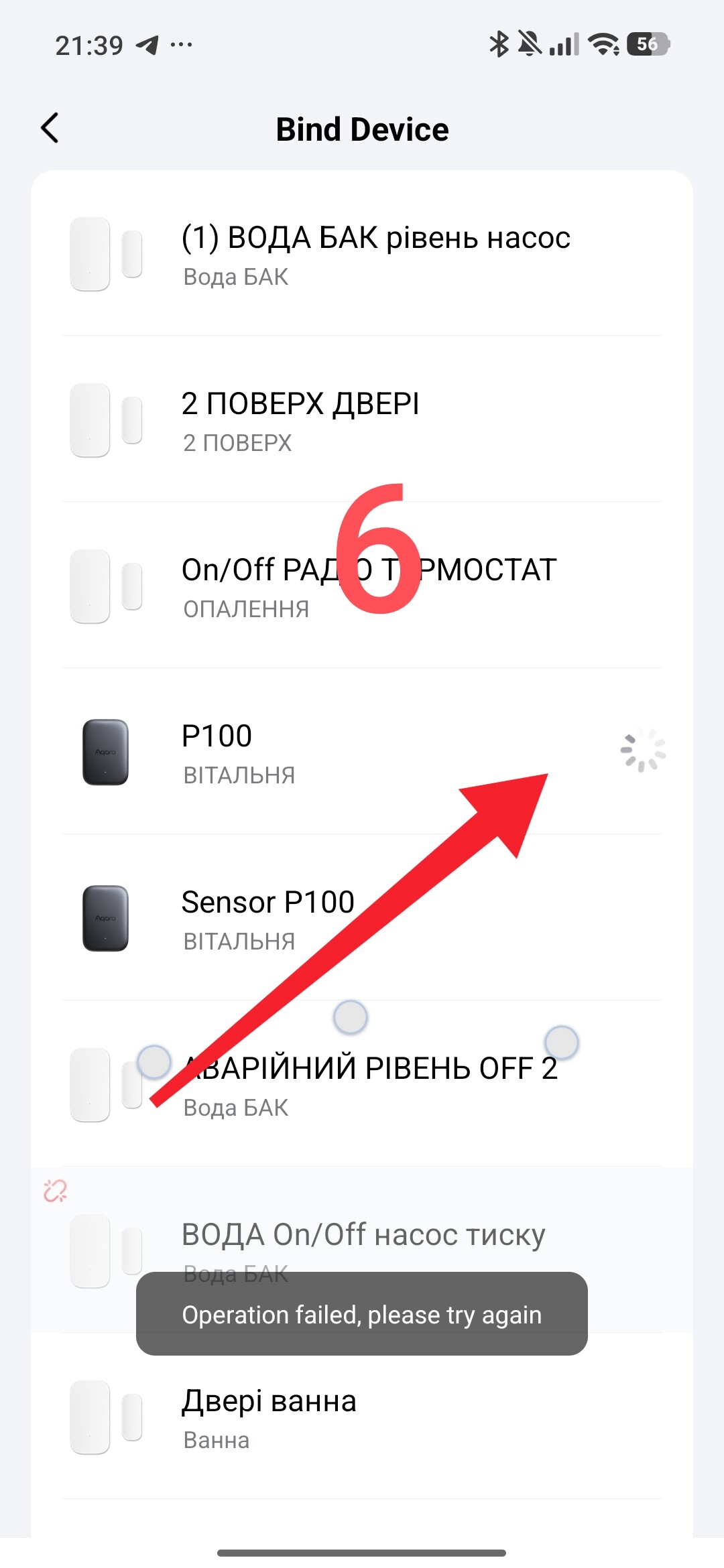

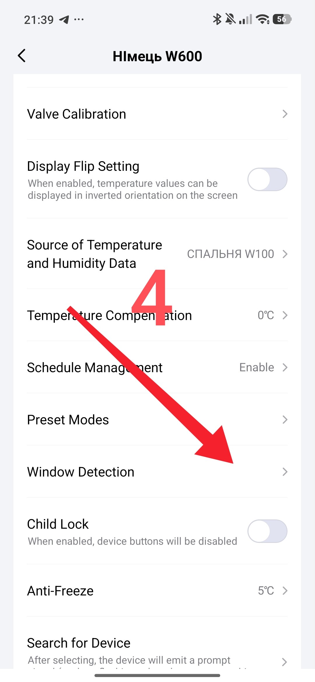

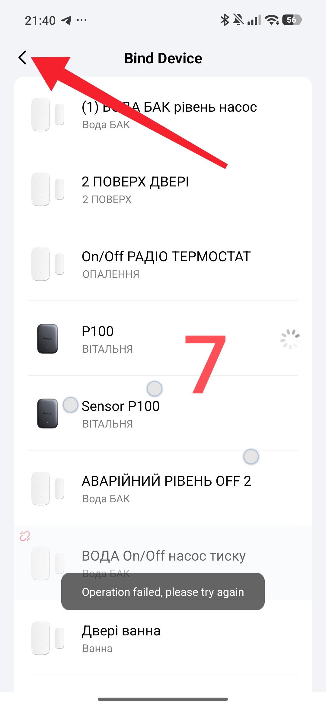

The second part.
We go to the W600 thermostat settings section
Fig.4,5,6,7

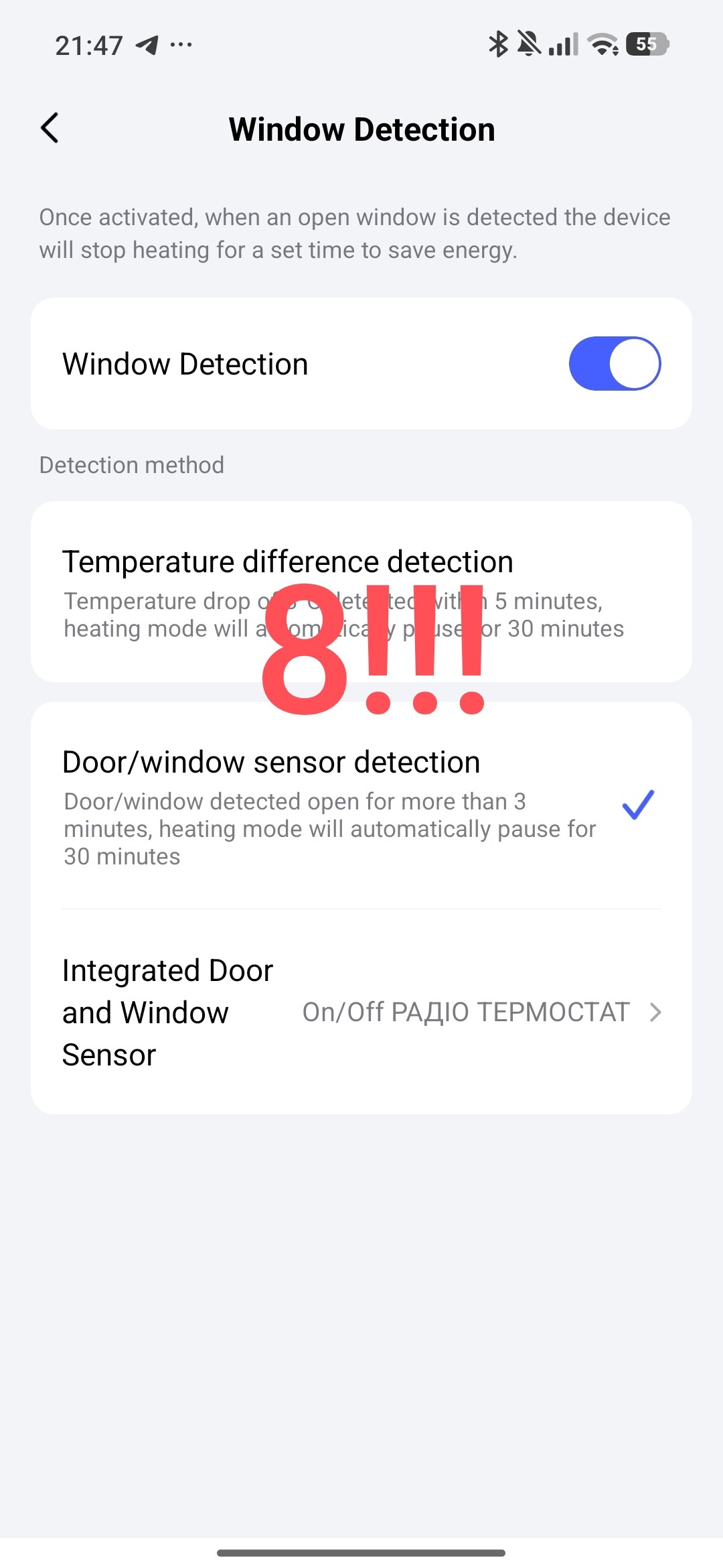

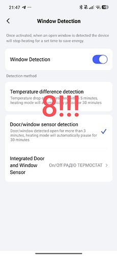

ATTENTION!!! in step 8 ** THREE ** times we press the button on the P100 sensor.
Fig.8.

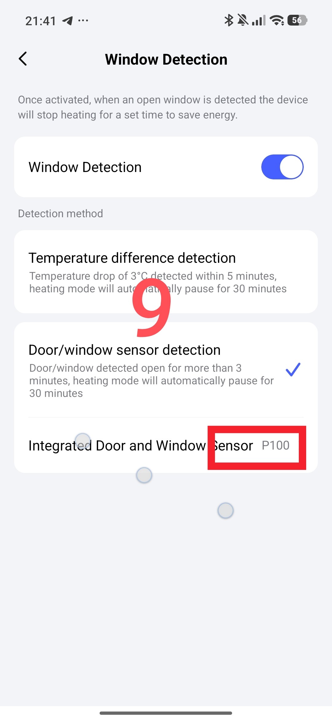

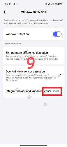

Now we turn on the main W600 window and re-enter the parameters where the opening sensors are.
That’s it, the P100 is bound to the W600.
Fig.9.
