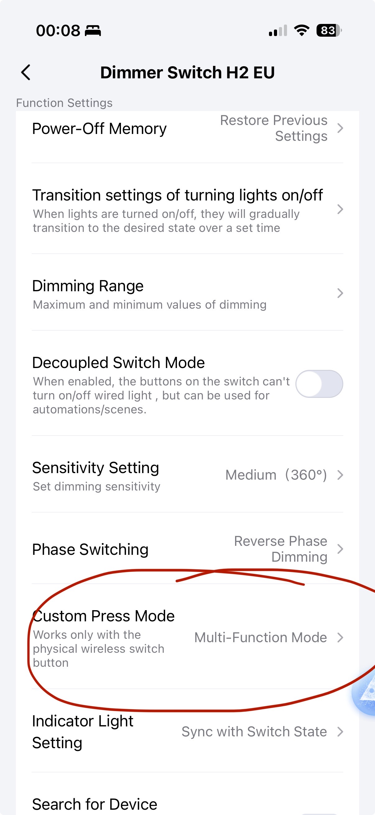

If you’re using Zigbee mode:
To use the knob for automations, first enable multi-function mode in H2 Dimmer Switch EU settings.

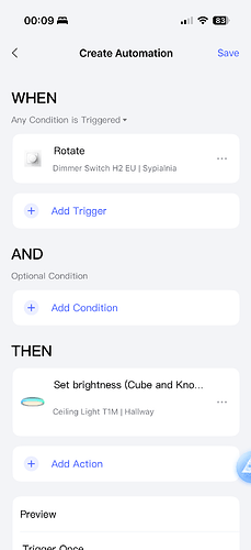

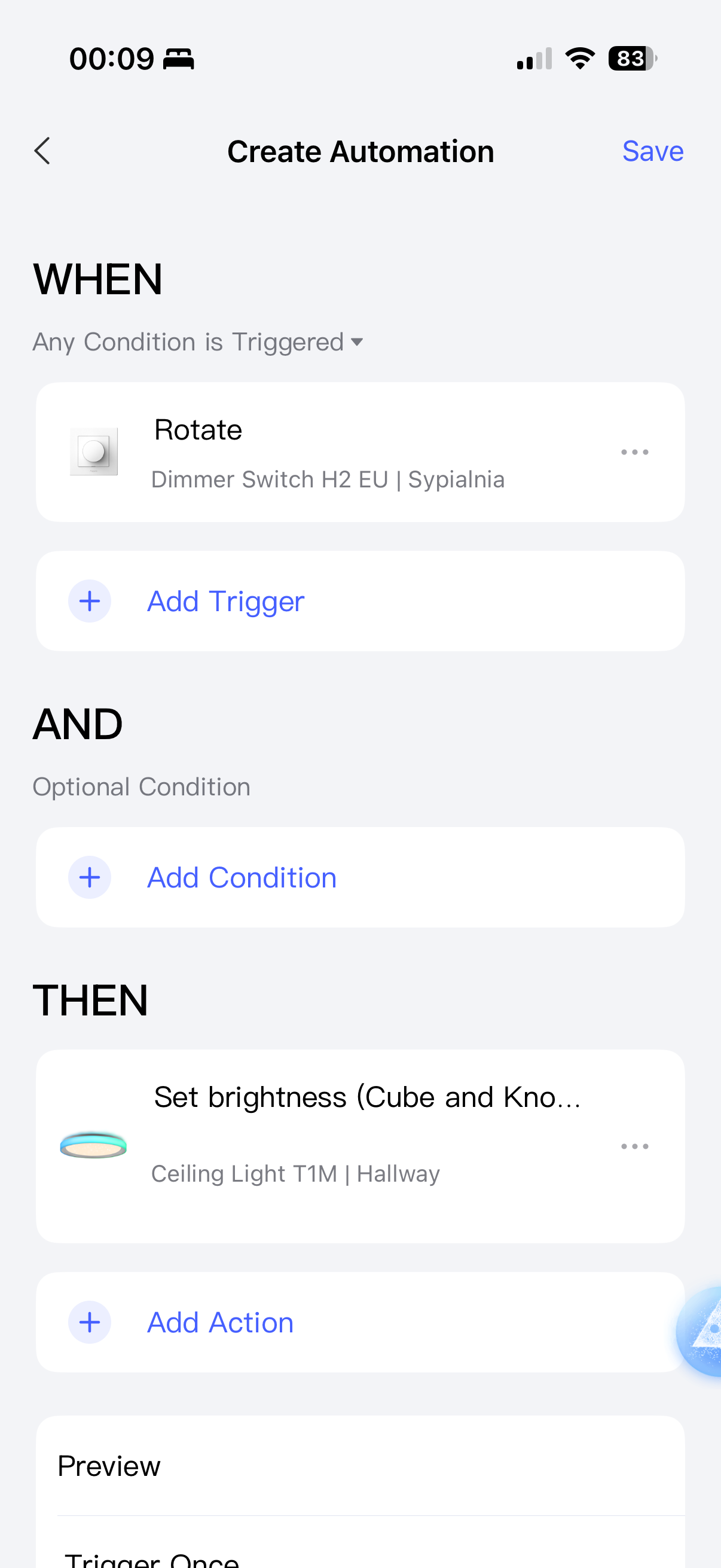

Then you can make an automation like this:
Note: the brightness will change when you stop turning. So you won’t see the change in real time, only when you stop the movement, the dimmer sends the signal how much the knob was turned, and it’s used as brightness delta
