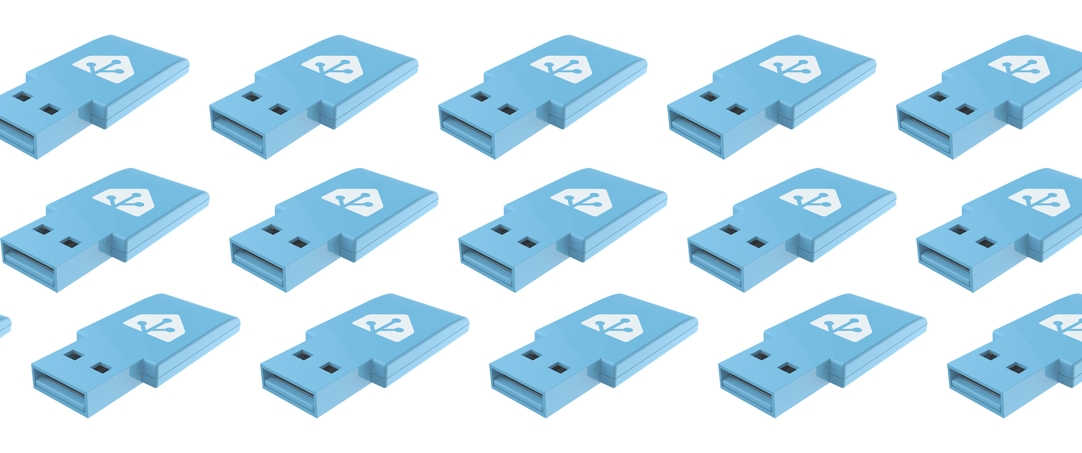

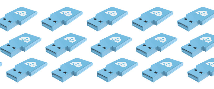

The ZBT-1 doesn‘t work in mixed Mode. You can use it only for Zigbee of for Matter alone, but not both together at the same time. As far as I know, the development for the dual stack firmware stopped some time ago because of some technical issues. Anyway it is a good stick for Zigbee or Thread usage and also recommended for thismuse case.
You can read about this here:
Multiprotocol will remain an experimental feature and is not recommended for use.
