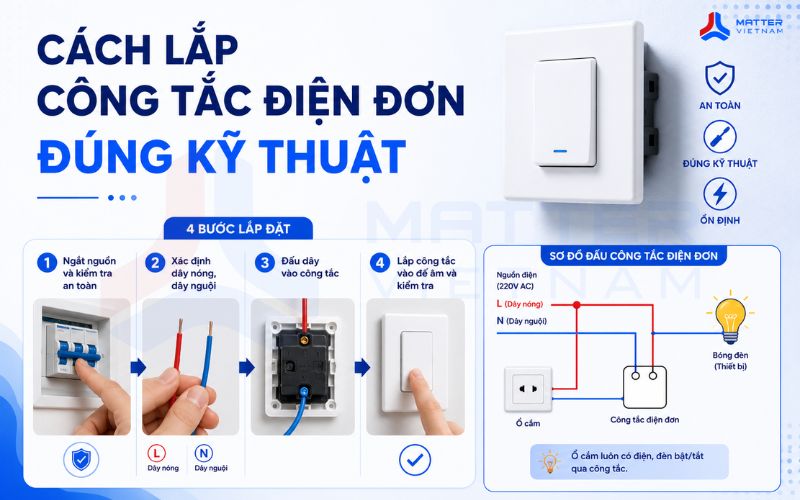

I also came across this article that explains the overall idea quite well:
