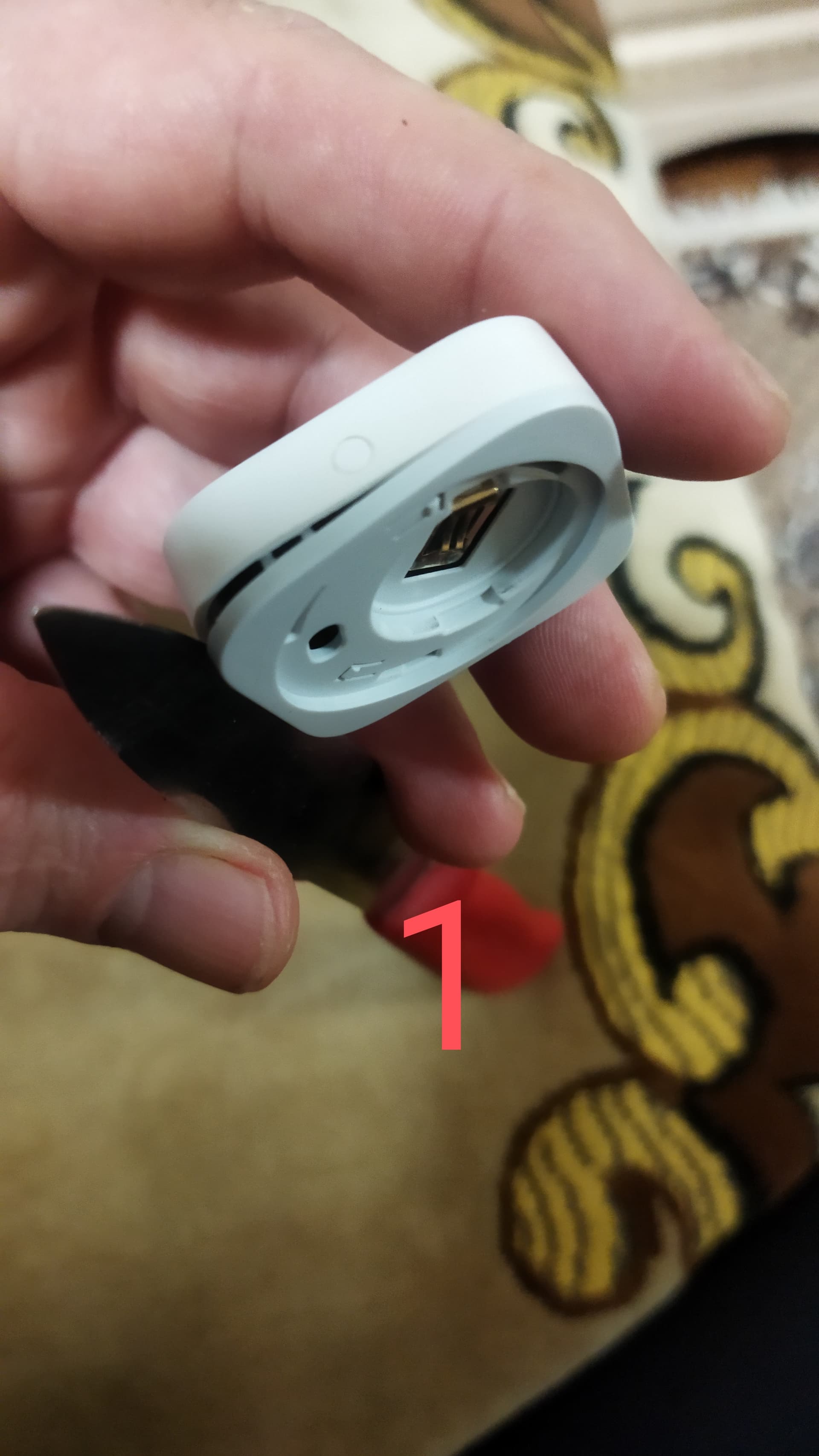

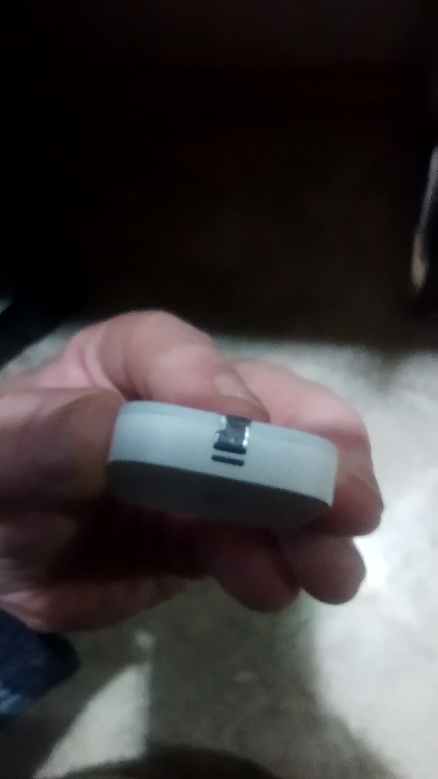

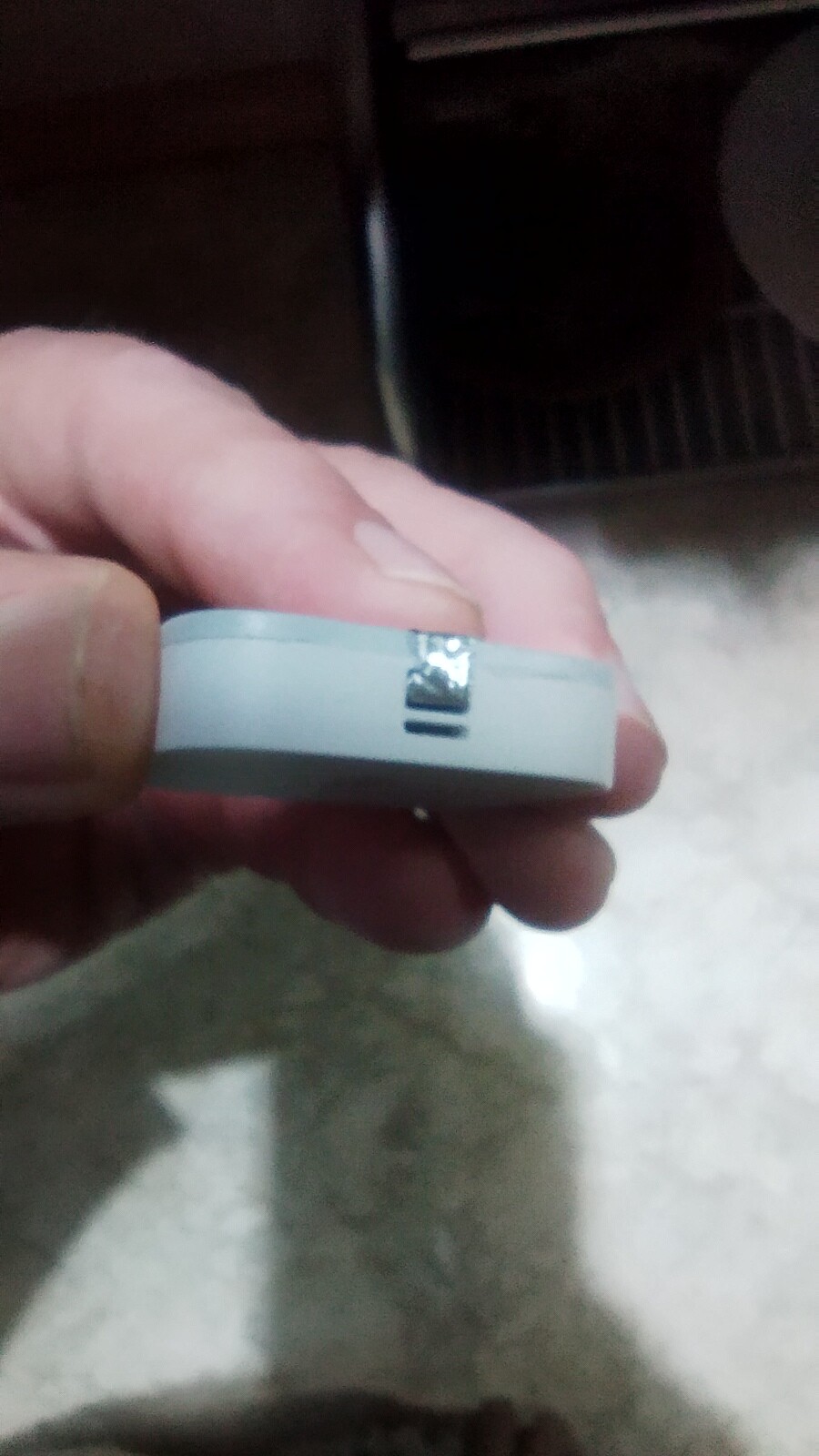

Today I opened the sensor. As you can see from the picture, it’s quite easy to do.
Fig1,2
The photo shows the sensor head

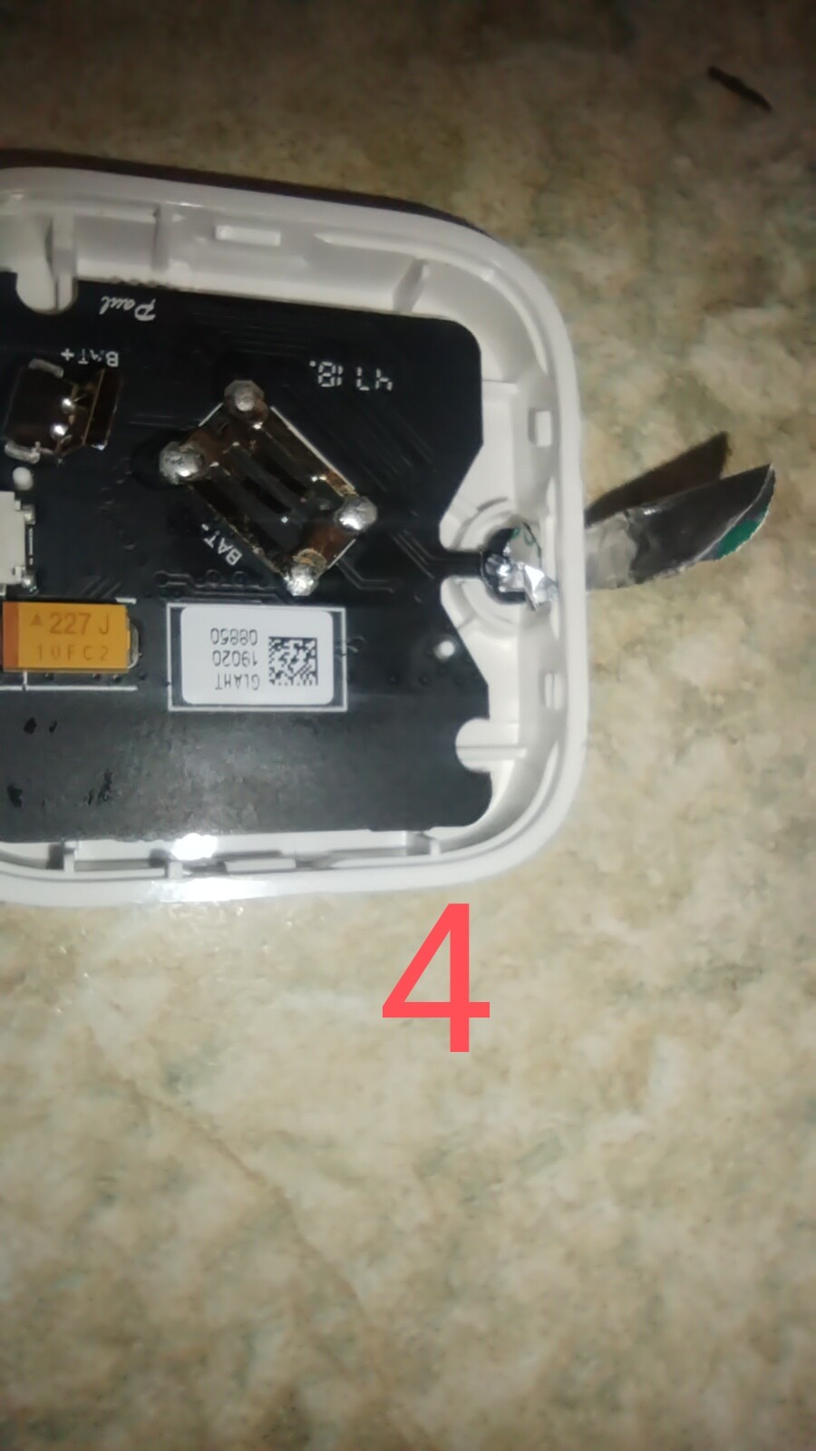

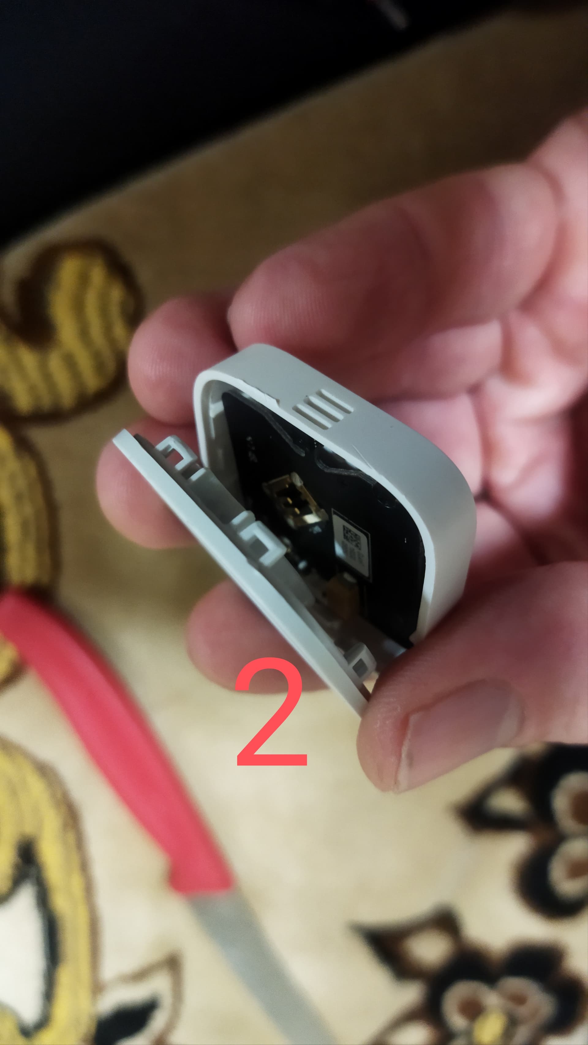

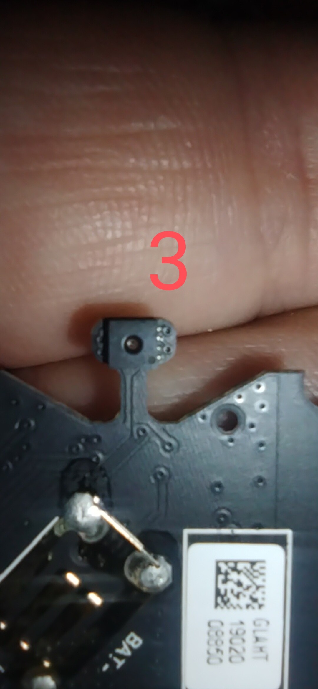

Fig3
I found a small piece of foil at home (peeled off a medicine package) and folded it into a small strip.
  1. Pulled out the board.
  2. Pushed the foil strip into the second hole of the air circulation grille.
  3. Insert the button into the case (it usually falls out when pulling out the board).
  4. Gently push the board so that the temperature sensor is under the foil.
    Fig4
  5. Close the lid and fix the foil on the side of the sensor.

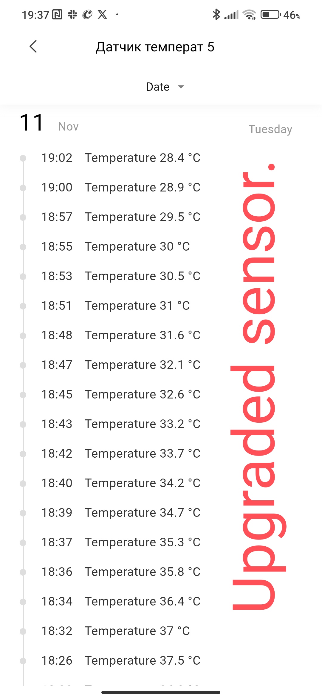

    Fig5,6

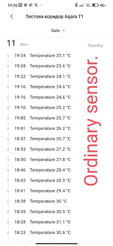

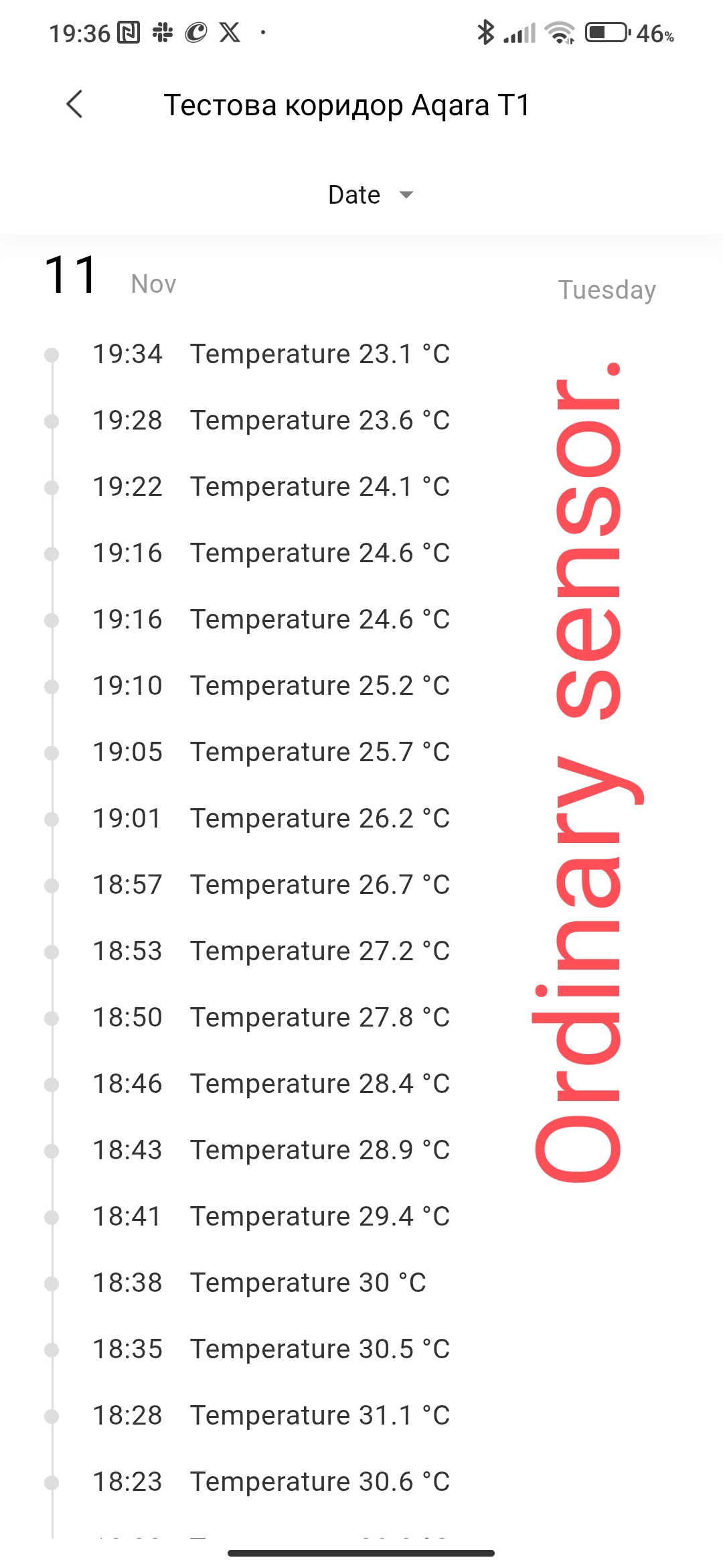

After testing the temperature on the pipe, the accuracy level and response of the sensor changed significantly compared to the normal sensor placed next to it.
I don’t have a pyrometer to compare right now, but the boiler temperature (taking into account the ~15 meter line) is quite accurate, the temperature response increased greatly when heated and decreased greatly when cooled (the pipe takes longer to cool down than the air), the comparison sensor is simply pressed against the pipe. Compare it yourself in the picture.
Fig.
You can experiment yourself, use a slightly thicker foil (I took whatever came to hand).
Conclusion, theoretically you can use a square sensor with this insert (made of foil) as a surface sensor on the pipe.
