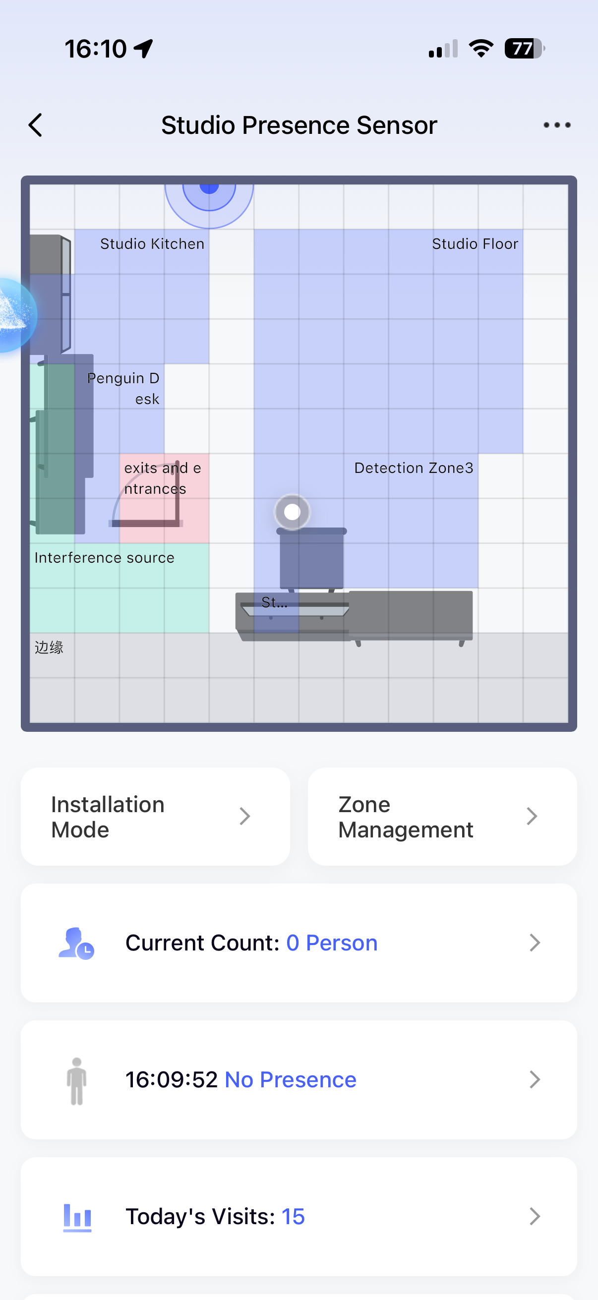

Hi there.how is your zone small or larger?could you post some screenshot of your zone and also how you have the FP2 setup?and here I mean the sensibility and the distance?also did you used the AI detection?
Yes I have AI detection. I have the distance on 2m.
Well that zone is a bit chaotic each zone need to be made with different colors more on the left and right side of that sis you add the walls same like on the bottom that grey area also if your space have more then 2m you need to chose the right distance and detection for the distance you need to chose high not medium and for detection there also need to chose the right one for each.my be try that and see how it goes but as an reference you need to chose different colors for each zone on that space and make automations base on that this way the sensor will detect better base on colors for each zone
