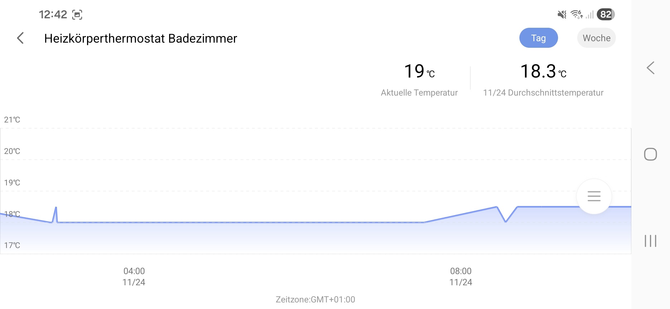

Second: Schedule Problem (Bathroom)
Device: W600 (Offset 0 °C)
Configured schedule (target temperature):
23:00–06:00 - 17 °C
06:00–08:00 - 20 °C
08:00–21:45 - 17 °C
21:45–23:00 - 20 °C
Actual behavior:
Between 06:00–08:00, the thermostat stays at 18 °C, not 20 °C.

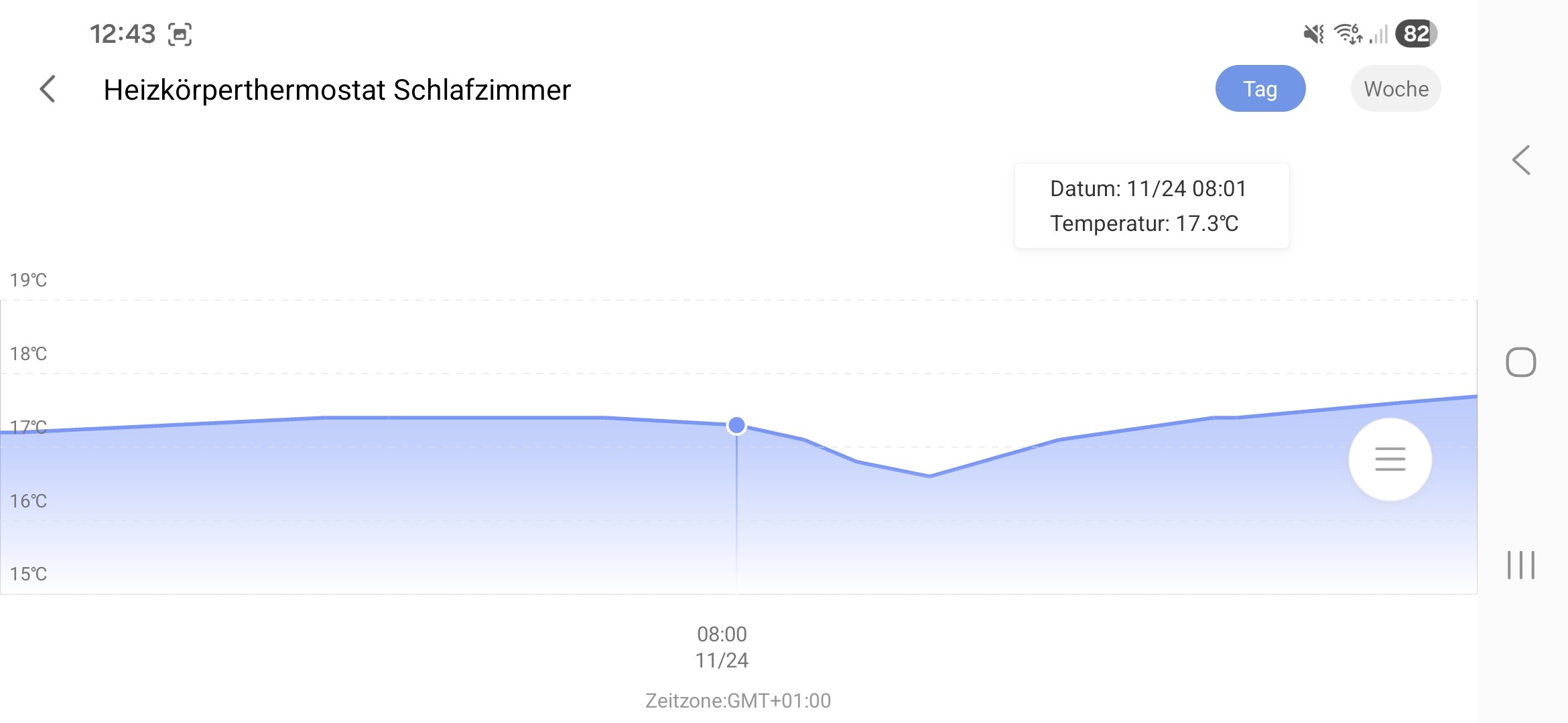

Third: Open Window Detection (very strict?)
According to Aqara’s own description, the open window detection is only triggered if the temperature drops by 3 °C within 5 minutes. This is almost impossible to reach in my opinion, even with fully opened windows so maybe this is a design issue.
Scenario: airing out bedroom and kitchen for 30 minutes, windows and doors completely open, opposite sides (cross ventilation), outside temperature around 3–4 °C.

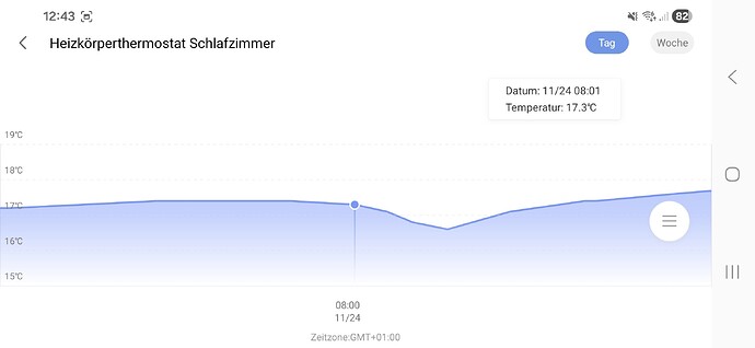

Bedroom:
Devices: W600 (Offset -1 °C) + Temperature/Humidity Sensor
08:01 - 17.3 °C
08:28 - 16.6 °C (–0.7 / –0.9 °C in ~30 min)
Both W600 and the sensor show almost identical values.

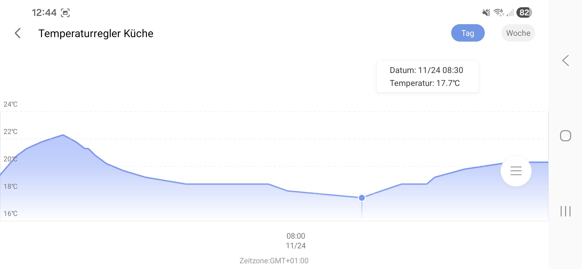

Kitchen
Devices: W600 (Offset -2 °C) + W100
W600 temperature:
08:10 - 16.5 °C
08:24 - 15.5 °C (–1 °C in ~15 min)
W100 temperature:
07:47 - 18.7 °C
07:55 - 18.2 °C
08:30 - 17.7 °C (–1 °C over ~45 min / –0.5 °C over ~30 min)
W100 humidity:
08:05 - 56.7 %
08:18 - 50.6 % (–6.1 % in ~15 min)
I think there should be more options/adjustable settings in the window open detection.

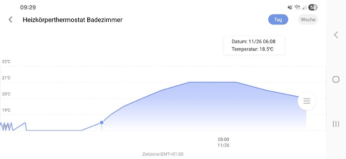

In the bathroom, following the recommendation from Aqara support, I changed the offset from 0 °C to -0.5 °C, and I also increased the scheduled temperature from 20 °C to 21 °C.
This morning I observed the following values:
05:49 – 18.5 °C
06:08 – 18.5 °C
06:45 – 20.0 °C
07:30 – 21.0 °C
It therefore took around 1.5 hours to reach the target temperature, which feels a bit long to me considering that this is a very small room. I will check this again with an external sensor to verify the readings and I might also try -2.5 °C there as well.

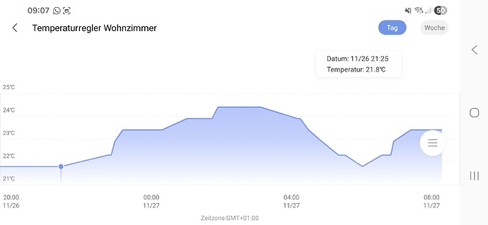

Update after further testing
In the living room (W600 with -2.5 °C compensation), I was able to observe the following values last night, measured with the W100 sensor:
21:25 = 21.8 °C
22:51 = 22.3 °C
23:10 – 00:18 = 23.4 °C
01:01 – 01:44 = 23.9 °C
01:54 – 03:07 = 24.4 °C
04:10 = 23.9 °C
05:20 = 22.3 °C
06:01 = 21.8 °C
Overall, the behaviour looks better than before.
However, it seems like to go in the other way (overshot) now, even though the temperature stayed around ~22 °C for a while, the thermostat later heated up to 23.0–24.0 °C, and then even 24.5 °C for a longer period without any change in setpoint.
As a next step, I will compare the current behaviour in the living room with my previous (old) thermostats, to see whether this is specific to the Aqara regulation or related to the heating system itself.

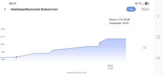

Bathroom – schedule issue + external sensor verification
Yesterday I also encountered a new issue:
The scheduled temperature (21:45 – 23:00 = 21 °C) did not activate.
At 22:00 it still showed 17 °C in the app, and only after switching to manual mode and then back to schedule mode did it recognise the correct setpoint.

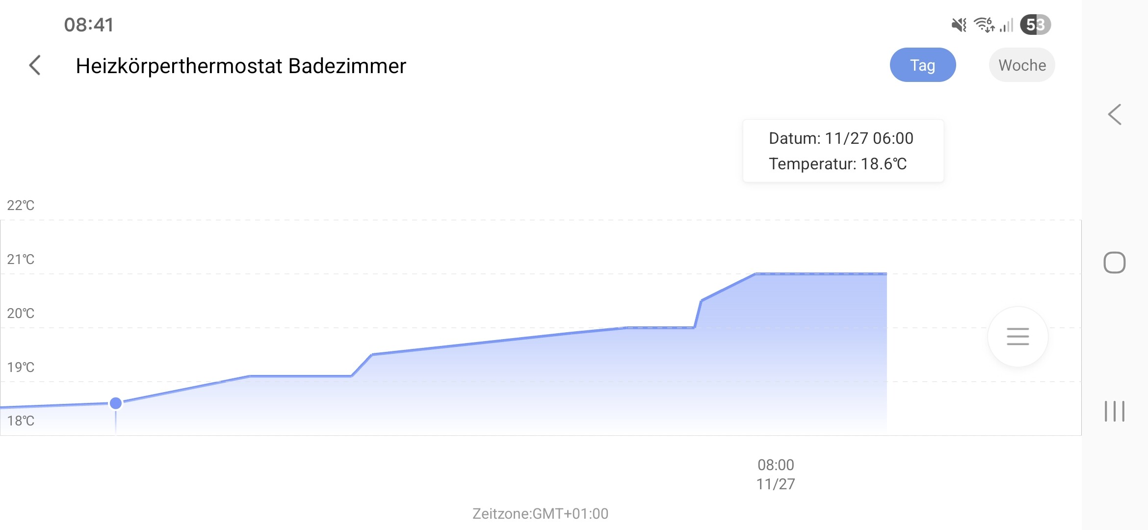

I also checked the temperature with an external sensor, and it confirms the data from the W600:
Schedule 06:00 – 08:00 = 21 °C
06:00 = 18.6 °C
06:24 = 19.1 °C
06:45 = 19.5 °C
07:33 = 20.0 °C (1.5 hours for +1.4 °C)
07:46 = 20.5 °C
07:56 = 21.0 °C (30 minutes for +1 °C – doors closed)
Is such a “slow” temperature increase, especially in a very small room considered normal behaviour for the W600?
