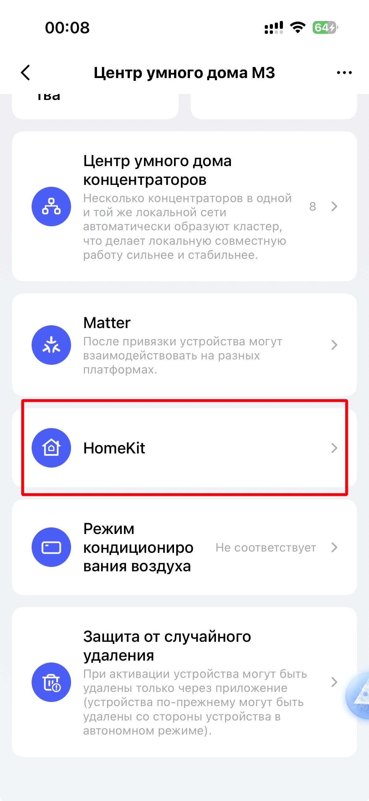

    • This is not forwarded to Homekit via Matter, you need to connect the M3 hub via the Homekit code in the Apple home app.

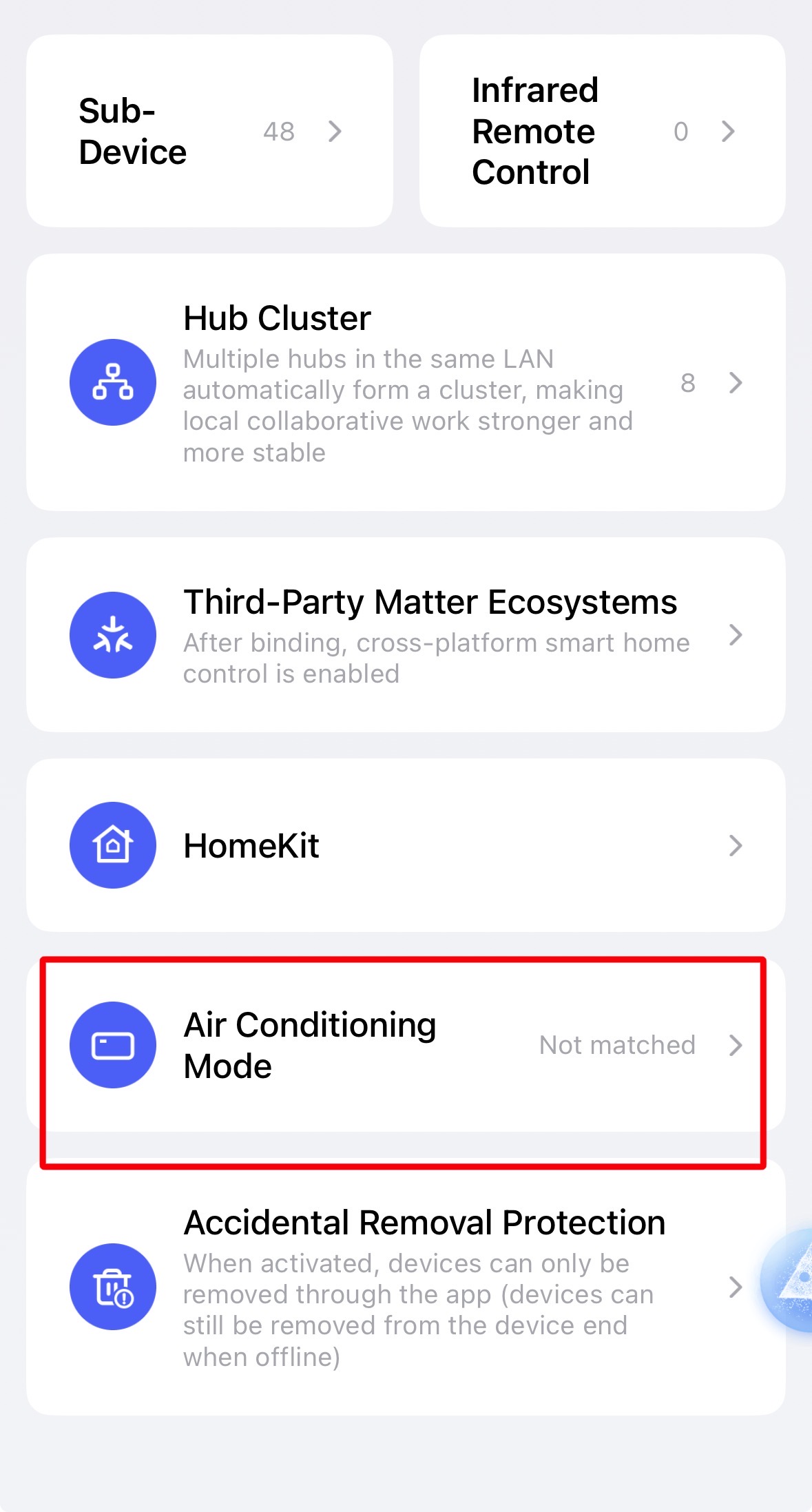

    • You need to add an air conditioner to the m3 via the item - air conditioning mode and not via IR remote controls. And add the M3 to Homekit via the HK code and not via the Matter code.
