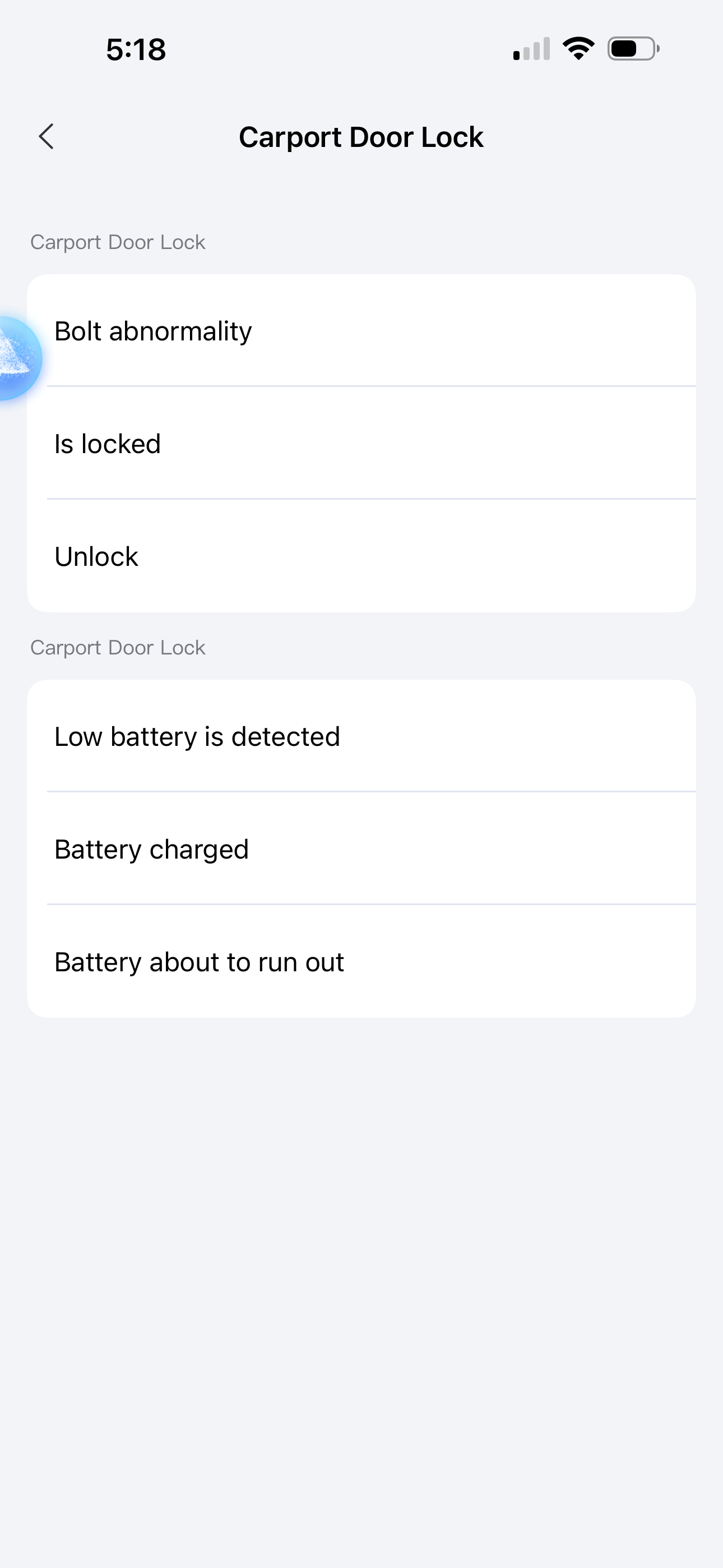

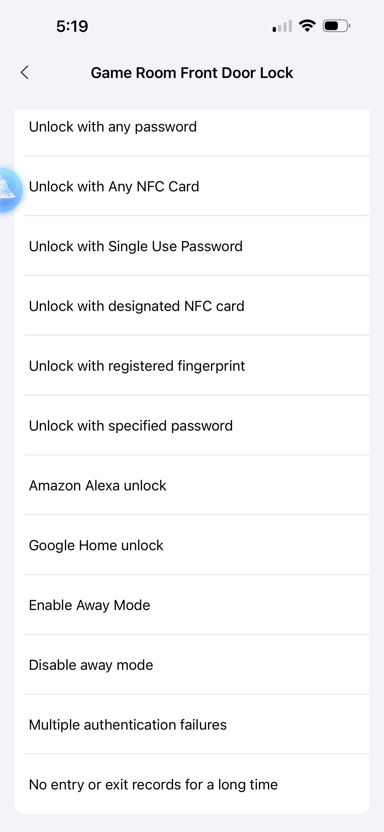

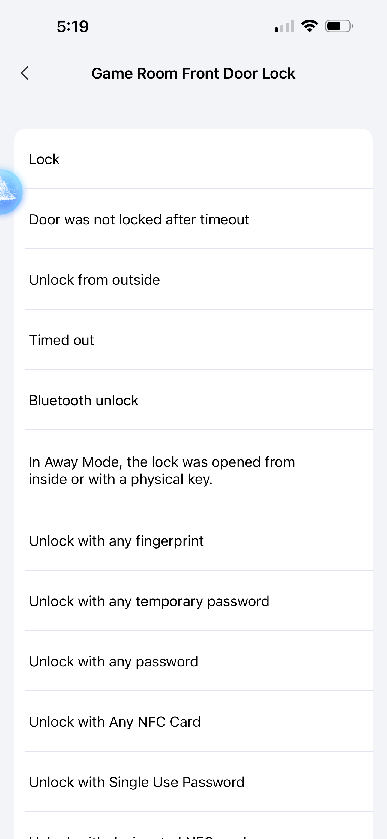

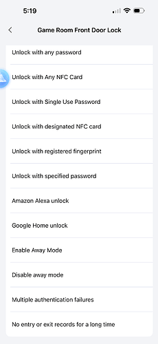

Did this exact comparison on my own locks — my U100 (Zigbee) shows about 20 different trigger options in the Aqara app: broken out by unlock method (password, NFC card, fingerprint, Bluetooth, Alexa, Google Home), Away Mode on/off, door-not-locked alerts, failed-login alerts, stuff like that. My U400 (Matter/Thread) only gives me 6: bolt abnormality, locked, unlocked, and three battery states. Nothing broken out by how it was unlocked, no Away Mode, no alerts.
Matter (the smart-home standard the U400 uses to talk to Apple/Google/etc.) only defines a pretty bare-bones set of lock states out of the box — basically locked/unlocked/jammed. That’s likely why the list is so short. But here’s the interesting part: my U100 can also be reached over Matter, and it still shows all 20 options in the Aqara app. So it’s not that using Matter kills the extra triggers — it’s more that Aqara hasn’t built out the same detailed trigger list for their newer Matter-based locks yet that they already have for their Zigbee ones. Nothing says they couldn’t add it later, they just haven’t for the U400 so far. Might be worth sending Aqara direct feedback asking for it — doesn’t seem like something wrong on your end.

U400:
U100:
