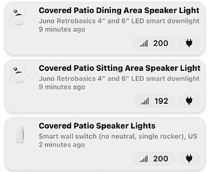

A couple of years ago, I installed a pair of Juno Speaker Lights on my patio. They’re awesome—color-changing lights with built-in Bluetooth speakers. I was excited to bring them into my smart home setup, but I quickly ran into two major issues.
First, the manufacturer told me the only supported smart home ecosystem was SmartThings. That was limiting, but I made it work. The bigger problem was power. These lights need constant power, but they were wired to a standard wall switch. Every time someone flipped the switch, the lights lost power, went offline, and if left off too long, became unresponsive—forcing me to re-add them from scratch. Not exactly “smart.”
I dealt with that setup for nearly two years. I looked into switch covers, smart buttons—nothing felt clean or practical for a shared household.
Then things started to click.

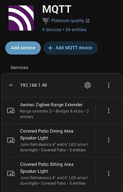

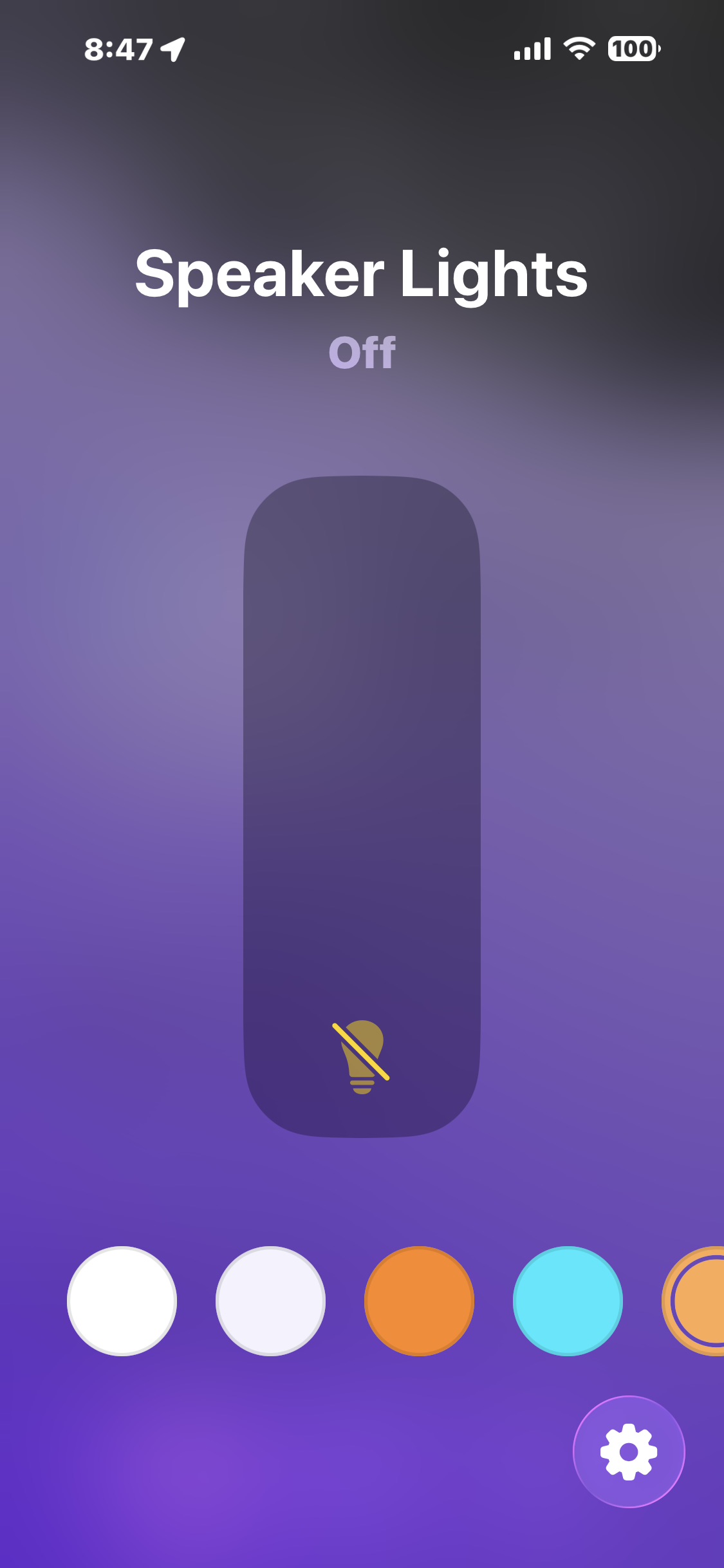

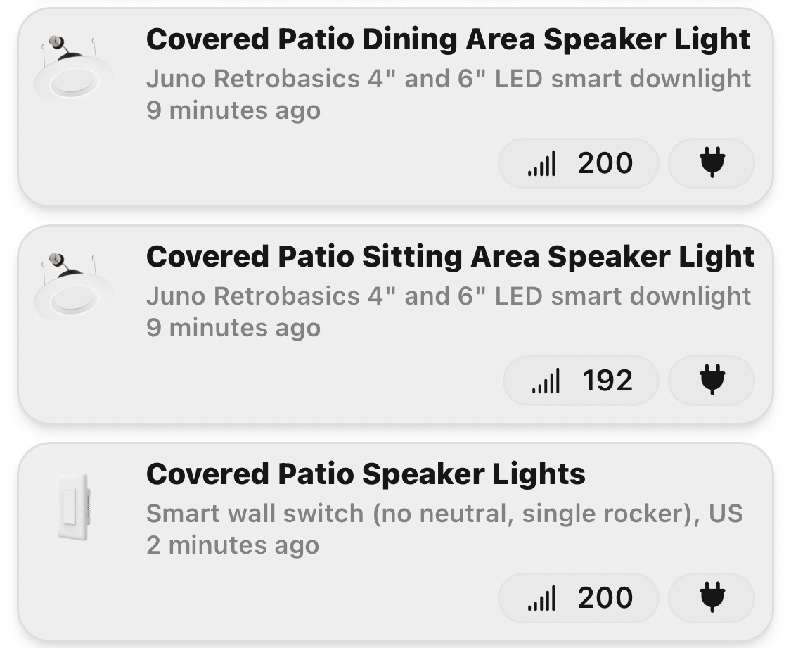

I discovered I could bring the speaker lights into Home Assistant using Zigbee2MQTT and a Zigbee coordinator. That alone was a huge step forward. I grouped the lights and exposed them to HomeKit, finally making them part of my broader ecosystem.
But the wall switch problem still remained.
That’s when I realized what I actually needed: a wall switch that acts like a smart button—something that doesn’t cut power, but still lets anyone walk up and control the lights.
Enter Aqara.

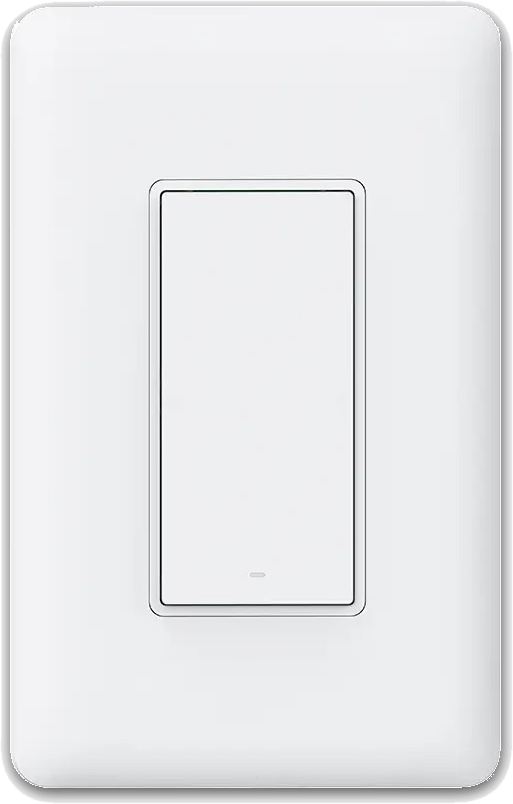

The Aqara Smart Wall Switch (no neutral, single rocker) turned out to be exactly what I needed. Three key things made it the perfect solution:

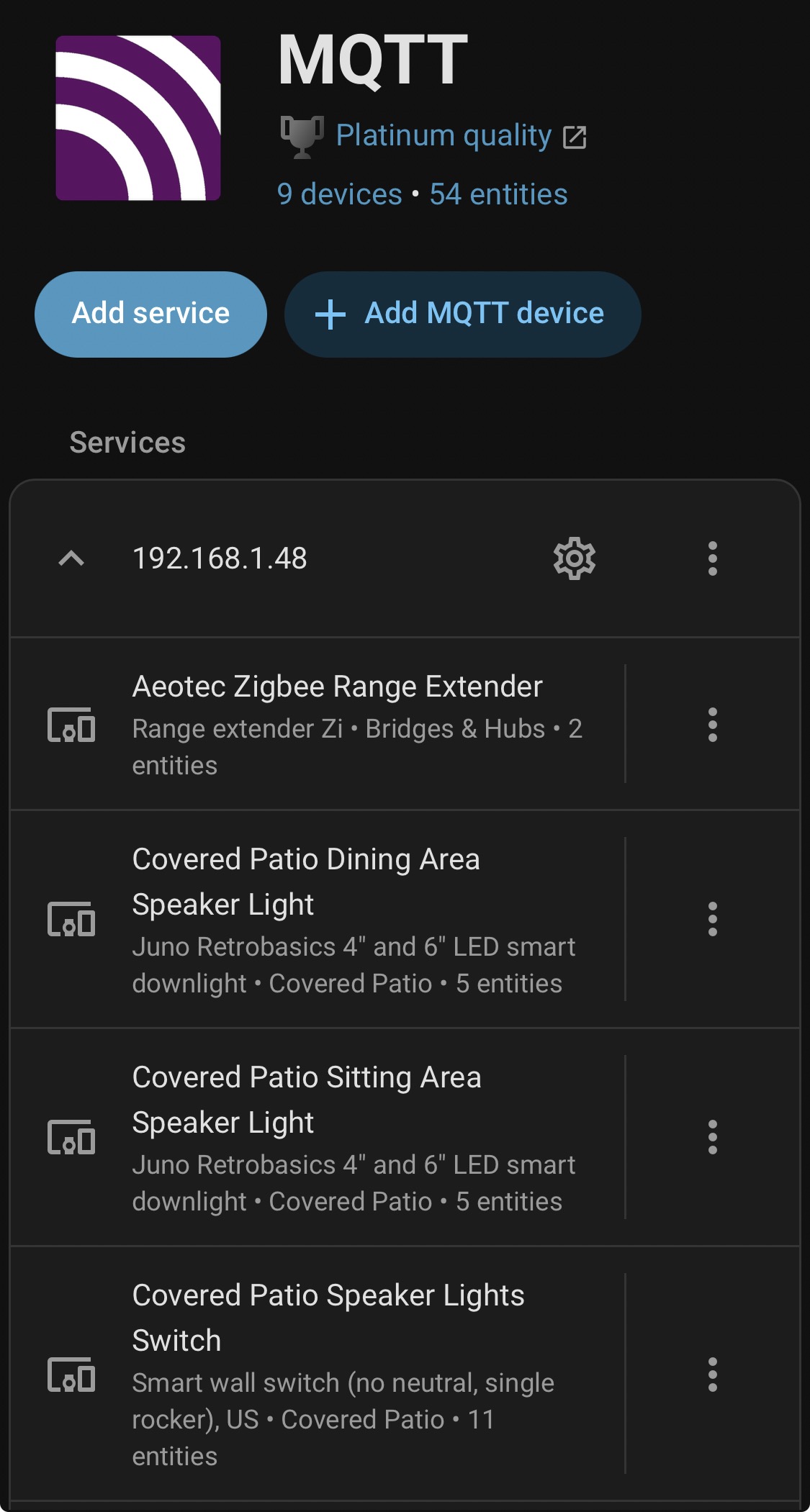

  1. Zigbee compatibility – I added it to Home Assistant via Zigbee2MQTT and exposed it to HomeKit alongside my lights.

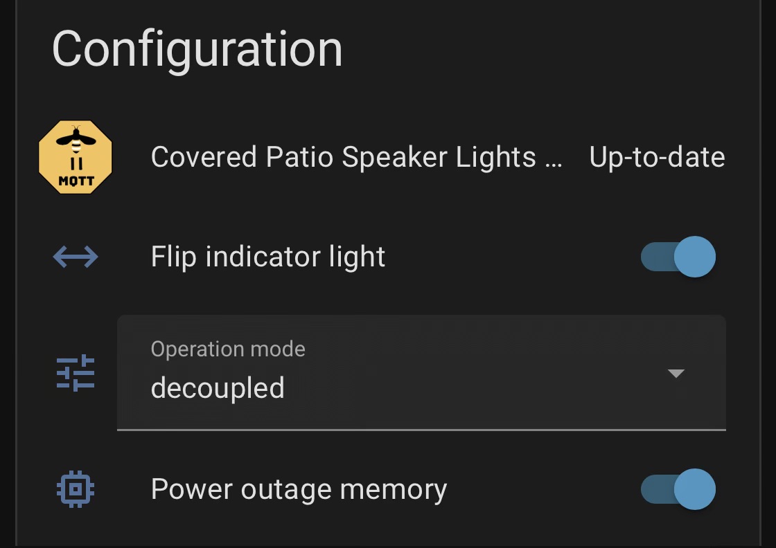

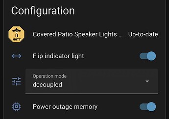

  1. Decoupled Mode – This disables the relay, so the switch no longer cuts power. My speaker lights stay powered 24/7.

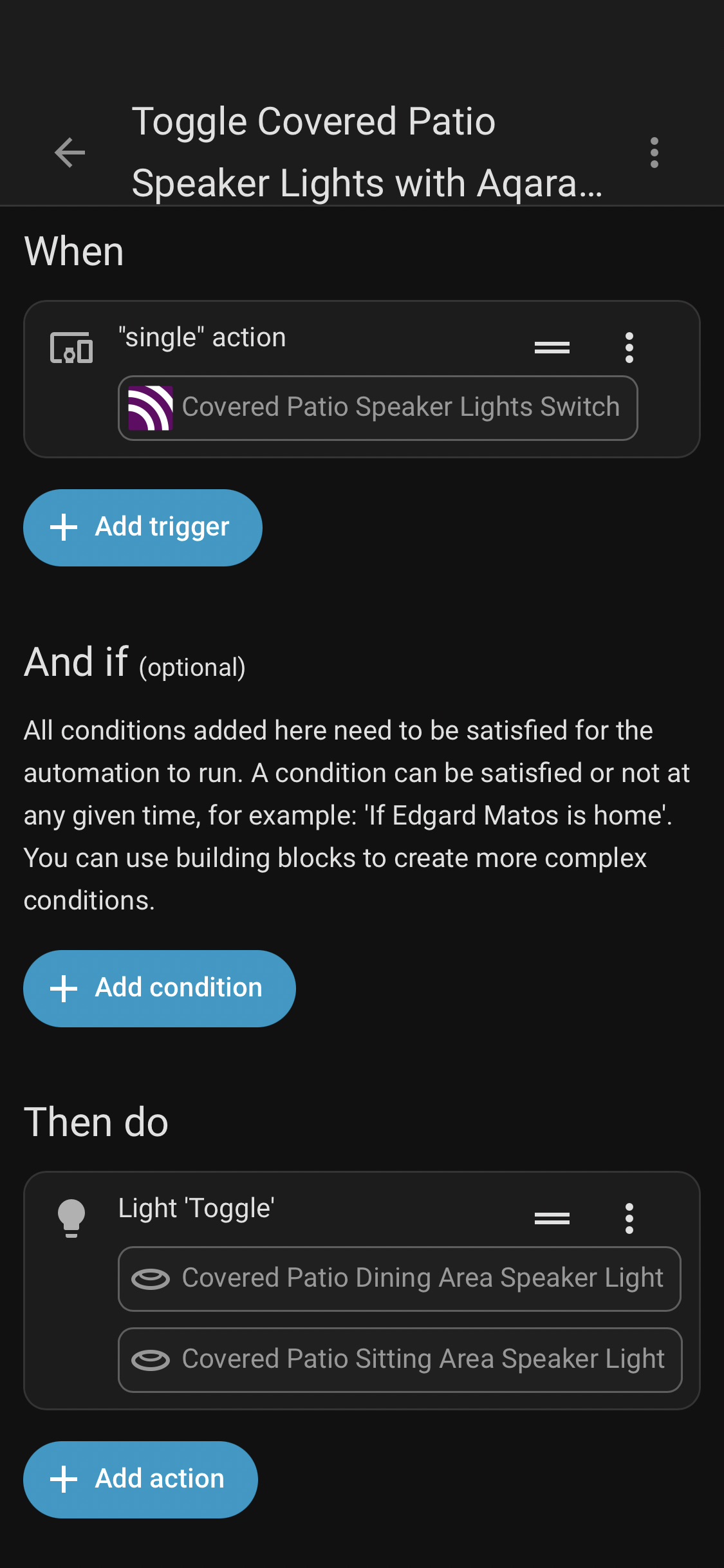

  1. Button event support – The switch press is exposed as an event, which I used to trigger an automation to toggle the lights.

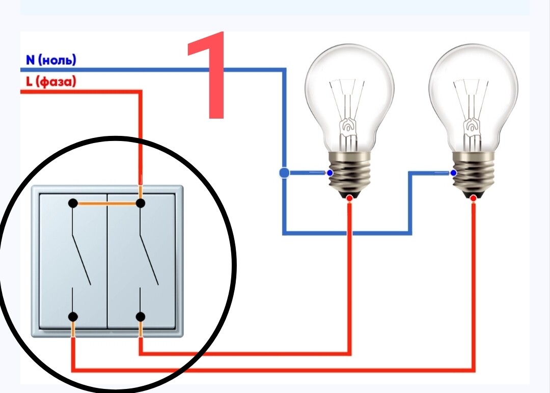

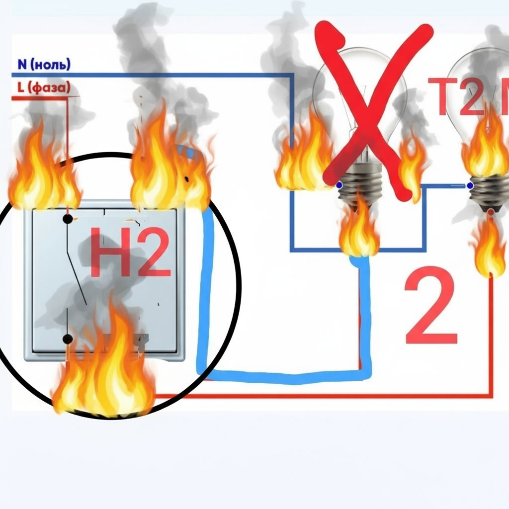

Hello, @_Mevi.

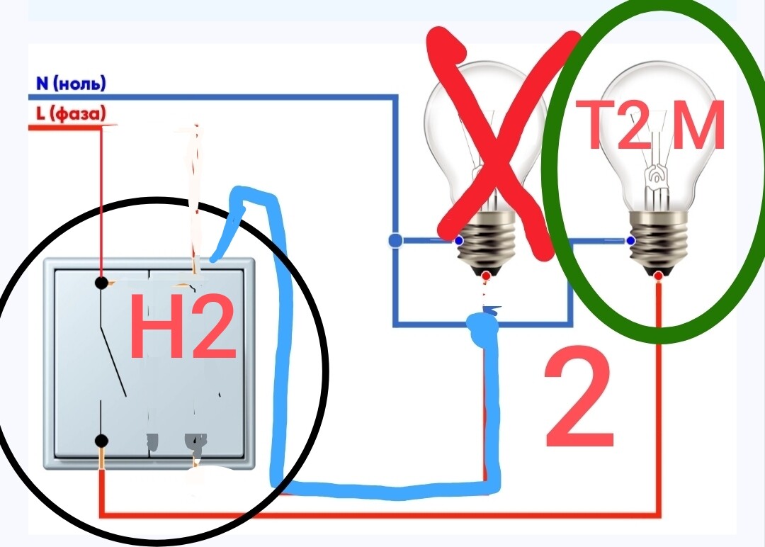

For those who have only a phase wire in the box.
If the switch on the wall controls two lamps in one fixture, you can redo the power circuit and feed the neutral wire into the box with the switch.
Existing power circuit
Fig. 1
Circuit after change.
Fig. 2
I used this principle for all lamps that were controlled by a double switch. Now the smart switch H2 has zero and phase and is connected to the smart lamp T2M Aqara.
@gafich10
It could work in the hallway. Probably safer if it wasn’t me doing the electrical work. :laughing:
