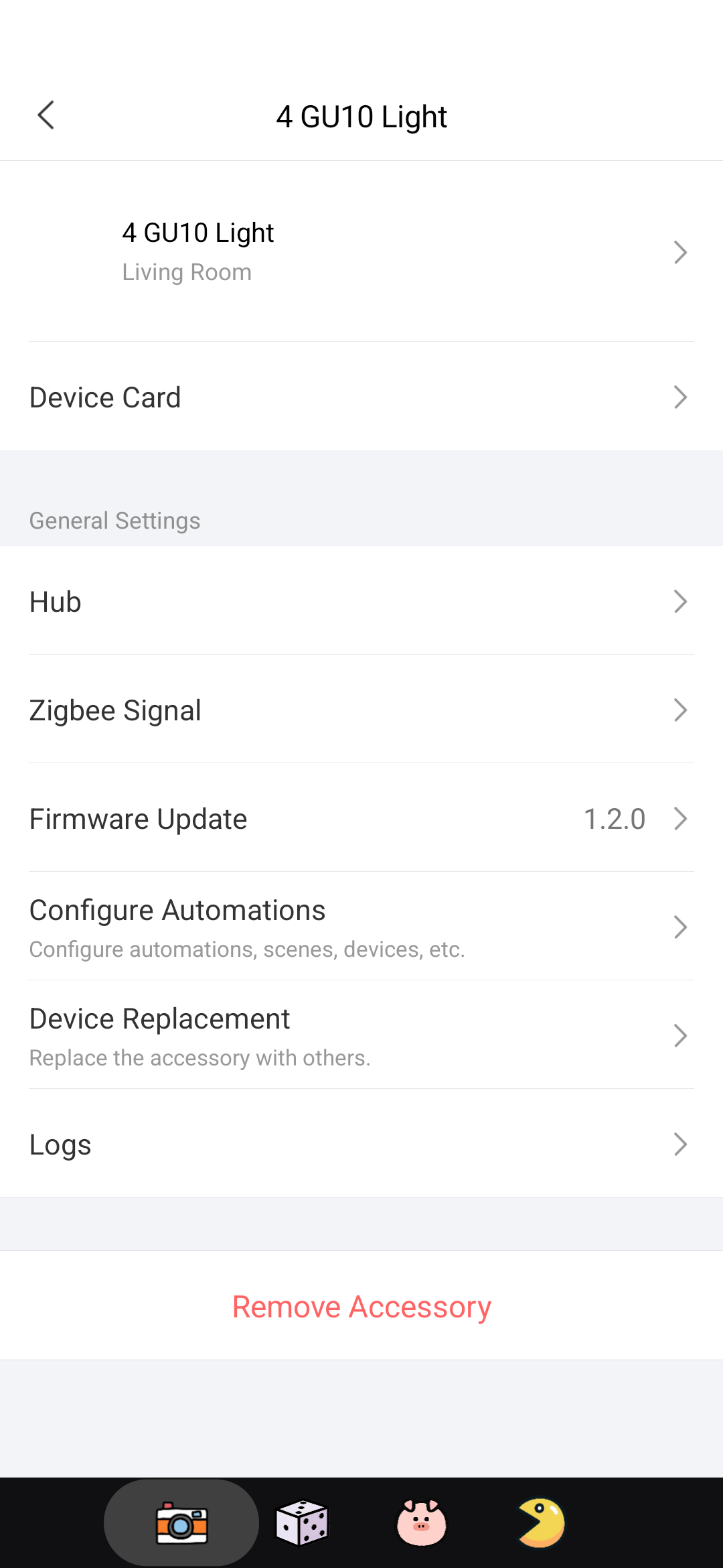

With M100 hub it’s working with IKEA bulbs:
