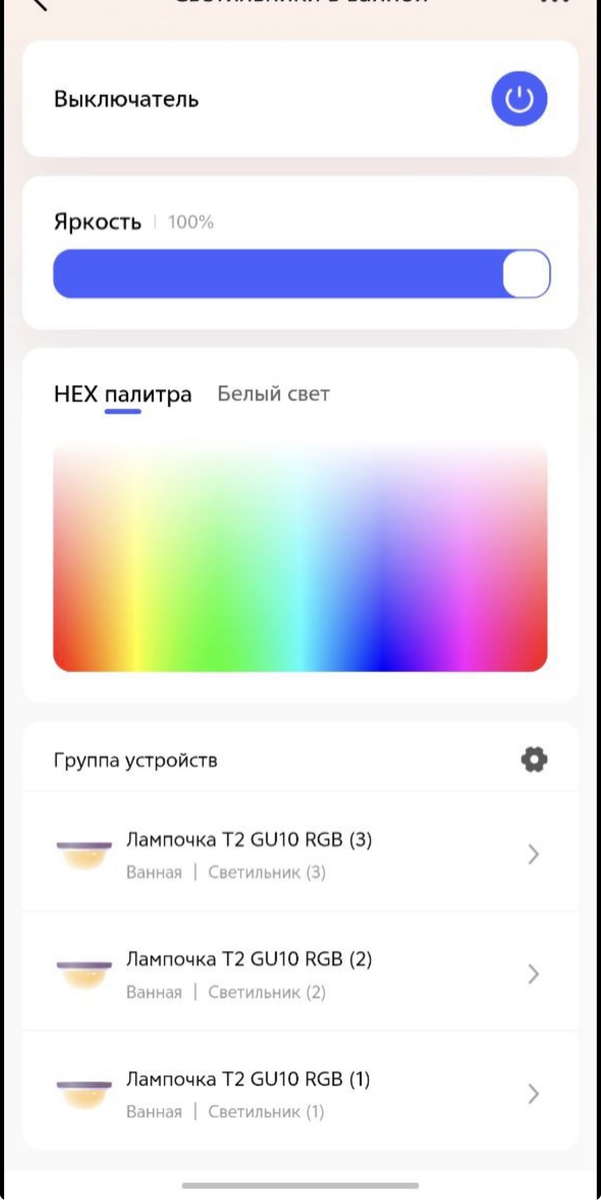

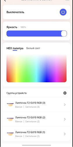

In Zigbee mode, the bulbs added to the group allow you to select a color and control the color palette, that’s for sure.
Hello, @PaulBe
Both Zigbee and Thread protocols support light group control. If you are using Aqara Home, it is recommended to use the Zigbee protocol to access more software features.
