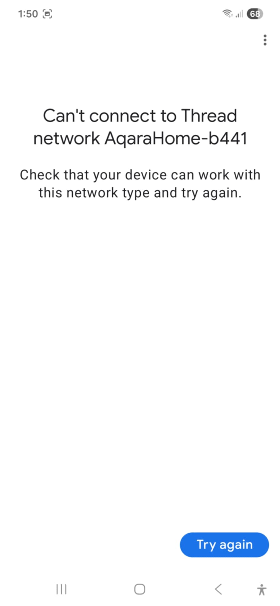

I have been trying to get an M11 setup to work with my Home Assisstant setup (HA green) to connect Matter devices.
I have followed all the instructions I can find, but I am yet to get anything to sucessfully connect.
It seems to start talking to the device but then gives up. In this case it was an Ikea Bilresa remote.
Any ideas what might be going wrong?

My understanding was that a ‘Thread Border Router’ is required. And the M100 is suitable for this task?
There seem to be some issues with the IKEA Bilresa. There are already quite a few forum posts about it:
Have you already completed the following steps?
  • Installed the Home Assistant and Aqara Home apps on your smartphone
  • Installed the Matter Server app (formerly known as the Add-on) in Home Assistant
  • Is the Aqara M100 Hub set up in the Aqara Home app using the same smartphone and the same Google account?
  • The Home Assistant and Aqara Home apps have all necessary permissions (Bluetooth, Location, and “Devices nearby”) enabled on your phone?
  • Are you starting the pairing process inside the Aqara Home app or Home Assistant app on you Smartphone?
  • In Home Assistant, go to Settings → Thread. Does the network “AqaraHome-b441” appear there? If it’s not listed, HA doesn’t have the “keys” to the network yet.
