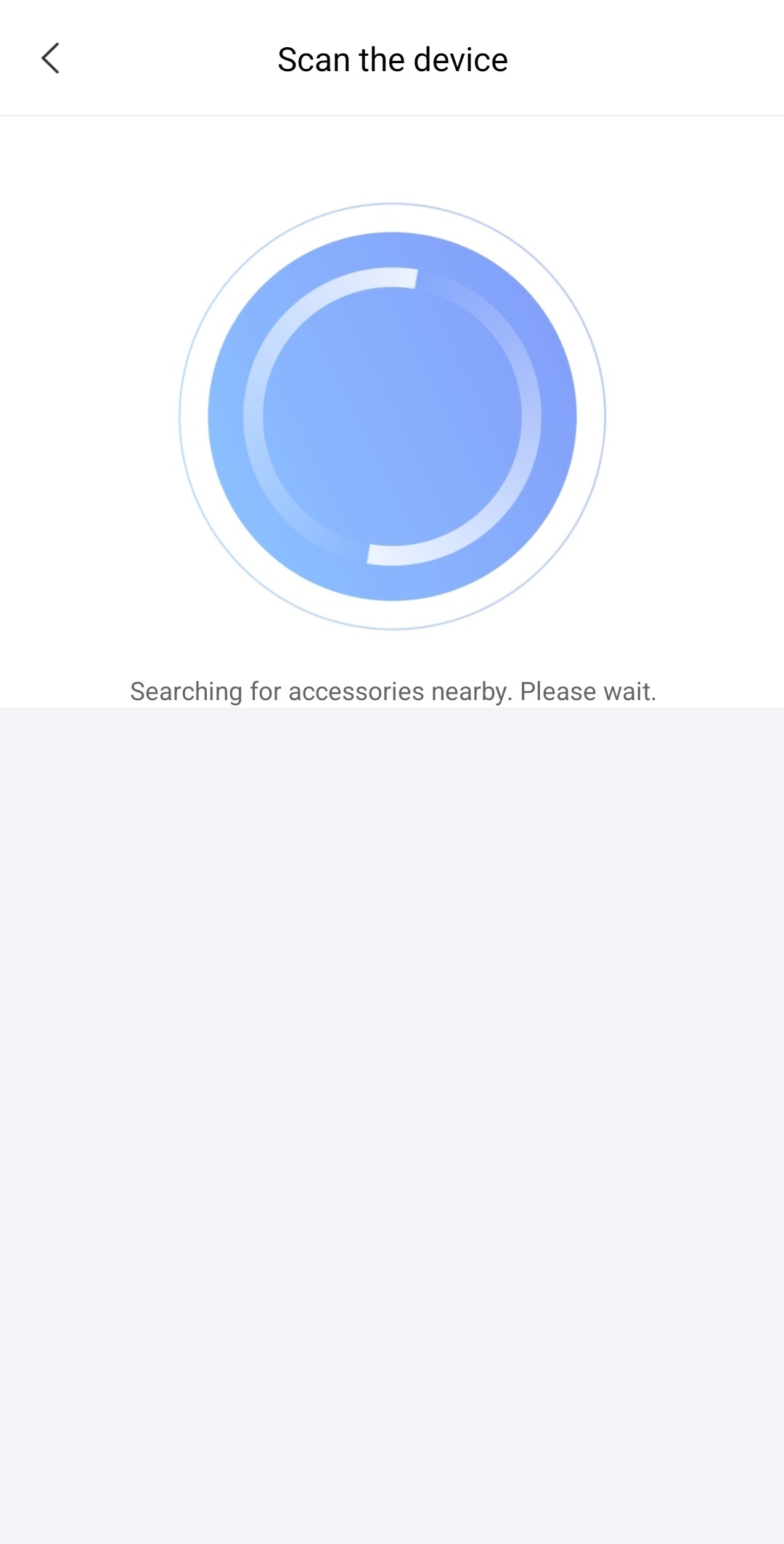

I’ve had an M1S Gen2 for a year now, working fine. Had to restart our router yesterday and afterwards the hub wasn’t connecting - I found it with a white static LED where normally I have the LED off. Tried a soft reset with 10sec hold, it went into pairing mode flashing yellow but my phone couldn’t see it while trying to add it back. Removed hub from the app, tried soft reset again, nothing. Bit the bullet and tried a factory reset with 10 quick presses, same result. Set my access point to 2.4ghz, no bueno. Made a 2.4ghz hotspot with another phone, nothing. The device says “ready to connect, please open the aqara home app” on startup, then flashes yellow, but my phone can’t see it - eventually after a few minutes it gives up and the LED stays static white. I’m in touch with aqara support but I thought I’d write here as well, since I’d really like to get this up and running asap. Anything else I could try?
