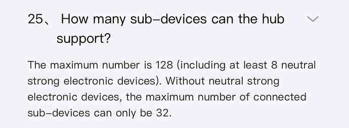

Good evening. In my opinion, you have too many devices for one hub, although m2 supports up to 128 devices but only with repeaters. Do you have repeater devices that operate from a 220v network?
@goson 1. Recommendation on Zigbee Router Device Count:
Ensure that the number of Zigbee Router devices (typically, AC-powered Zigbee devices excluding Single-wire Live versions) added under this Hub exceeds 15, enabling the hub to support connections with over 80 sub-devices.

I have a total of 30 220-volt plugs.
They’re all over the house.

I have seen such situations with users and as soon as they divided such a number of devices into 2 hubs, the situation improved.
