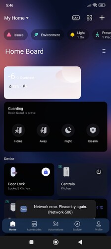

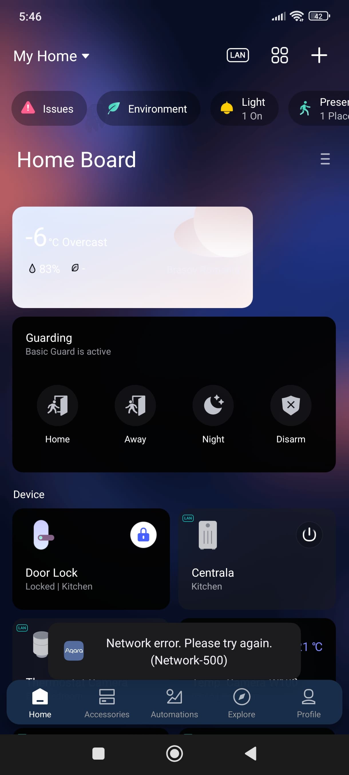

Hello, I also have a problem opening the application. I get the message “network error. Please try again (network - 500)”
@avram_bv You seem to be experiencing an issue with a network error (network - 500) when opening the Aqara Home app. You can contact customer support for assistance. Contact the Aqara Home App Customer Service Team (Profile> Help & Feedback > Customer Service) or scan the QR code:

@avram_bv It looks like you don’t have weather information.
Did you already check the System Permission setting?
Profile - Settings - System Permission
