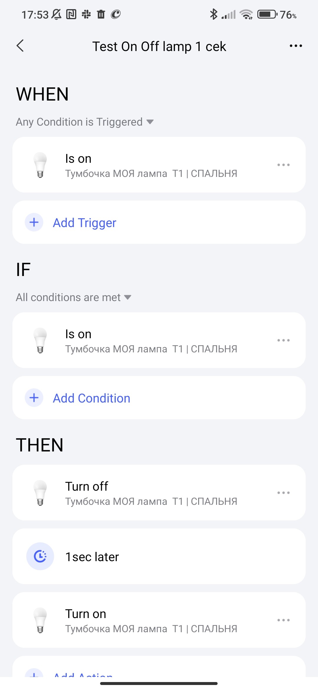

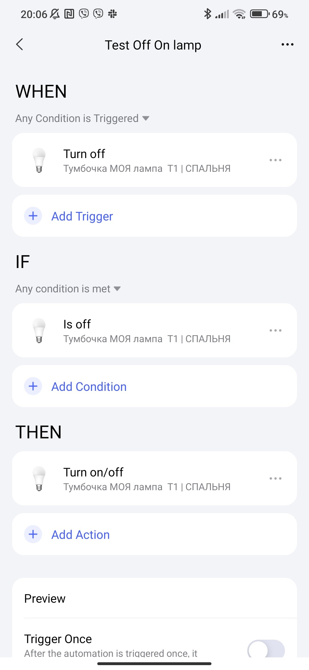

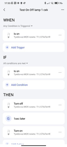

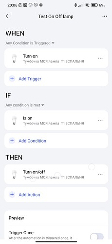

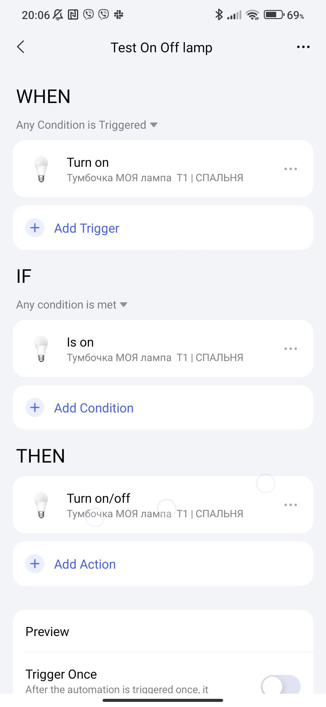

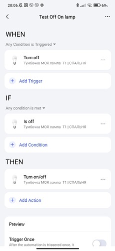

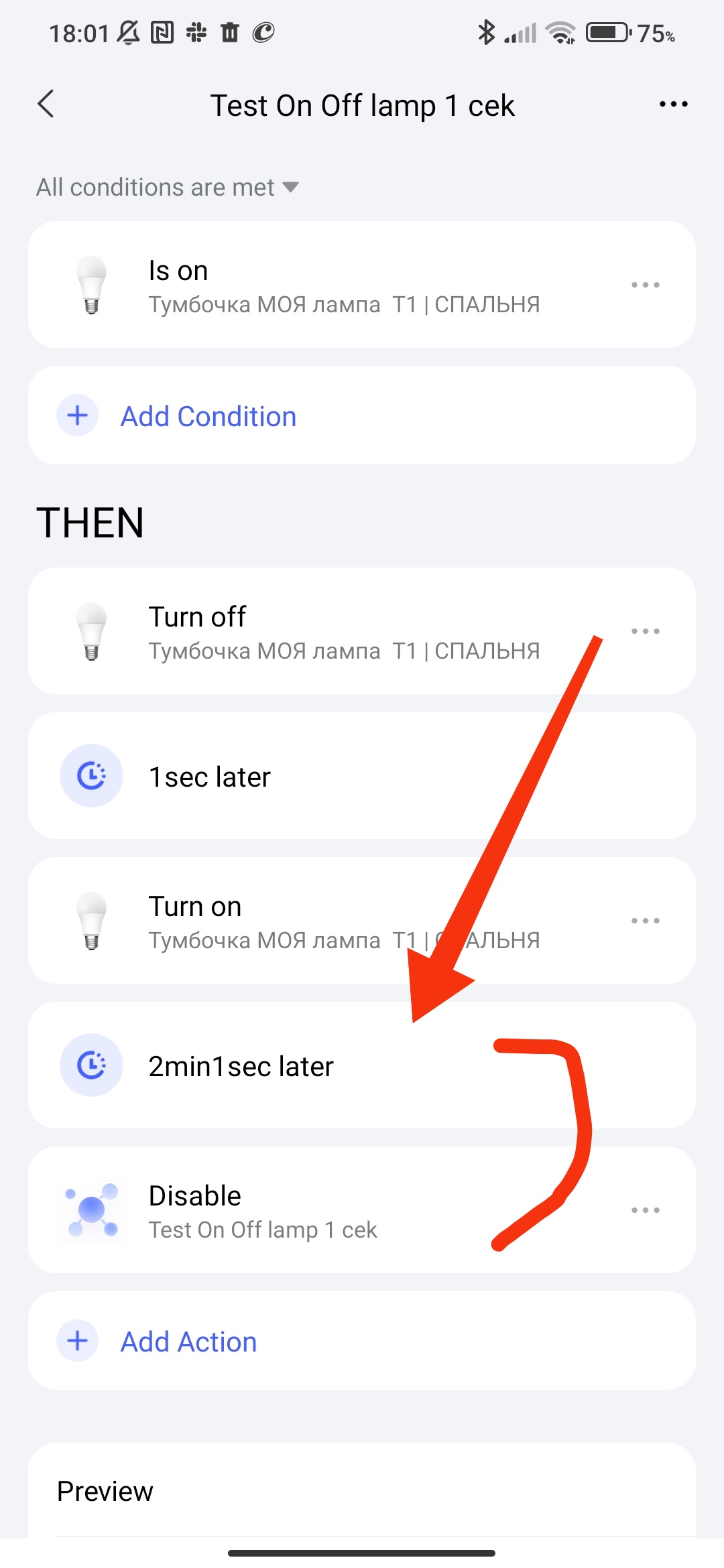

Hello, here you have at your disposal the automation of a blinking lamp with an interval of 1 second. If necessary, you can change the interval. If you want to disable the blinking, set an additional interval and turn off this automation.

If you want instant switching, make two automations, then it will be On Off On Off… very fast. Stop blinking only after stopping the automation.

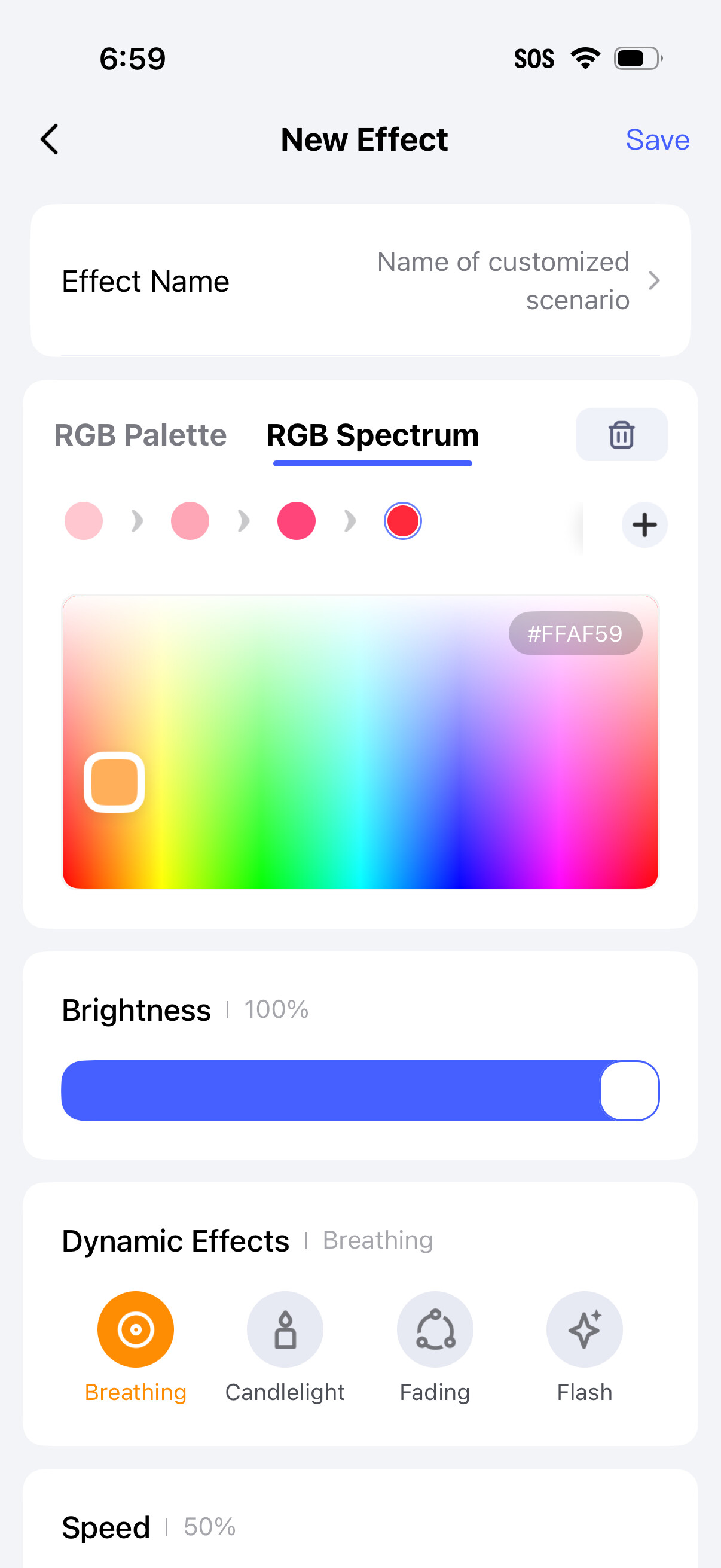

The easiest way for me would be to just create a new RGB Dynamic Effect. You can fully customize the colors, brightness, and transition speed right in the Aqara app. It gives you way more control than trying to tweak the preset effects.
After you can activate this effect from an Aqara automatisation.

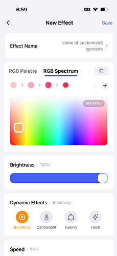

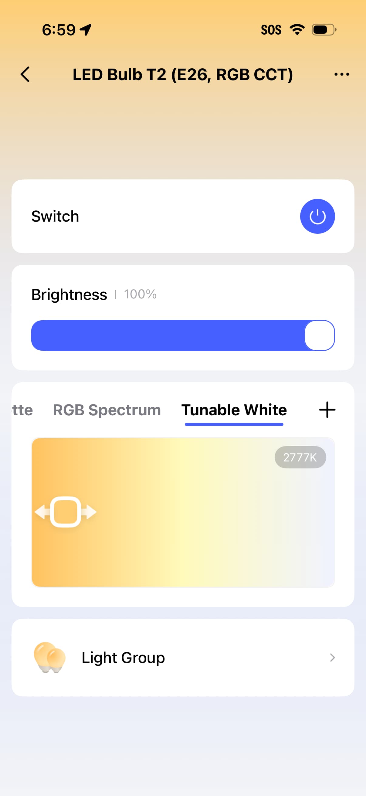

I can’t see anywhere that I can create dynamic effects my E27 - ONLY on my lightstrip.

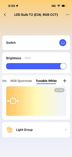

I do it with the T2 light bulb. Go to the details screen of the bulb. Hit the + button and select White or RGB Dynamic Effects. Create the effect you want and save it. Then create a new scene using the effect I just created. After that I use the Scene Sync to make the effect available in Home Assistant and HomeKit.
Hi 0087. Strange, I don’t have that option with dynamic effect. Could it be because it is connected via Mater and not Zigbee?

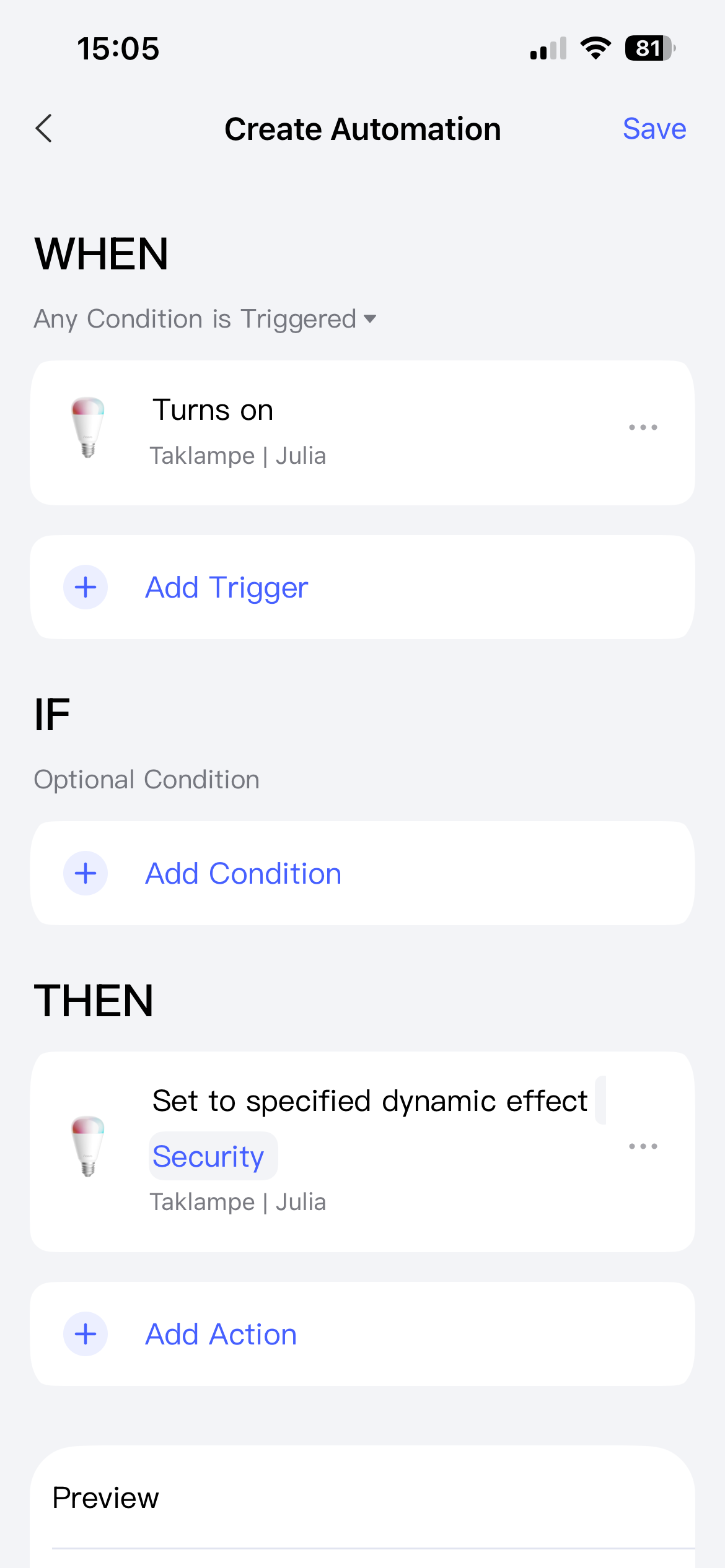

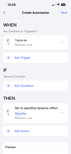

You can use the dynamic effect - Security - then the light flashes red.
I can’t say for sure. I do have mine connected via Zigbee to the M3 Hub and then the M3 connected to HA and HomeKit via Matter. Hope that helps.

THEN I got the dynamic effect to work and all the suggestions you made. It was simply because the bulb was set up as Matter it not Will work and so I just missed that function - now it’s connected through Zigbee. Thank you all for your input!! :pray:t2:
