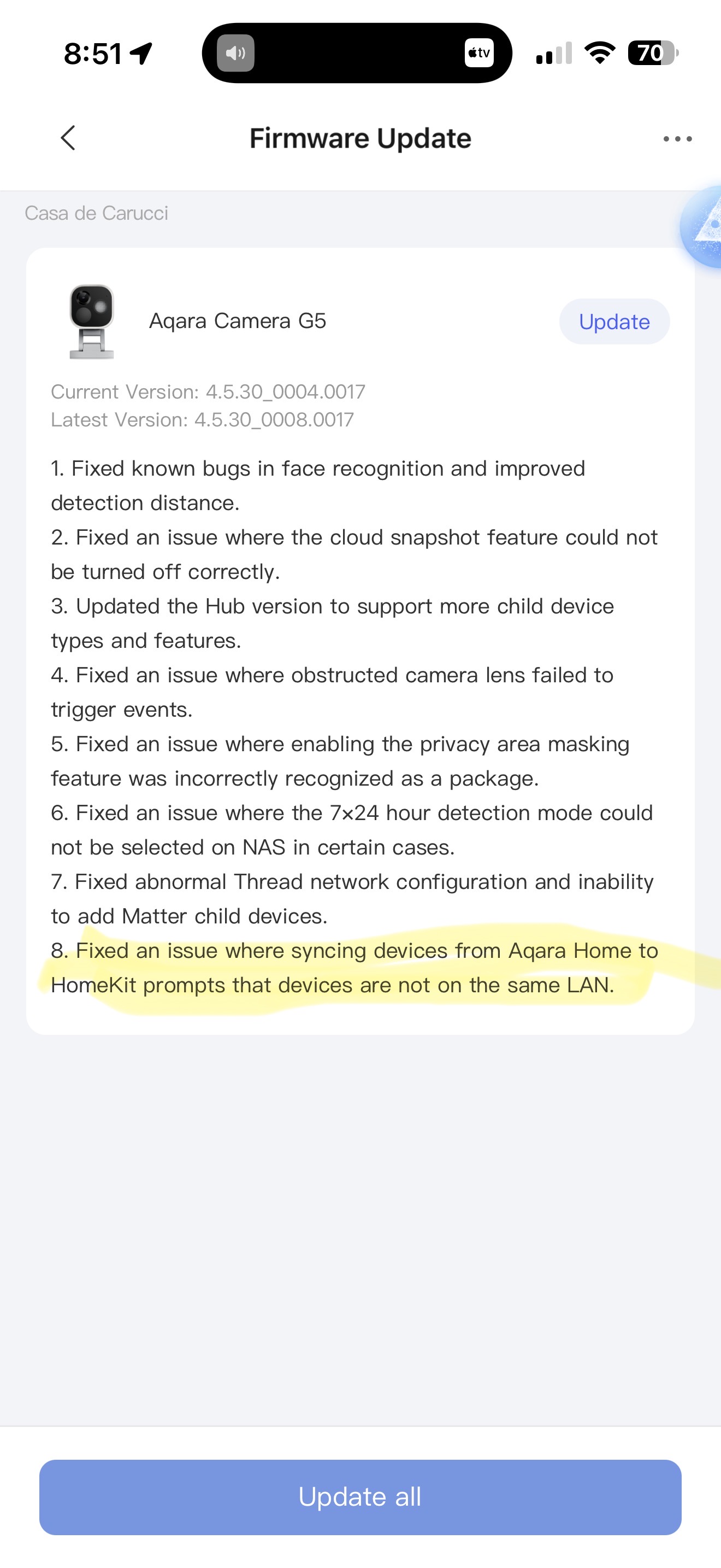

This has to be some type of bug or firmware update that needs patched. I’ve seen multiple users experiencing the same issue and of course just decided to reset all my cameras to clean up my smart home network this weekend, so am stuck with the same “Connect your phone and device to the same LAN and try again”.
Any Aqara support staff able to chime in?
Lets goooooo, this fixed it!
