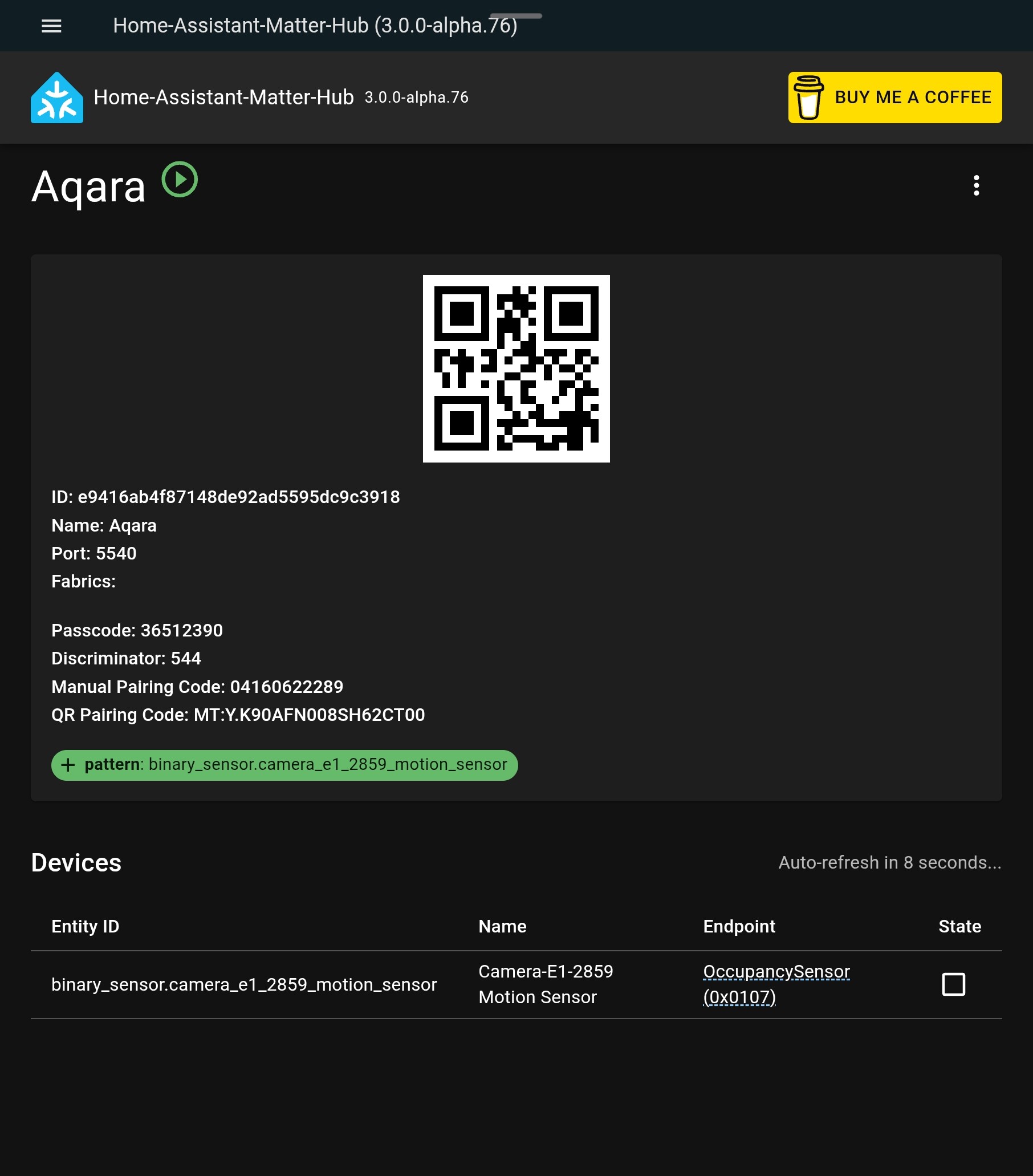

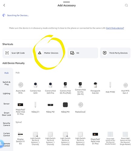

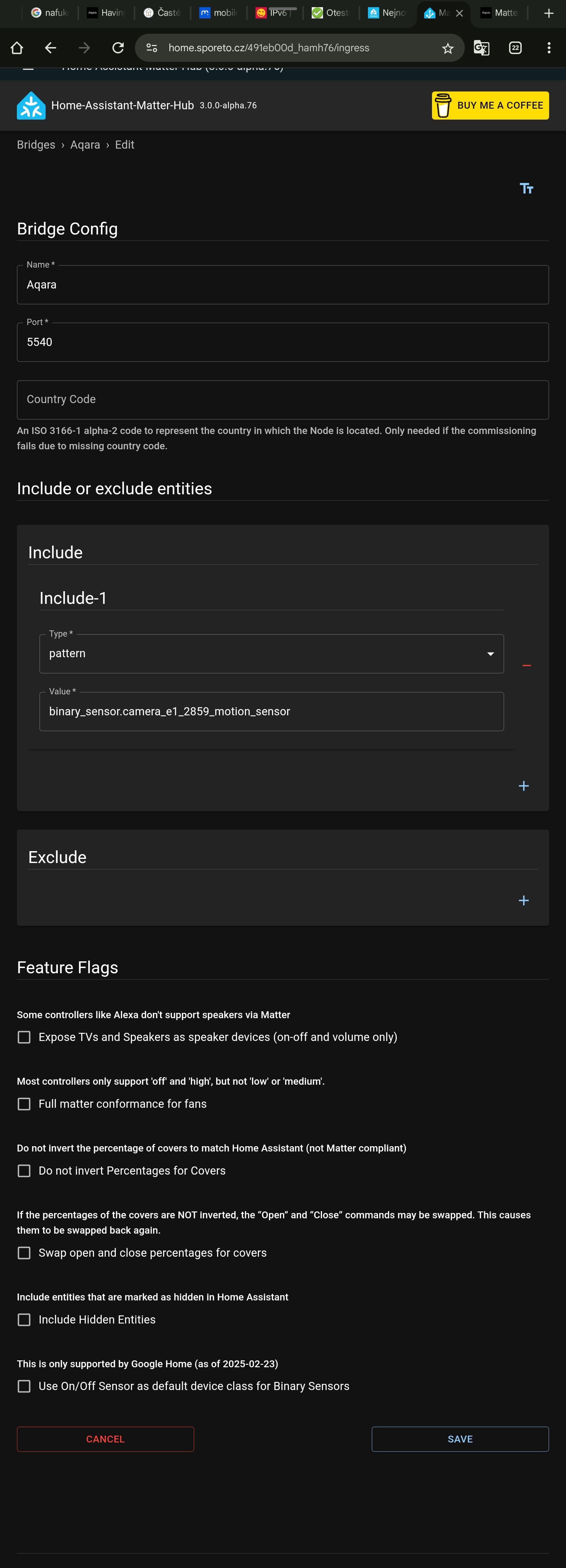

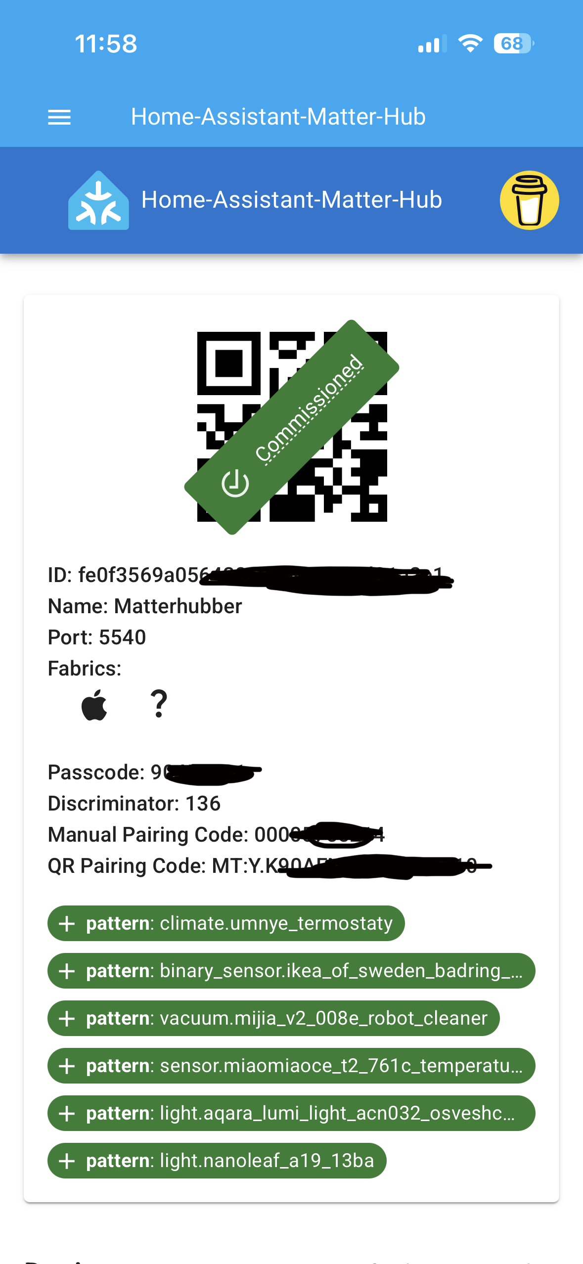

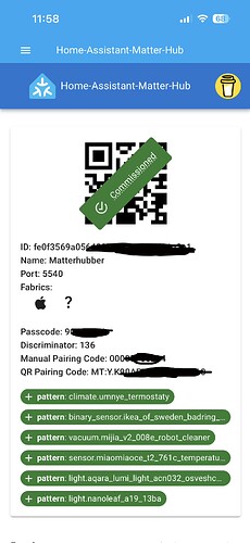

This is my home assistant setup and addition in the Aqara application. What port do you have communication set up in HA?[grid]
[/grid]

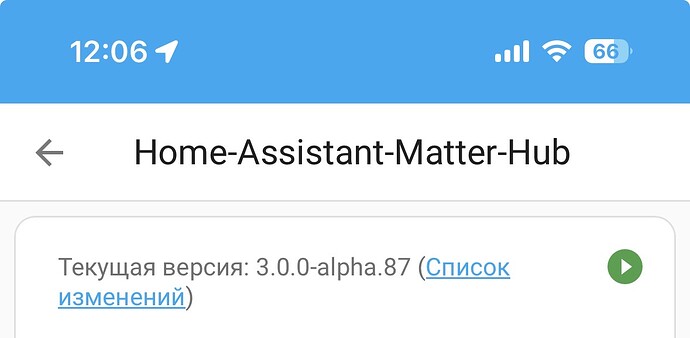

Please update matterhub to the latest version.
Matterhub does not support all types of devices unfortunately.
I see that you have version v76 and the current one is v87
thank you, updating to the latest version helped :slightly_smiling_face:
