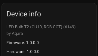

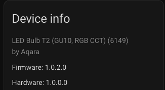

Hi, I bought some new T2 GU10 bulbs and installed them. Now I have 2 different firmware versions for that device type:
What can I do update my bulbs to the latest firmware, when I do not have an Aqara Hub, besides resetting them to factory defaults and switching the firmware from Thread to Zigbee and back to Thread?
Thanks Hoppel
